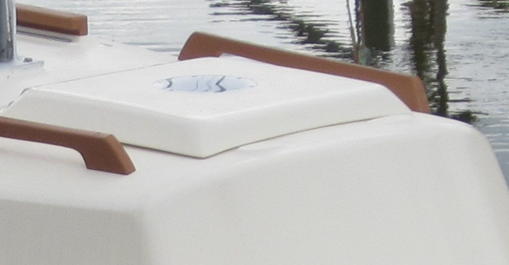

It was raining too hard to even think about taking the rails off today so, in the few moments I did have I took a picture...not as bad as I remembered! I think they clean up nicely!
