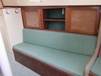

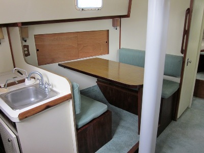

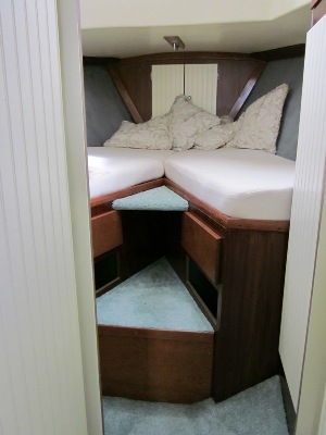

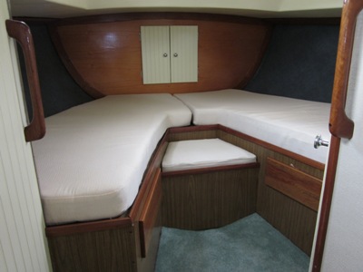

My formica looked like that on the GS 41 I had. Not liking the all painted look (to me like the inside of a refridgerator) I spruced up the "lower furniture" with Min Wax satin finish polyurethane. In the aft cabin I used clear and didn't likt it so much so swapped for stain polyurethane in (IIRC) cherry.
The trick with the stain poly is to stay with the grain, make one pass from bottom to top on verticle surfaces and don't build it up to a solid color.
I painted the higher furniture and bulkheads with an off white acrylic after filling a million screw holes with wood putty and priming.
Oct 26, 2005
2,057
- - Satellite Beach, FL.
Forgot that the aft cabin aft bulkhead, I covered with door skin and urethaned with clear satin.
