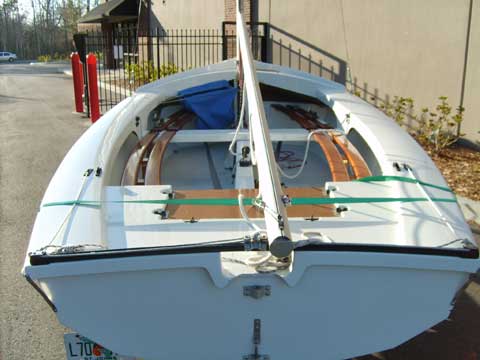

Seats I have seen on Wayfarers (and my GP14) are solid mahogany slats. You can see that very nicely on this pic of a Wayfarer:

Thanks for the advice on the plywood. I will laminate some boards and make it out of solid wood. Mahogany for the seats sounds good, do you know if I could use that on the rudder below the water line as well?
