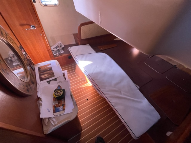

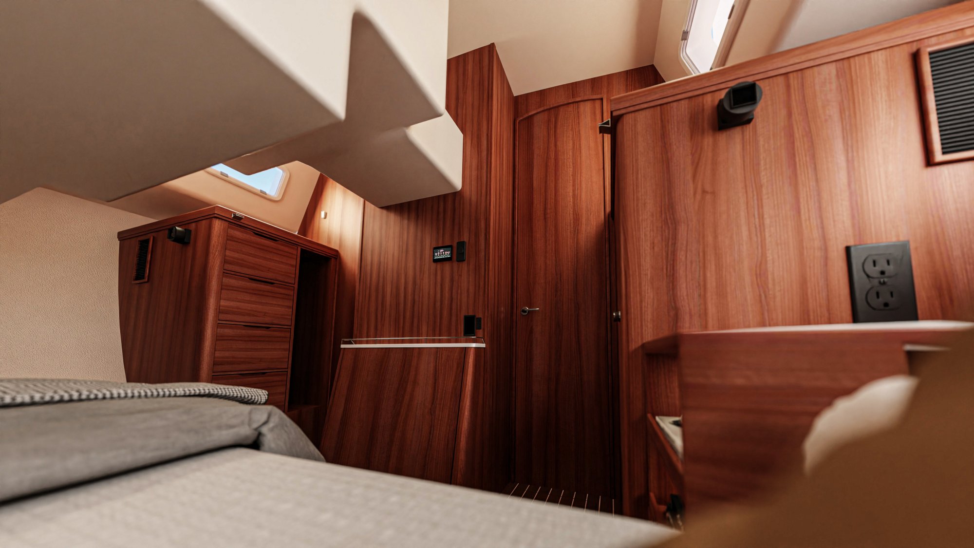

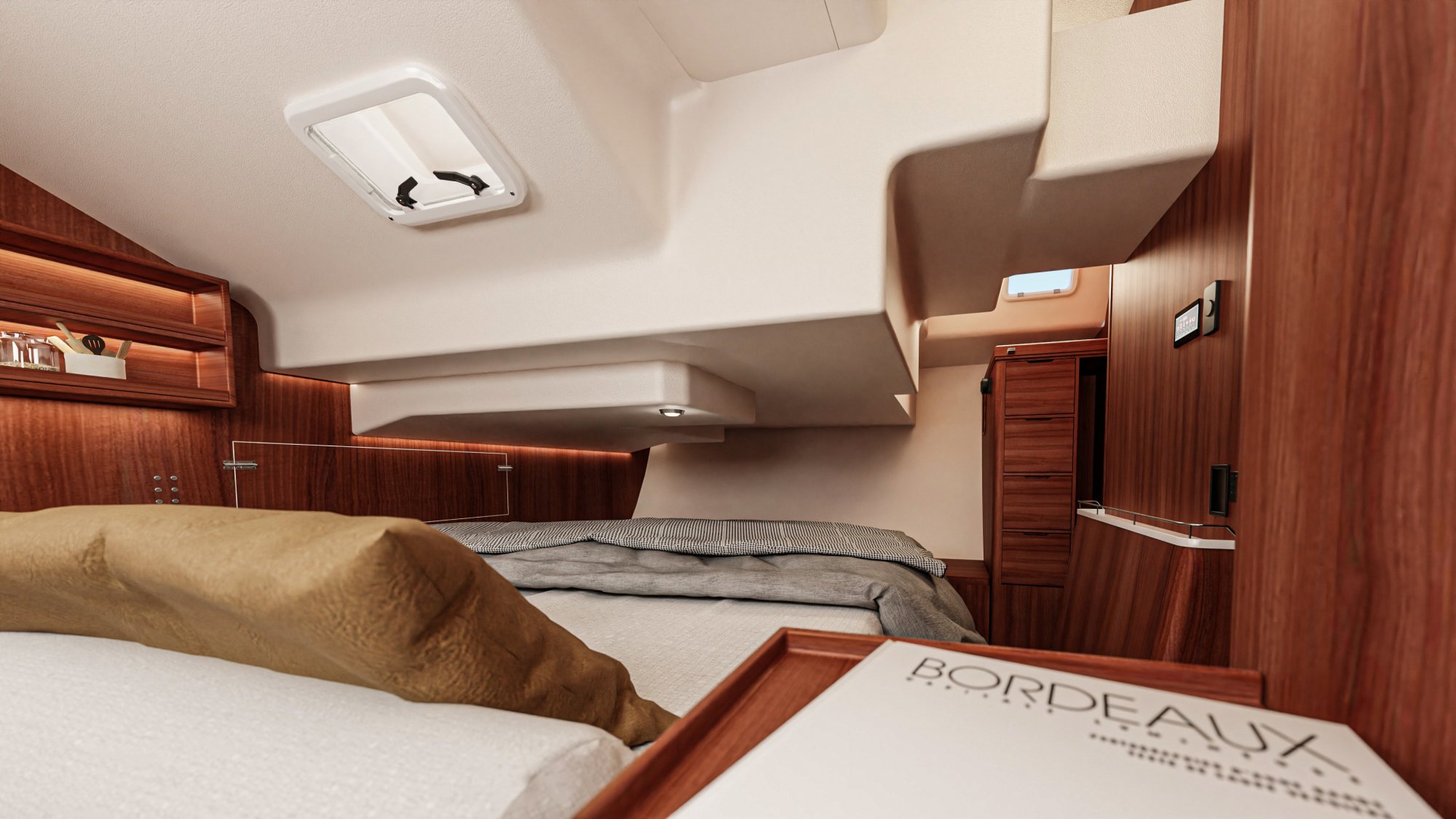

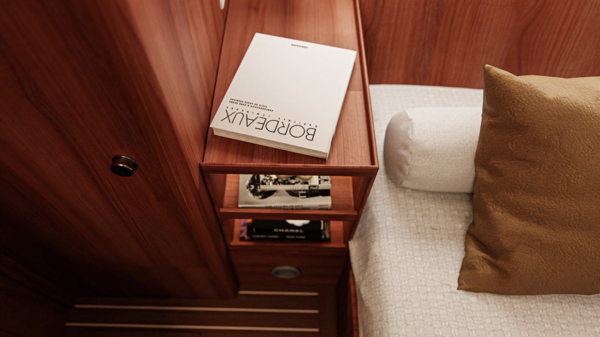

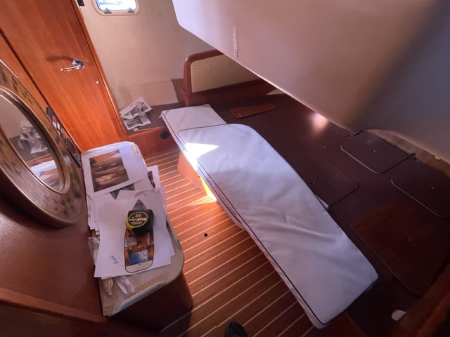

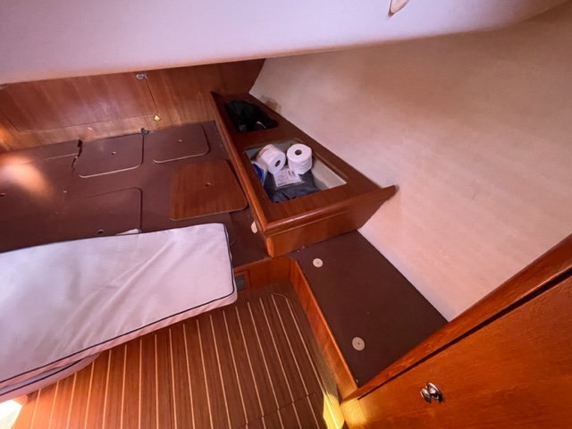

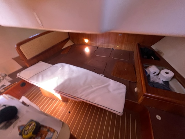

I am planning this April to remove the headboard and two seats in our 2006 Hunter 38 and extend the bed area to the starboard wall, and add a side table where the starboard chair is. This is a design to allow for a larger bed, and also make better use of the higher headroom that exists starboard. The new bed will be an unusual size - 71" wide and 85" on one side and 75" on other. This design basically copies what Hunter did with the aft cabin in the very similar later Hunter Marlow 37 aft cabins. I plan to order a custom mattress to fit the new space, and make a headboard, side table, shelf on wall, and new smaller engine cover (to allow space to still walk to head).
I used Fiveer to find a great company ( called "Veal") based in Indonesia, who did very nice 3D plans and renders based on my plans and measurements. I attach these here for anyone interested or anyone who has any advice!

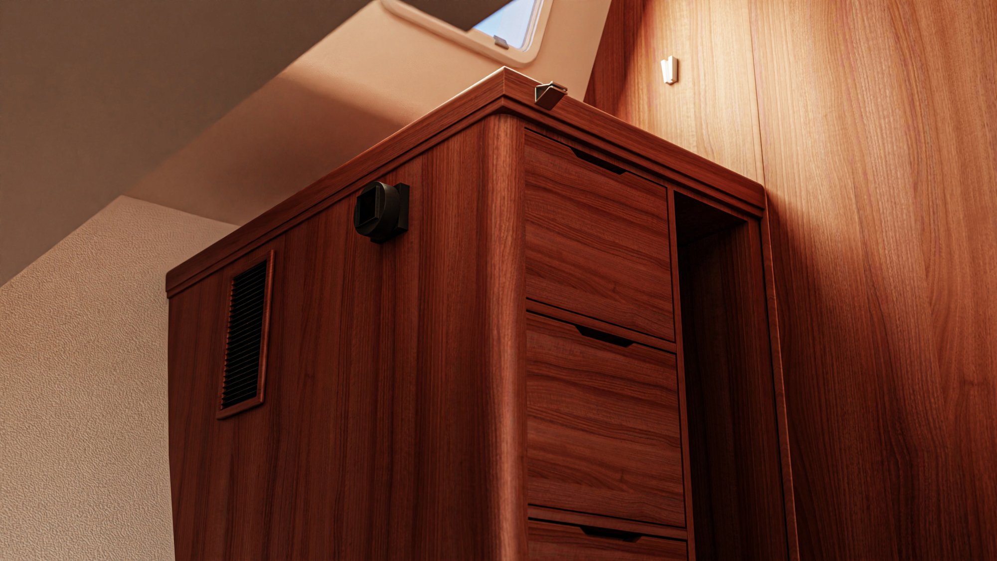

I wanted to add here the images of the 3D renders of the new space as we hope it will be and the wood pieces I need to make, stain and cut..

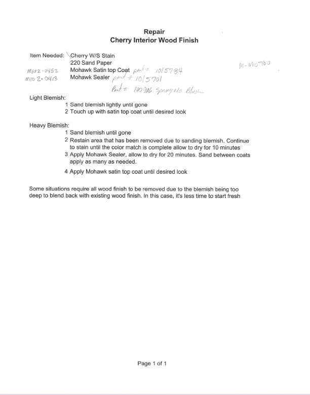

The finish was sprayed on at the factory. I attached a description for repairing damage to interior finish and a products list from Hunter. It should work for finishing raw wood as well. The key is the sanding sealer to lock the oils into the wood before applying the finish. The Mohawk products are still available and you can buy quantities for spraying.
Good luck with your project

I believe the cherry stain is Minwax Cherry 235. At least that is what the dealer used for touchups on my boat when new. I have used this procedure (Repair Cherry Interior Wood Finish) in several areas of the boat since and the match is great. The nice folks in the Sail Boat Owners store maybe able to help.

This is AMAZING!!! Yes, this is 100% what I needed. Perfect! I will follow this plan - thanks to all the kind people who have posted here and shared these tips! I will post photos of the job when done. tks!
