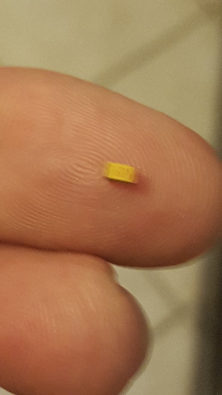

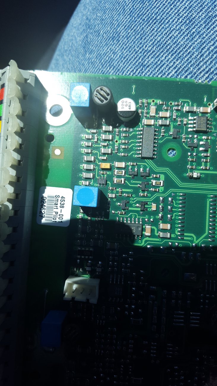

Mine acted like that on a unit I bought on ebay. It was supposed to be good working unit, right! I knew there was TSB on the Raymarine website that covered this issue. Some of the units had a very small surface mount capacitor installed backwards. Mine was one of the defective units. I can solder but I had never worked with surface mount components so I tried to find a shop to do the work, no luck. I did it myself and it has been working fine for about 3 years now.lots of phone pix 001.jpg lots of phone pix 002.jpg
Jul 23, 2009
926
I think it is tantalum.
The TSB said reinstall the original in the correct orientation, IIRC. I reused the original.
The hardest part was seeing the tiny thing. Turned on every light and had the wife shine a flashlight on it. Had to wear some reading glasses too. Three years later I need reading glasses just to type/read this.

Interesting, tantalums can explode if subjected to the wrong polarity DC.
