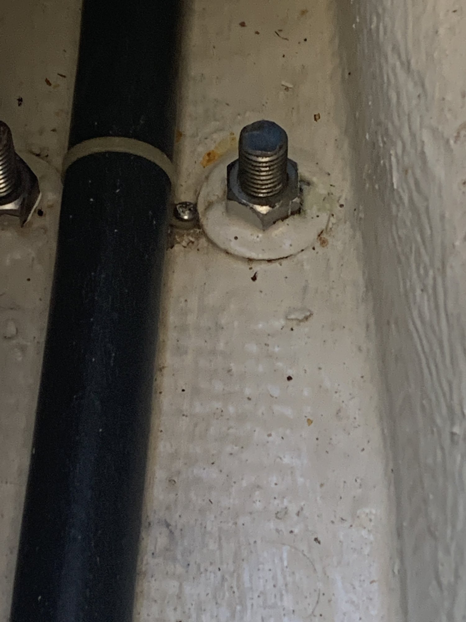

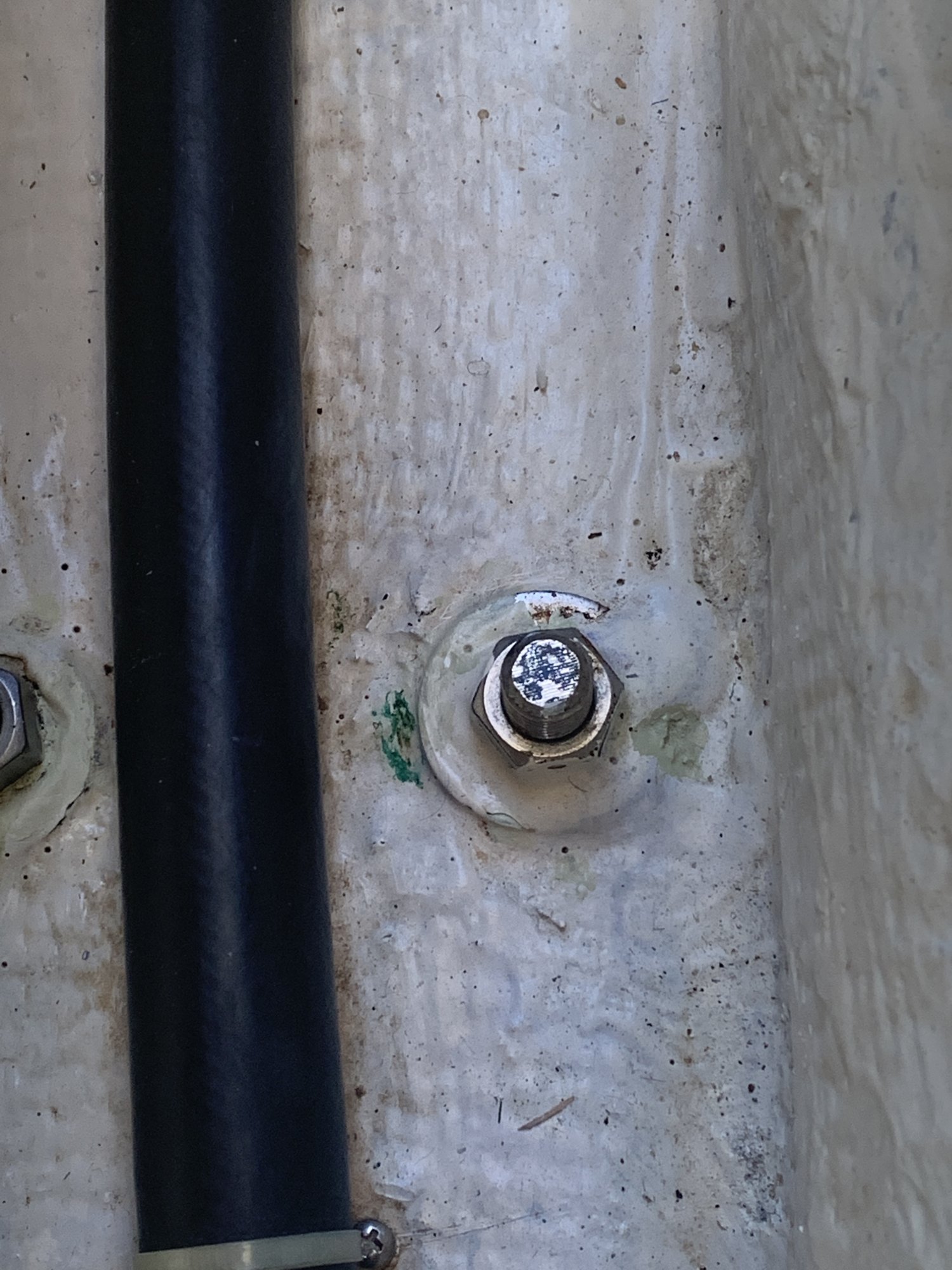

I'm looking at a '83 Catalina 25. The boat is in excellent condition. I was ready to close the deal when the owner mentions that when he purchased the boat 10 years ago, he noticed that the fixed keel wobbled when the boat was hauled out. He said he spoke with a surveyer and called Catalina and they told him that it was normal. Every google search I've made shows discussions indicating that a wobbly keel indicates an imminent catastrophic failure. I'm really confused about what to do. He has other full price offers so I will not be able to haul the boat out before committing to a purchase. the bilge is perfectly dry and clean and the keel boats are shiny with zero corrosion. The boat has been hauled out a few times over the years for bottom work and painting and no one has raised the issue. Here are some keel bolt/ bilge pics

Without hauling the boat, inspecting the keel, and checking the bolt torque, there is no way to tell how serious an issue this is. If the owner has other offers, I'd let the other folks deal with the problem.
Keep looking, I'm sure you can find a boat with less questionable issues.

Agree with dlochner, wobbling keel is bad and is not normal. The keel bolts look good but they also appear to have never been torqued since it was built (the original gel coat is still on them). The fix could be as easy as re-torquing the bolts but without getting a good look at the keel out of the water, you're taking a chance that it would require more extensive/expensive work. Let someone else take the chance.
