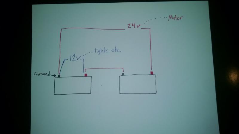

There is one solution by utilizing just a single battery for the 12V circuits and then connecting on the two batteries in series for a separate 24V circuit. Connect the batteries as follow;
Positive (+) of battery#1 to negative (-) of battery #2
Connect 12V circuit (+) lead to positive of battery #1 and Negative lead of 12V circuit to (-) terminal of same battery #1
Then connect the 24V circuit positive lead (+) to positive of battery #1 and the negative lead to negative of battery #2.
The end result is that you will have two separate circuits; one will be your existing to handle all the 12V instruments and fixtures from battery #1 and a second separate circuit dedicated to the motor using both battery 1 and 2 in series for 24 V. You must understand that your house 12V circuit will now only have half of the storage capacity it had previously plus will be asked to provide additional power to combine with battery #2 to supply the 24V power to the motor. You will have to perform an energy budget on how long you will have to run the motor and for how long you would need to run lights and electronics. If you wanted to retain your original storage capacity you could add a third battery #3 connected in parallel with battery #1.

Although it would be possible to connect the batteries in series to make 24V for the motor and then tap off only one of the batteries for the 12V circuit it would cause unbalanced load on both batteries during use and recharge and cause early demise. ALNims suggestion looks best to me. A step down transformer not so much.
Feb 4, 2015
5
Capital Yachts Neptune 24 Marina del Rey
Lloyd- Probably not the best set up in terms of longevity, no. Thanks everyone!

Everything is a tradeoff, you get the dual availability of a 12V and a 24V circuits but will reduce the longevity of the dual circuit battery doing the heavy lifting. We were just discussing in another posting the fact that manufacturers do not know and cannot guarantee with any degree of certainty what the useful life will be for an individual battery. As long as the battery serving both circuits is not deeply discharged below 50% of capacity and is charged back to 100% after every use I would say that its chances of providing a long useful life could be as good as any.

For casual use you might get away with tapping 12 volts off the 24 volt set. If your charger attaches to each individual battery, it should keep the charge balanced. I have done this in the past when the 12 volt loads were low.
But the trolling motor will at some point draw the 24 volt system down so low, none of the 12 volt devices will get enough energy to function.
I have a separate 12 volt true deep-cycle battery sized for the electronics in addition to the set of four GC2 batteries providing 24 volts to a Torqeedo Cruise 2.0 electric outboard.
Since the boat is on a mooring, all batteries are recharged using solar panels. I go out once or twice a week and this works for me.
