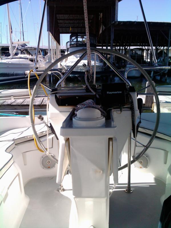

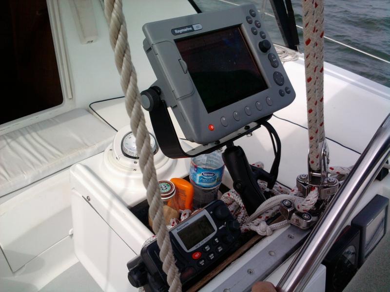

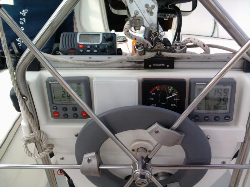

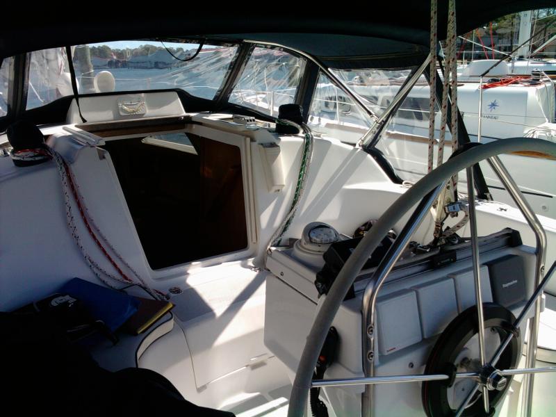

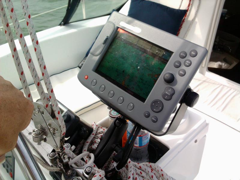

Here are some pic's of mine, not very good ones but you can get the idea. I have a Raymarine C80 chartplotter not shown but you can see the mount. I have since added a swing arm under it to raise it up. But you can get an idea of how my gauges are mounted.

I'll take some more with everything hooked up with closer pic's.
