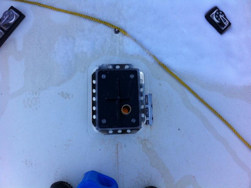

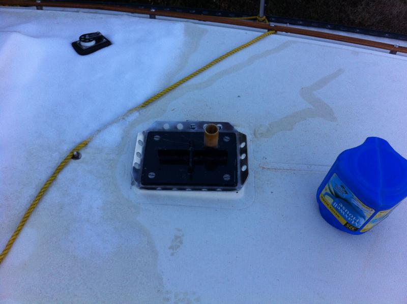

mine has a deck stepped mast s well ...my wires came out of the front of the mast..and went through the deck with a fitting that leaked ...so i didn't like that and when i made my tabernacle plate i drill a hole in the plate to except the fiberglass tube that i install with thickened epoxy...then set the tabernacle plate with butyl tape and then the mast plate on top of that ..also using butyl tape there ..then i bolted it all down to the deck with 3/8 flat head machine screws....i still have to seal up the holes in the deck and gel coat it over..see photos attached...

I like the arrangement that Woodster shows. It's within the perimeter of the mast and so somewhat out of the elements and not subject to being kicked by crew. The tube is nice to keep the wires out of pooling water.
I would make the wire down the mast too long so there can be a drip loop, and you'll extra for when a boatyard employee cuts the wires when unstepping the mast. Also you can put a terminal box on a bulkhead where the wires come thru the mast step or nearby. Then you can disconnect them before the mast is taken down, so that yard workers don't get a chance to cut the wires.
