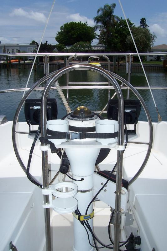

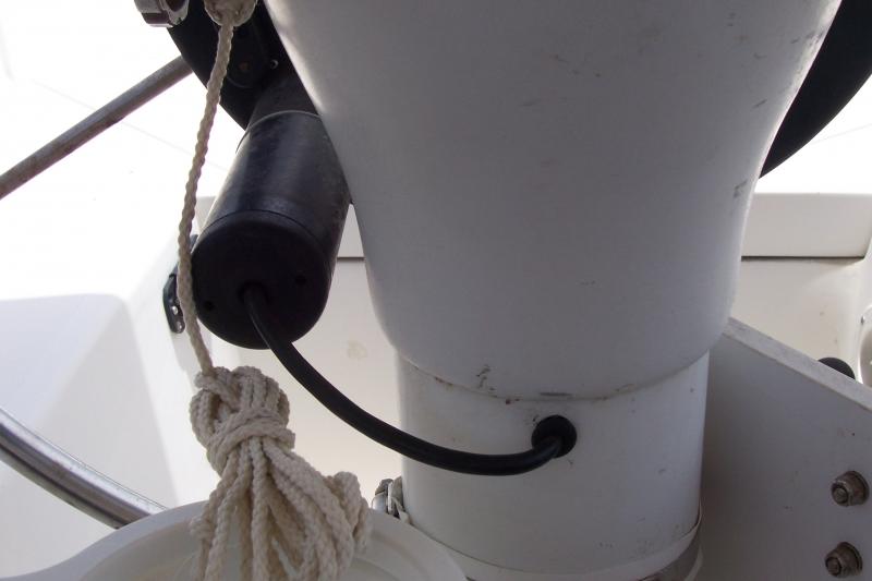

Take a look at the pics.
The first pic shows my instrument layout. Look on the bottom lower right showing the bulkhead connector I mounted for the controller. This is before I dressed the cables. All other instruments have bulkhead mount/pugs here also.
The second pic shows my GPS & Fishfinder layout for reference. I did fab the mounting plate for this.

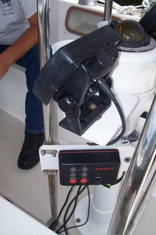

The third pic shows where I mounted the controller on a poly-vinyl fabricated piece I made & attached to the handrail of the binnacle. This was the "dry-fit" before I dressed the cables you see.

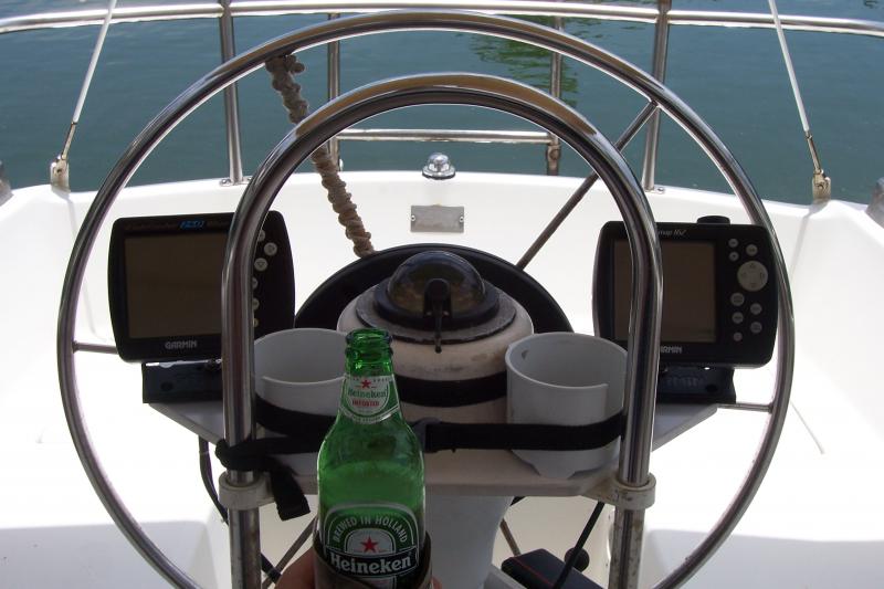

The fourth pic shows a top view of my swivel- ready GPS 7 fishfinder. This has allowed me to control steerage from both behind & in front of the wheel.
I NEVER leave my instruments onboard. Weather/UV/moisture & thieves can hurt you. So, I have all quick disconnects for taking my instruments home (fishfinder, GPS, controller). At home, I take the weather covers off & allow my instruments to dry. My autopilot has worked fine since 1993. My GPS & fishfinder swivel for easy view from behind the wheel & for turnable for full cockpit view.
I believe the whole autopilot install took 5 hours. I used bulkhead screw pin connectors for all. To wire your cable to the pin connector, refer to you electrical wiring schematic for color coded pin set. It was a fun project for me.
