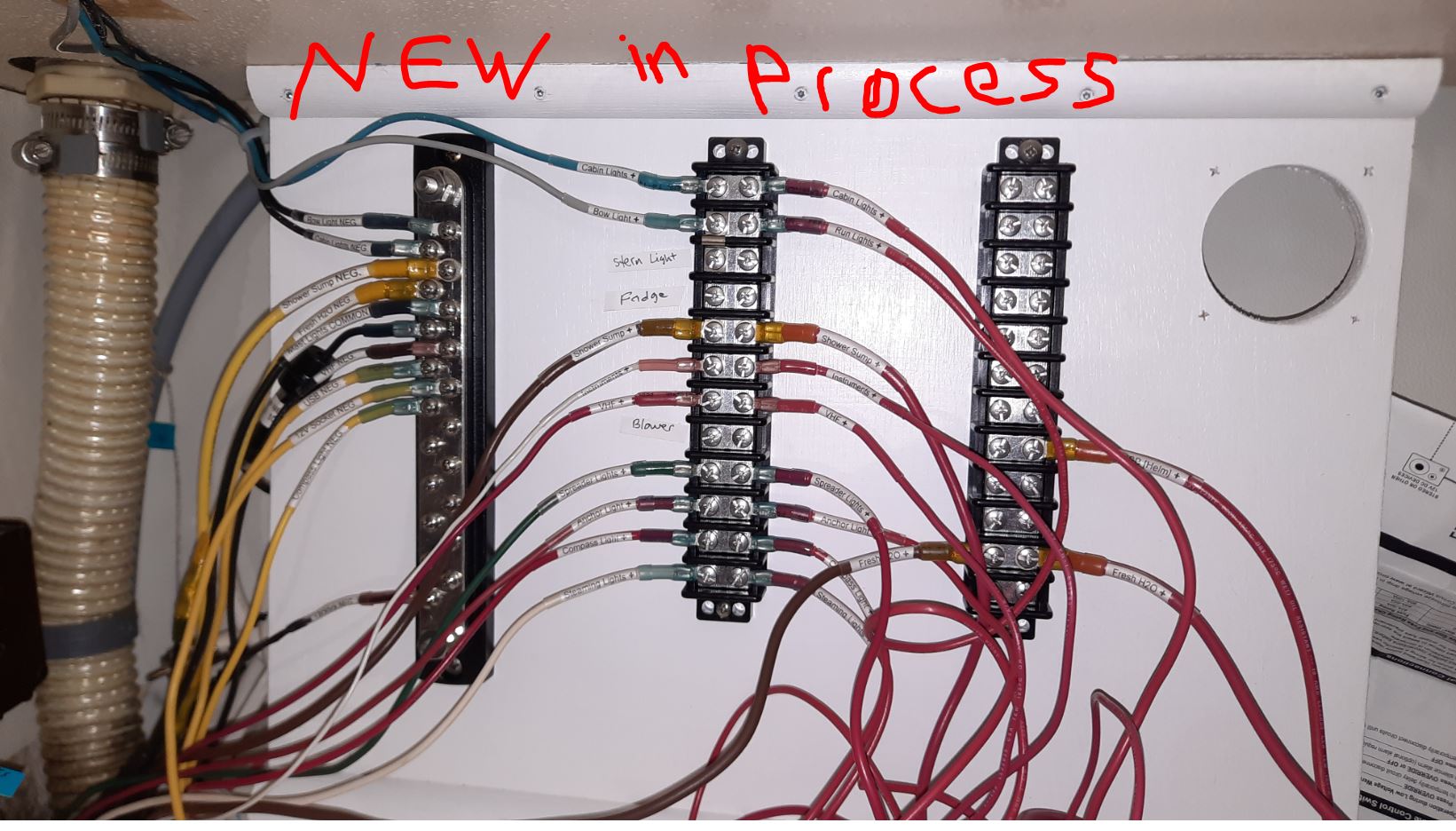

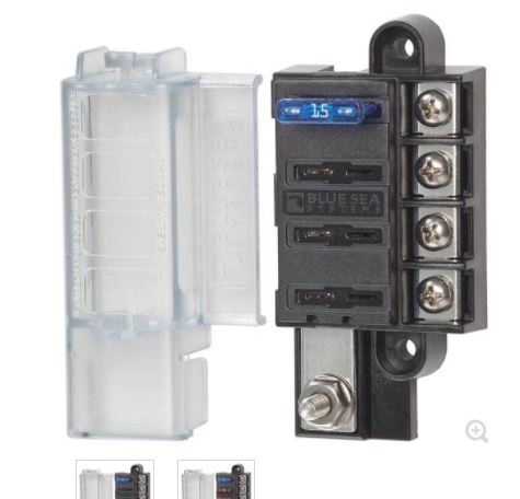

During electrical refit 1984 Morgan 323, there are obvious terminal points for most positive wires (e.g. running lights, fridge, bilge pumps) as most terminate behind panel, then to a breaker switch. But what about small positive wires like tank senders, Remote Battery switch and Automatic Charge Relay? Each has small, 2-amp-ish fuses, 18 or 16 gauge wires. Do these go to ST blade fuses on battery? To a busbar? To a common breaker at panel (I have one called "Instruments @ 10amp") using inline fuses? How to turn off these loads if they are attached to ST Blade fuse on battery post or running through a busbar?
