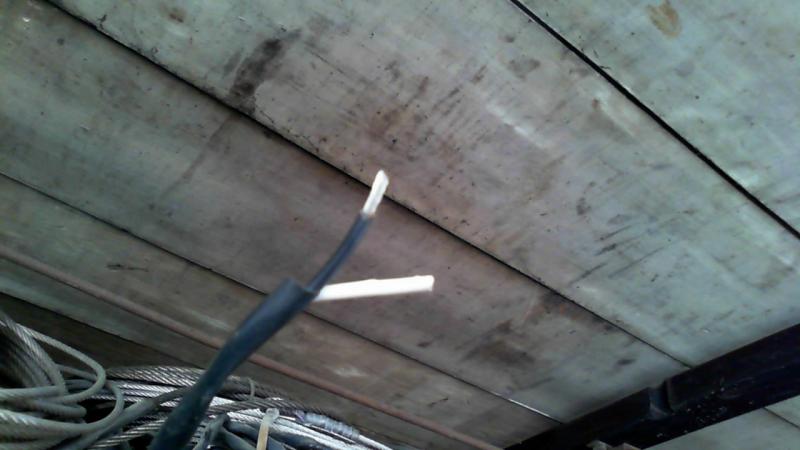

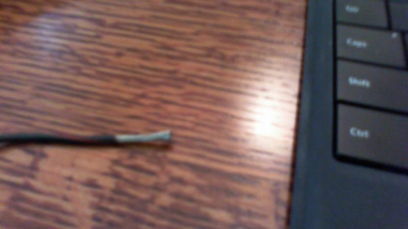

I went out and checked and the two wire cable I have is 12/2 and is black and white. I also found a spool of red striped black 14 gauge I have a couple of hundred feet of that.

Frank, you could get creative!
1. Use the white as DC hot and shrink wrap the ends of the white in red for (+) and the black is standard DC (-). You'll never see the white inside the sheath.
2. Make sure you label the heck out of everything you wire up, at BOTH ends. I've even been known to label wires mid-way along the run just for clarity.
