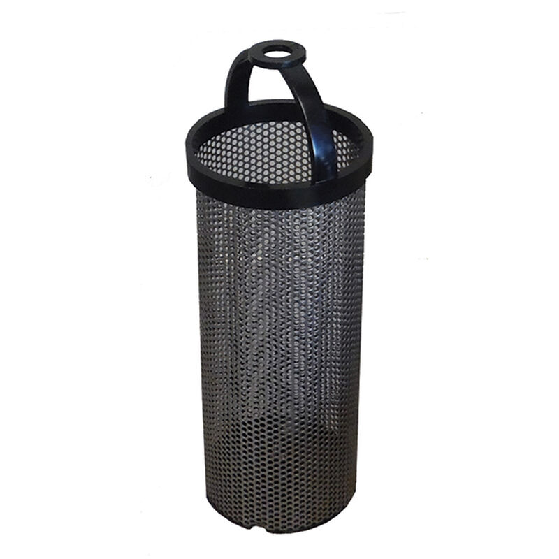

This may not be as helpful as you might like, but I use Groco strainers and they offer two types of baskets. One is stainless steel and the other is a poly basket. I use both interchangeably. Both are durable and the water flow is just fine. My aux and genset pump about 5 gallons per minute. Groco does not specify the size of the basket screen, but perhaps you can compare the attached pictures from Groco to what you have and make a decision.
Edited to add: I also use the same baskets on my A/C water input. If the "20" and "50" specify holes per inch, my baskets are probably closer to 20.

yes this is definitely larger ... i am guessing 20 also. curious, what is the length and diameter of the screen?
