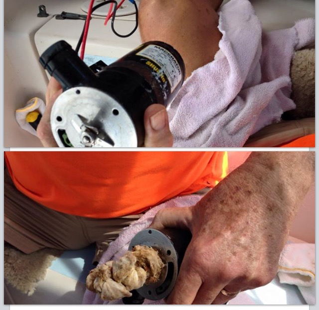

Wipes macerator

Thanks For The Reminder...
Remember about six months ago when we had a tread running about what to tell people or what list to use to orient guests aboard? Well, I'm going to add this!

I've been telling people for a couple of decades that marine sanitation equipment cannot chew up or otherwise digest wipes...that while they may be labelled "flushable," they shouldn't even go into toilets on land! And looking again at your photos, you were very lucky that the wipes even made it through the toilet and then all the way into the tank. I dunno how long they were in the tank, but your second photo makes it obvious they didn't even START to dissolve!
...saw on TV a while ago how those wipes are clogging up the whole sewer system in London..

No matter what the toilet mfr claims is ok, the ONLY things that should ever go down a marine toilet are whatever you've eaten and quick-dissolve TP. Flushing anything else is a crap shoot. (pun intended)...and the same should hold true in toilets on land.
If there was ever something for which the rule "you can never go too far wrong erring on the side of caution" applies, it's marine toilets!
