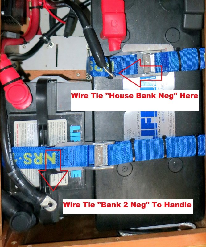

I prefer disconnecting the negatives because in the spring all negative cables go to the same spot so no mistakes can be made, especially in a poorly wired/labeled boat. Beyond that I wire tie the lugs next to their posts or leave an image for the owner in-case I am not there to reconnect.....

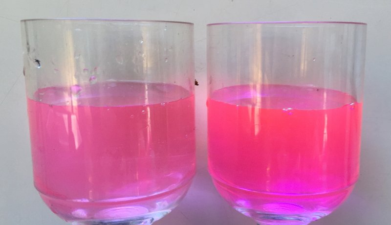

To make the case for others, here is the point about "seeing pink"...
These samples are from a Grand Banks trawler at 8 gallons sucked through the engines raw water system. To the naked eye you would be hard pressed to tell the difference between these two samples as they shot out the exhaust. "Seeing pink" is not a good measurement criteria for an adequately protected engine... Every spring I get to fix stuff that froze and was destroyed due to being under protected.
The sample on the left was taken at the end of gallon 8. The sample on the right is straight out of the bottle. Raw water pumps, strainers, oil coolers, gear coolers, heat exchangers, water lift mufflers and refrigeration coolers are expensive products and the labor even more.. Propylene glycol is cheap...
This was a Grand Banks trawler with a Ford Lehman. This was at 8 gallons.

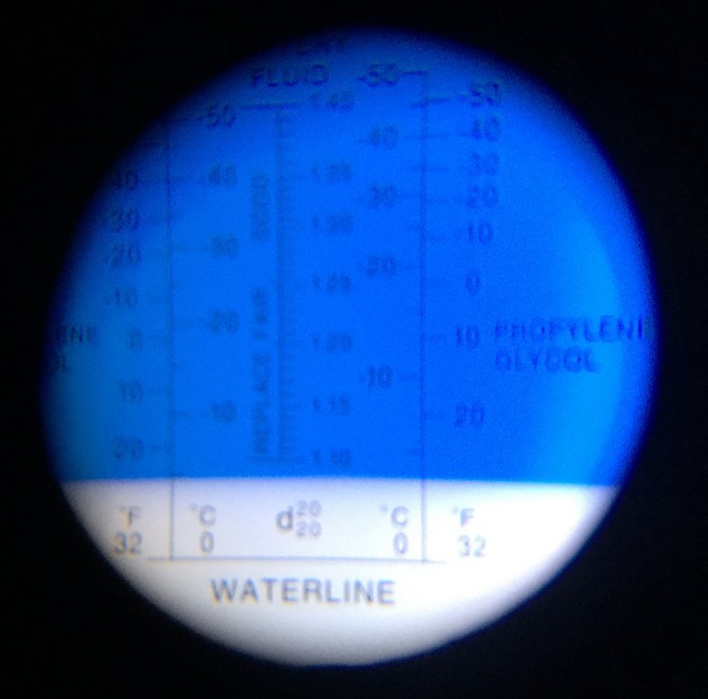

Sorry for the bad photo. Taking a picture through a refractometer is extremely difficult but it tells the rest of the story. I actually used my iPhone to snap this shot but it was still impossible to get a crisp photo. This was the best of about 30 shots of the same reading....
Out of the bottle this product measured about 4F on the refractometer. The goal is to match the bottles refractometer measurement/reading exactly with what is coming out the exhaust. PG will ice up/slush up well before it ever bursts. Most -50F rated PG products will turn to slush at around 0F to 10F. For proper burst protection it is critically important to NOT dilute it because the burst point raises rather dramatically when diluted more than what the bottle already is.
In this sample, taken at 8 gallons, the freeze/slush point is around 27F indicating a strongly diluted sample. It should read 4F just as it came out of the bottle.

Question - can a specific gravity refractometer be used for measuring concentration of the antifreeze? There are many available on-line; most are scaled for sugar or alcohol content or for salinity. But I imagine that if you can measure specific gravity and it is above 1.0, it should not matter.
They all measure specific gravity but have different scales. Mine has a scale for batteries and both eth and propyl antifreezes. I got it on ebay from Charlie Downs, nissales.com (I only know because he enclosed his card along with printed instructions I keep in the case). It was not expensive, I remember around $40.
