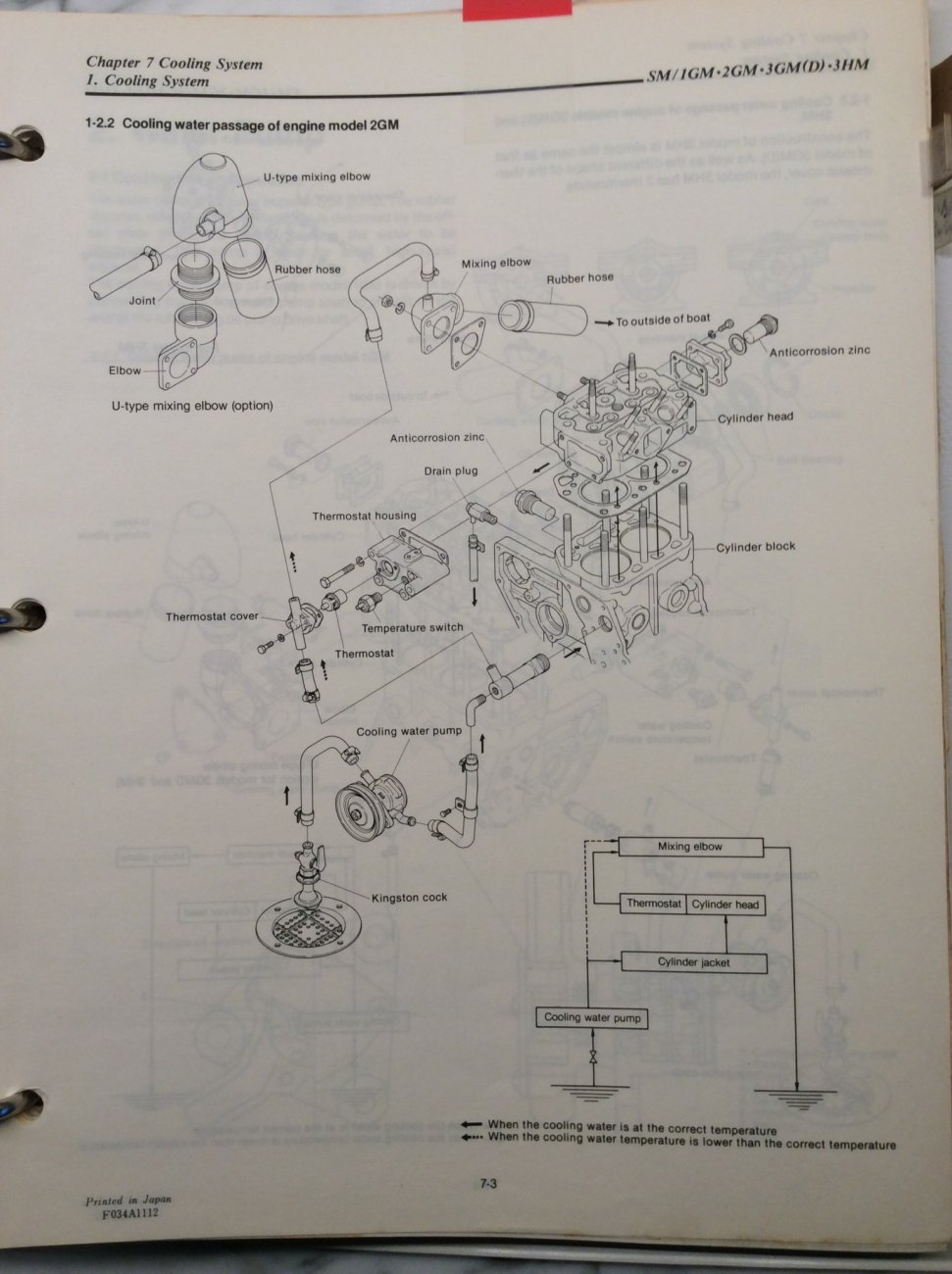

You either forgot to mention getting the engine up to temperature first or your engine may be different from others. Mine, a raw water cooled Yanmar 2GM, has a cooling water bypass thermostat. If the engine is not up to temperature yet, the anti-freeze can be by-passing the engine block. If you start running anti-freeze through immediately after a cold start on a cold day, you can see color coming out of the exhaust, but may not actually be winterizing the engine block.
This is why I winterize the engine as soon as we tie up at the haul out dock. After the four or five hour river trip I know the engine is hot and the antifreeze will not by-pass the engine block. I also run a full 2 gallons of antifreeze through even though we start to see color about half or three quarters through the first gallon. Want to make sure it’s pure antifreeze coming out before I stop. Cheap insurance IMO. I drain the sea strainer and all sea cocks after haul out.

My 2GM is raw water cooled; no heat exchanger. Here is the Yanmar Service Manual diagram of the 2GM cooling system. If the engine is not to temperature, the flow of raw water though the engine block is shut off and the water by-passes directly to the mixing elbow.

My 2GM is raw water cooled; no heat exchanger. Here is the Yanmar Service Manual diagram of the 2GM cooling system. If the engine is not to temperature, the flow of raw water though the engine block is shut off and the water by-passes directly to the mixing elbow. View attachment 165011
What type of MIXING elbow do you have Dalliance???
