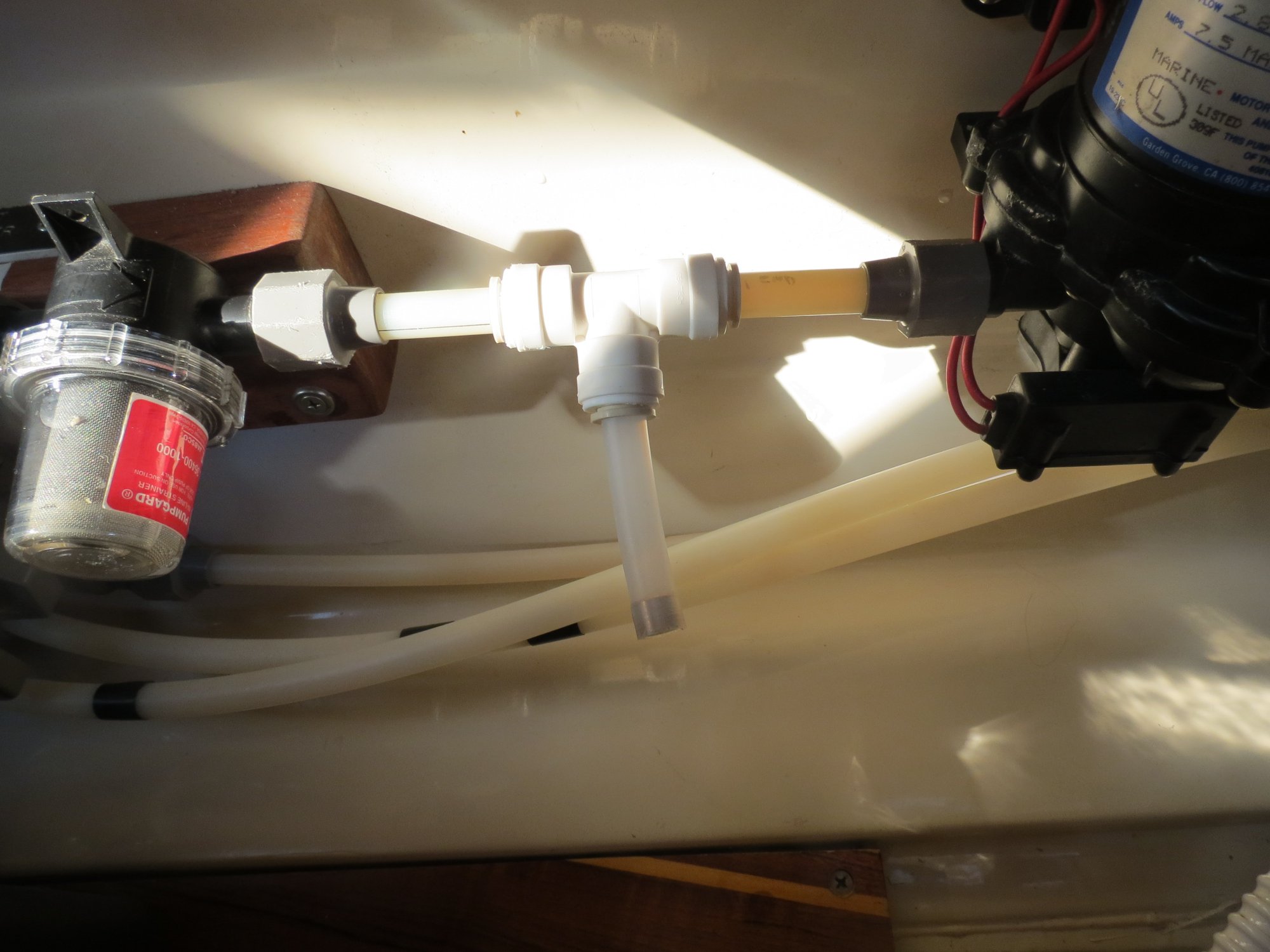

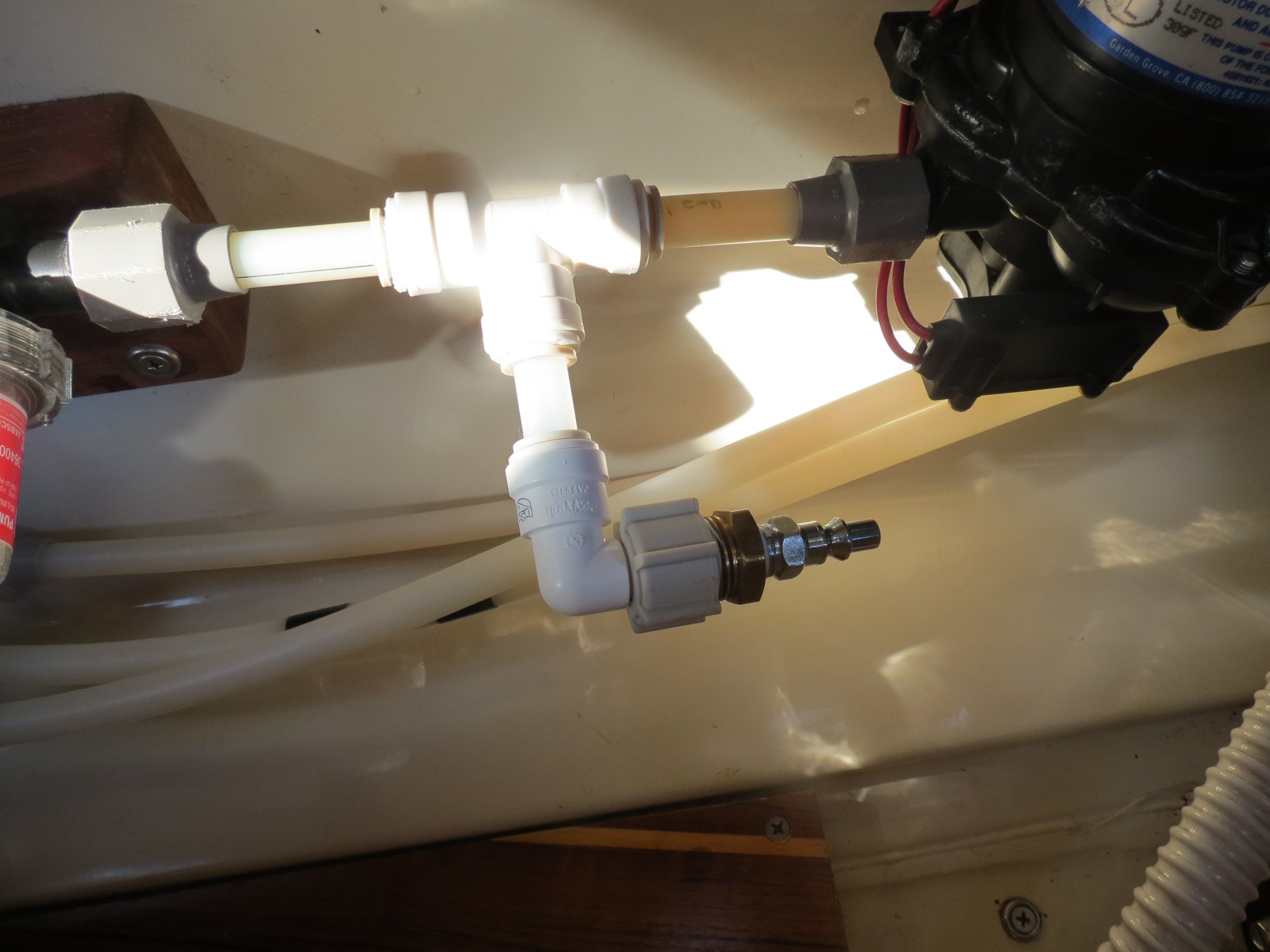

I have a procedure that I have used for years with no damage. I drain all of my water tanks and the HW tank. Then I connect my air compressor set to 35# to the input line to my fresh water pump. I blow the supply lines back into each tank, then blow out all of the lines to each faucet. I blow straight through the pump and valves. I open each faucet in turn and rotate through them a couple times until only air blows out of each one. Enjoy a beer while the lines are purging. Done.
No pink stuff used at all. $$$ saved. No flushing the bad taste out in the Spring.
I did make up a special fitting to connect my air compressor to the input of my pump, but that is a one-time project. A short stub with a plugged end is installed for normal operation. The fittings are quick-release so it is very easy.
View attachment 210529View attachment 210530
That's pretty slick, I might have to copy it. I use a blowgun with a rubber tip which gives me a tight seal but means I have to undo one of the fittings.
