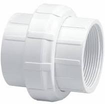

I use a pvc union to bypass the water heater.
When I winterize the AC, I use a small electric pump to pump antifreeze through the outlet until I see pink come out the inlet. That could also work on the toilet intake if you have an assistant pump the toilet at the same time

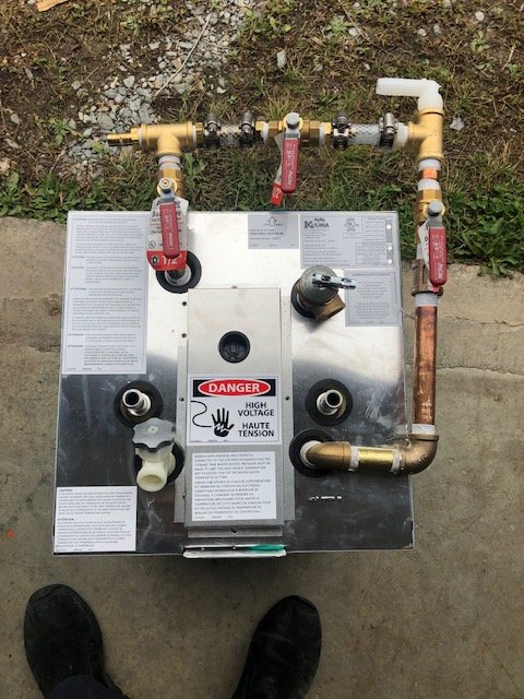

When I installed a new water heater last fall, it had a 3 valve manifold attached. The manifold valves are all oriented in the same direction for season. All valves in the vertical position for summer, horizontal for winter. In winter mode the water heater is isolated and antifreeze that follows the cold water hose goes directly to the out hot water hose.
