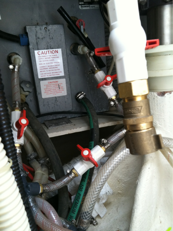

Here is my setup. The valves at the cold in and hot out hoses would both be closed (the cold is closed in this pic...took it while preparing to winterize) and the one in the middle is on a hose connecting the hot and cold hoses. That would be opened when winterizing and closed (as shown) otherwise.
