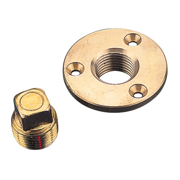

I installed a garboard drain and plug on my old H37C. It just makes sense for those of us that haul every winter. Just remember where you stow the plug so you don't have to search for it in the spring!

So...you drill a hole in the keel low down for this and leave it open?
1,076
Yes. I installed it at the bottom, aft end of the keel sump. Took less than a 1/2 hour to measure, drill and bed it (in 3M 4200). Make sure to buy a good quality bronze fitting, use bronze screws and it will last a lifetime. Use a bit of teflon tape on the plug threads and it won't leak and will be easy to remove next fall. Wooden boats used these all the time, as freezing bilge water can spring the garboard planks. Makes sense on a fiberglass boat too, especially if you have a keel-stepped mast that you leave up in the winter. An added bonus is that it is easier to clean the bilge and to drain the water tanks.

Common problem with keel stepped masts. Jim is bang on with the garboard plug. Easy install. I also fill the opening with bronze wool as I have had little critters find shelter in my boat during the winter. They don't chew through the wool and it still allows drainage.

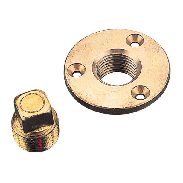

View attachment 199582View attachment 199582
ONLY IF IT IS TRULY BRONZE. Check it and see. And install with ONLY bronze fasteners.
Brass fittings have no role underwater (literally; they will disappear through corrosion).
