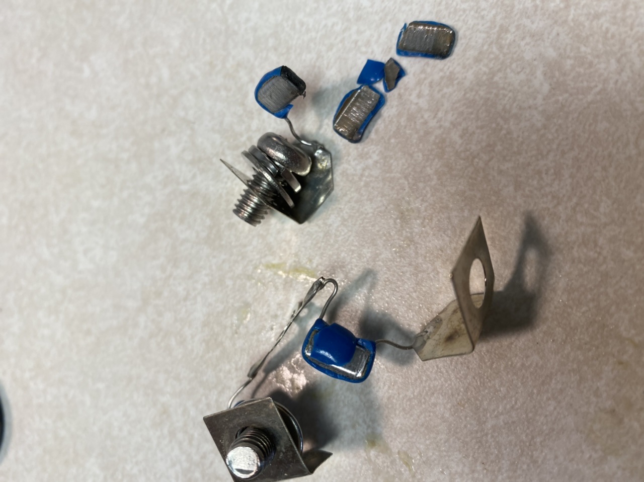

Probably a Xantrex like mine? Mine made it almost 6 years, then two of its capacitors looked like this -
I really wanted to replace it with a Sterling from Maine Sail, but this was right when COVID lockdowns were starting, so we got another Xantrex instead as a drop in replacement. I figure where the Xantrex is installed might just be enough space for the Sterling ProCharge Ultra Lite. The full size Sterling would probably need to be installed somewhere with more space, maybe the hanging locker. At the time I didn’t want to be stuck short a screw or something and not able to buy one anywhere. Next time around I’ll probably switch.

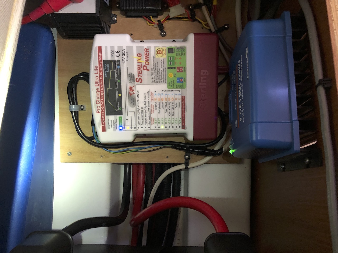

Yes, I have a Xantrex. Yes, I've just figured out that bumping my house batteries to a pair of G31s means my charger is now under powered. Yes, I was looking at the ProCharge Ultra on Maine Sail's site. And, yes, I think there is not enough space to mount it where the Xantrex is currently located. I think that you have quite a bit more room to work with there than I do. The hanging locker is out for a location because when we cruise, we jam it absolutely full. I'm starting to feel, once again, like the guy who ended up spending thousands of dollars to have his classic sports car repainted, because he decided to get a curb scuffed wheel repaired... B.O.A.T.
Nov 21, 2007
673
@Davidasailor26, I just checked the dimensions on the spec sheets. I think the Pro Charge Ultra Lite would fit in a smaller footprint than the Xantrex. As long as it can be mounted in that position... I may go ahead and do that. Cool! :cool:

@Davidasailor26, it's in... super easy installation. I had almost no wiggle room for the DC lines, so the Pro Charge Ultra Lite is squeezed a bit farther forward (to the right in the photo) than I would have liked. Those DC lines are also the minimum AWG recommended for the charger... since one of the reasons for the upgrade was to increase the charger output to the two new G31 house batteries, I could replace the charger output cables with something larger. OTOH, with the solar also providing current, the increased capacity from the Pro Charge Ultra Lite is more of a contingency than necessity, what do you think?
