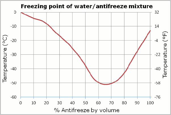

Not a good idea in cold climates:

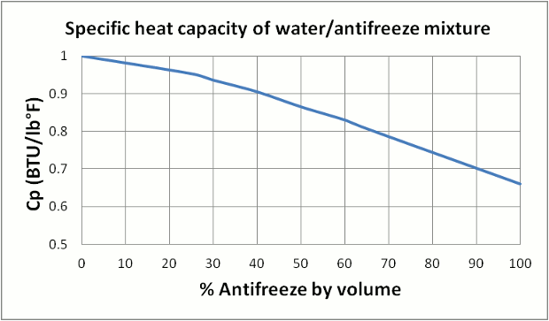

And not a good idea in hot climates:
Correct, however, there are several factors to consider.
Water is the only compound that expands when frozen, it is this expansion that causes damage.
Glycols become very thick and slushy when frozen and do not expand. This makes it very hard if not impossible for a circulating pump to pump the ethylene glycol through the cooling system. However, I don't run the engine in the winter time.
The EG is only in the heat exchanger and the water lift muffler not in the engine block. The engine block has a 50/50 mix.
The 50/50 mix is cheaper than straight up AF, so I'll probably shift to that when I winterize again. In the mean time I'll stick with the straight EG as it is already in the cooling system.

Dlochner is correct, glycol (either type) contracts upon freezing. So in his application he is doing it in a successful way. The glycols are typically used to conduct heat, therefore are mixed with water. But in this application, it is not conducting heat, simply protecting his system from breaking due to the expansion of water occurring during freezing. Nice application.

One of my assumptions, which was a incorrect was straight EG would have a lower freezing point than diluted EG, thus I used the more expensive straight EG than the 50/50 mixture. Now that I know better and know there is some tolerance for dilution, I will shift to the cheaper expensive stuff in the future. A gallon of PG costs around $5 here and the 50/50 is about $10. Since I only use a gallon to winterize, the cost difference is minimal. However, if I make my own 50/50 solution, I can get the cost down to about $6 gallon and I only have to buy it every 2 years.
