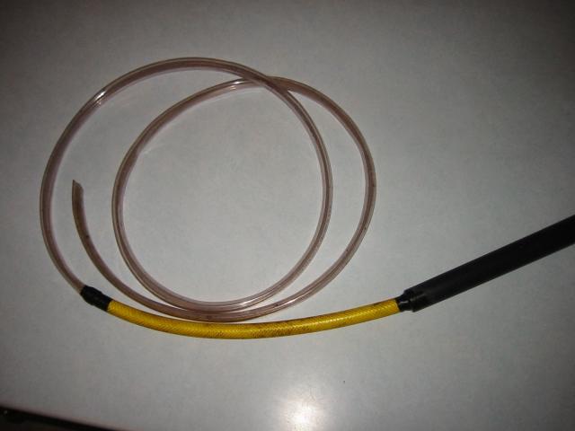

Emptying the bilge on our boat is a tricky situation since the opening into the bilge is only 2 3/16" inch tall, about the height of a credit card. I use a 5 gallon shop vac with the hose modified with garden hose, plastic tubing and electrical tape as show in the attached photo. After vacuuming, I use towels tied to the end of a stiff wire to "mop" it out.
