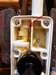

Keep in mind the fact that a trivial amount of water left will have enough room to expand when it freezes so as to not cause any damage. Only in confined spaces can it be problematic
Don is so right. Confined spaces are the issue.
This is what a trivial amount of water can do. Picture is worth a thousand words.
