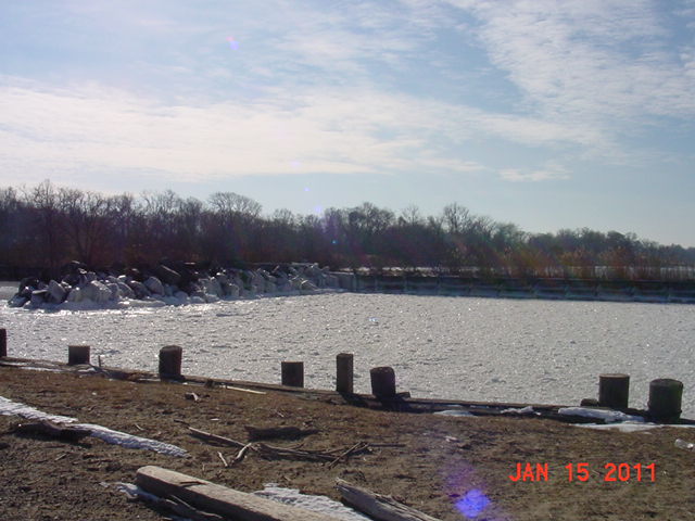

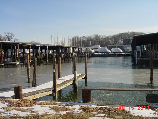

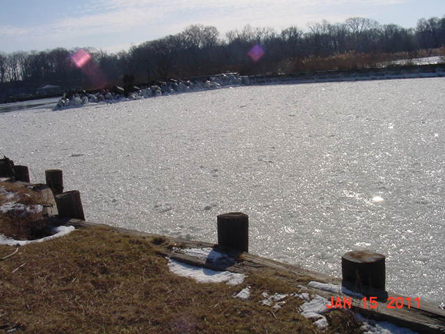

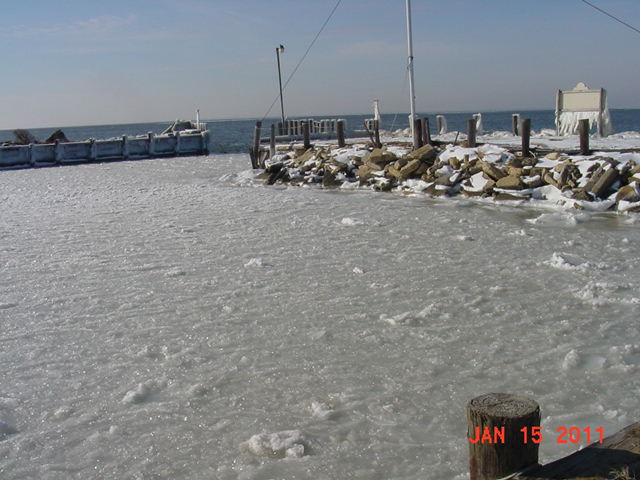

These were taken across the bay from the middle river at Tolchester marina.
This is not a chance I want to take because you never know.
