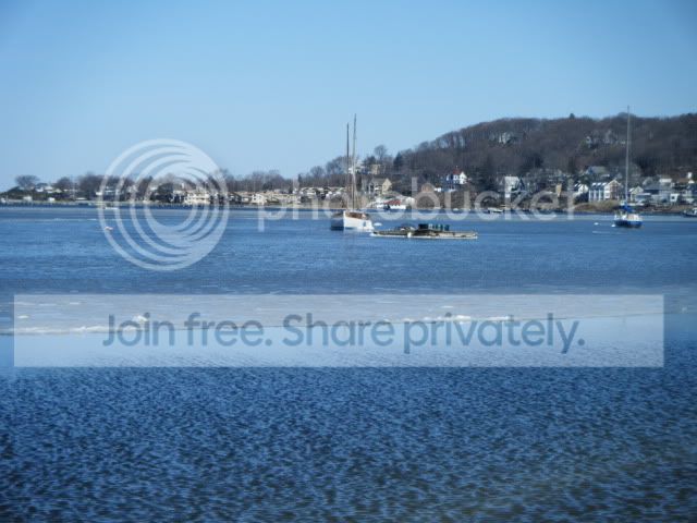

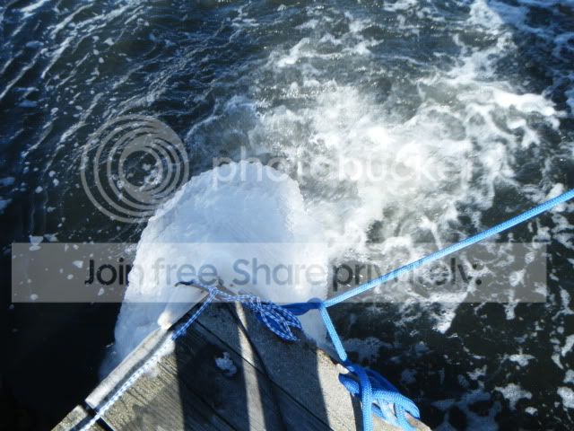

Well we are back to having REAL winters with REAL snow
I think its a bad idea and a really bad idea if your not near the boat
May 21, 2006
321
catalina 25, 30 montauk / manhattan
tommays, thanks for the "cold" reality!! yes those pics are concerning, maybe will take them out and spend the winter trying to figure out a way to move south!
