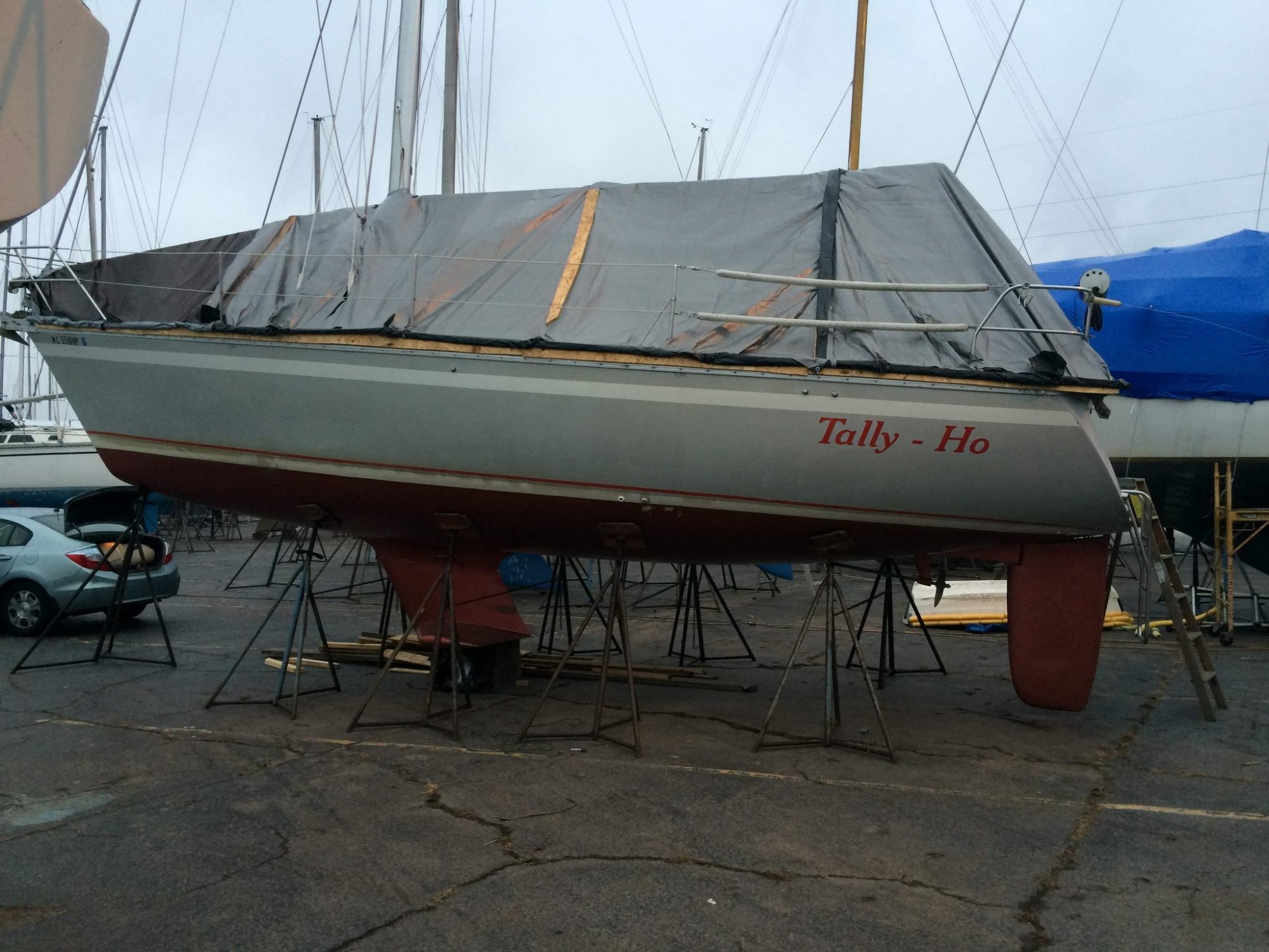

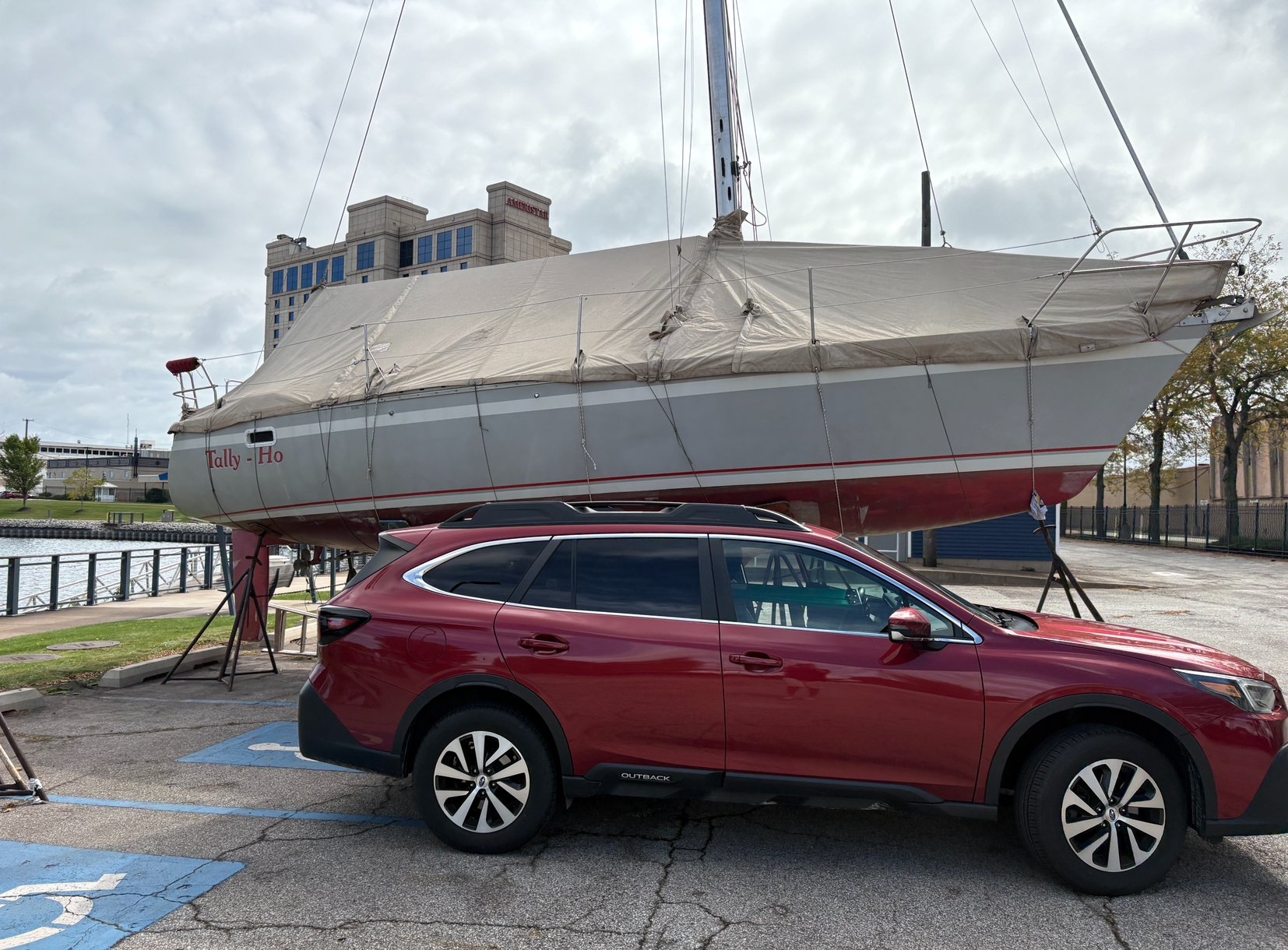

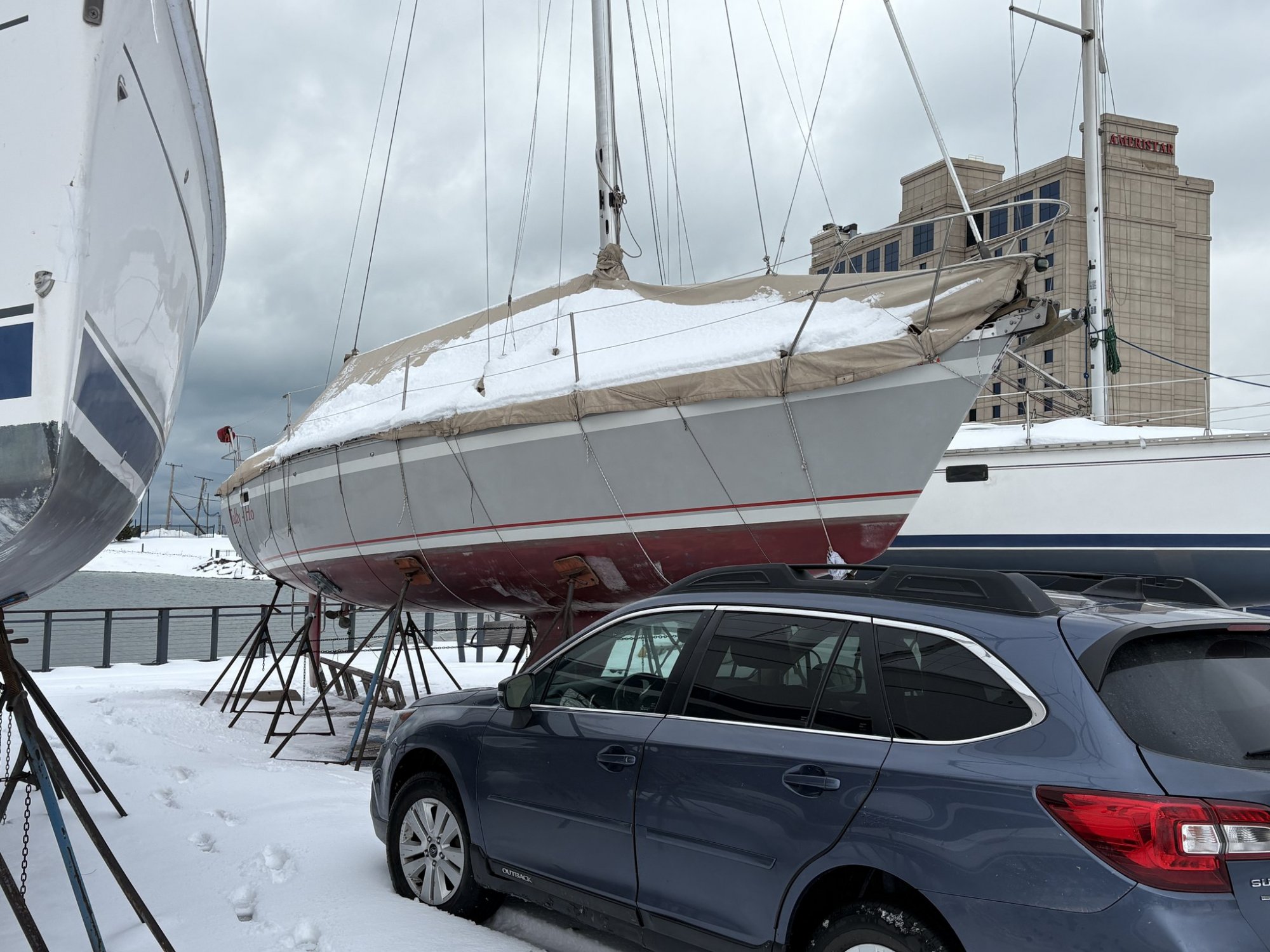

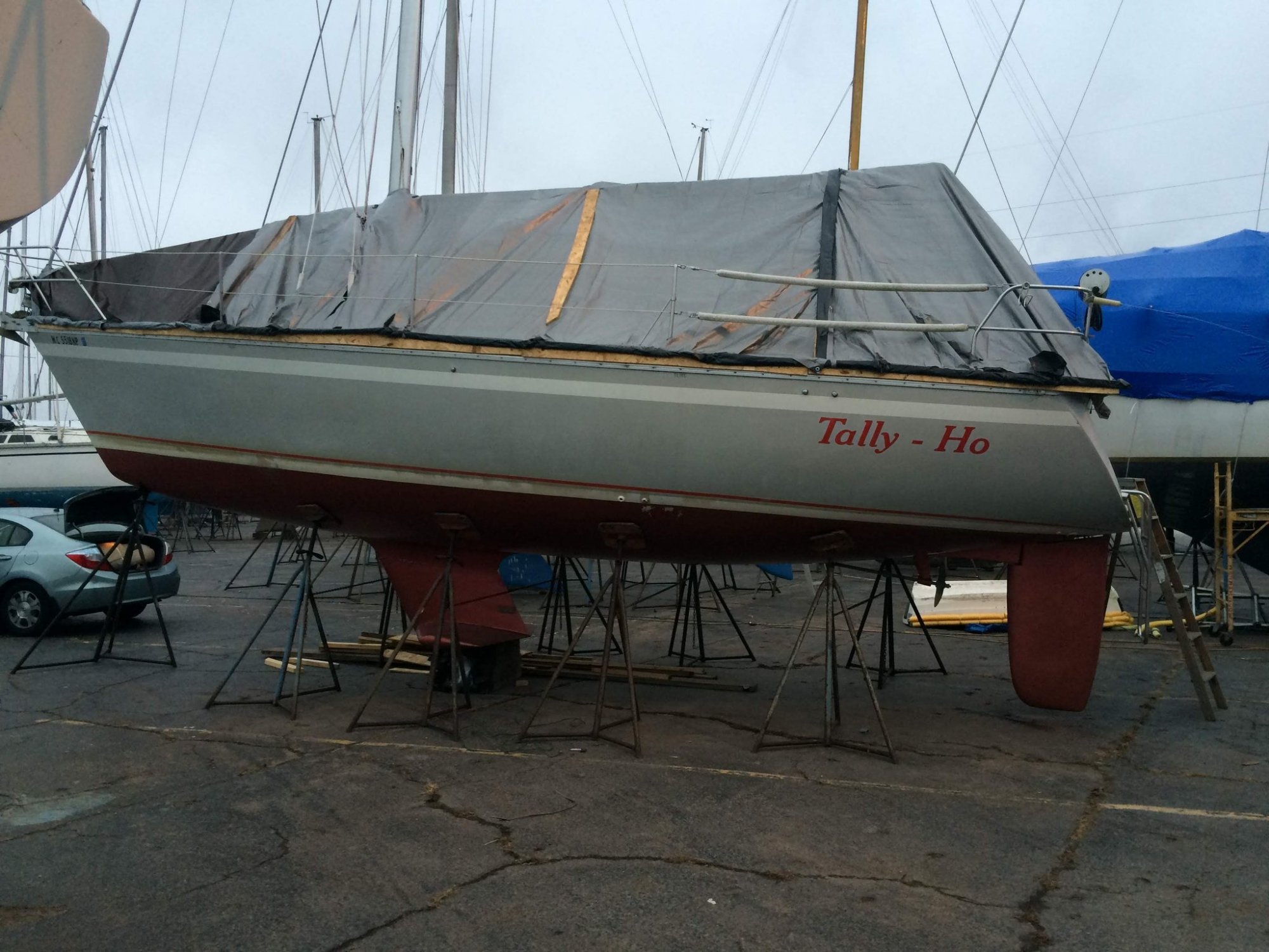

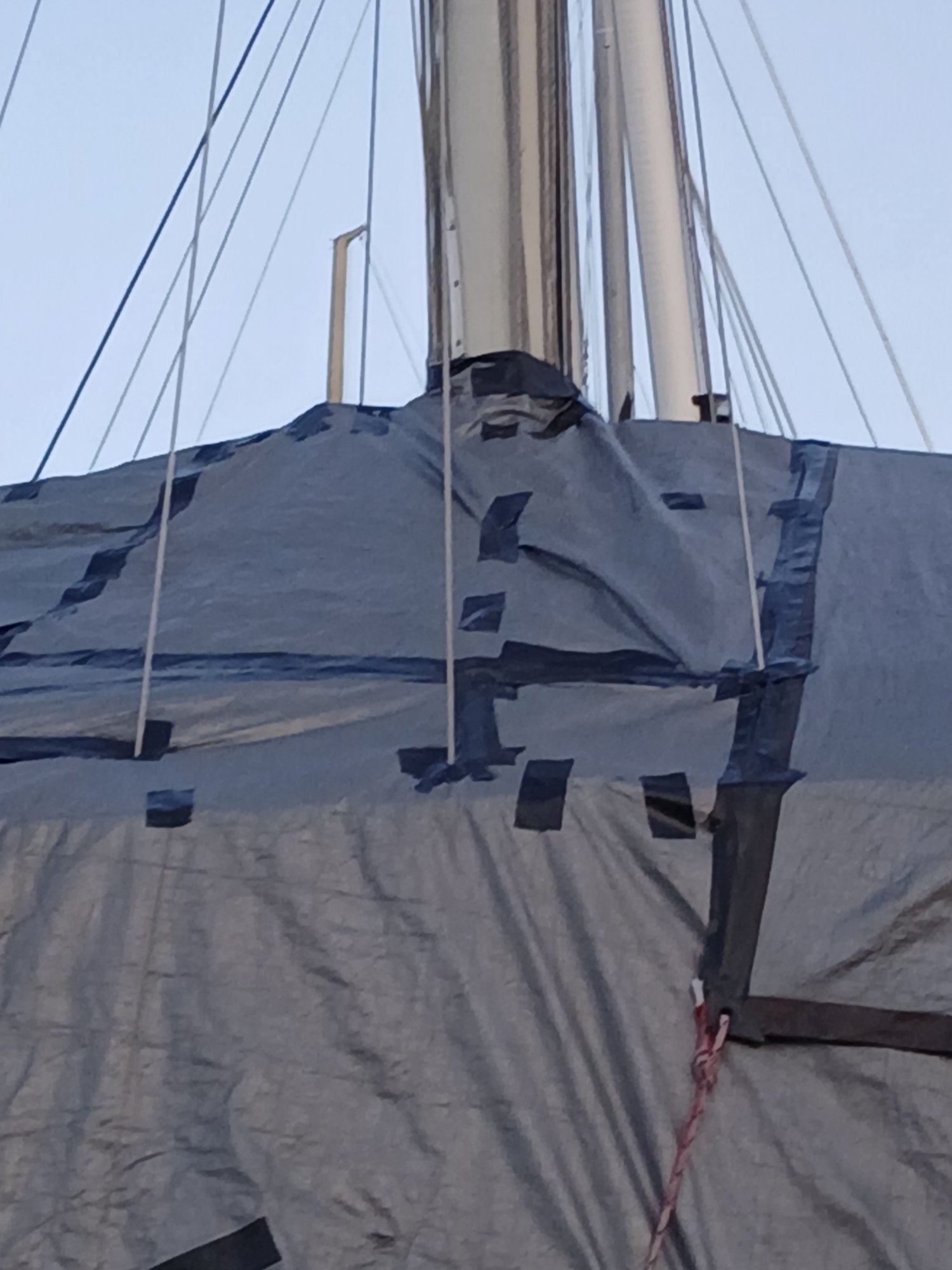

The first year I owned Tally Ho, I did a tarp. Very labor intensive and I built a wood frame to secure the boards holding the tarp in place. Took days and a day to take it off ( sacrificial tarps).

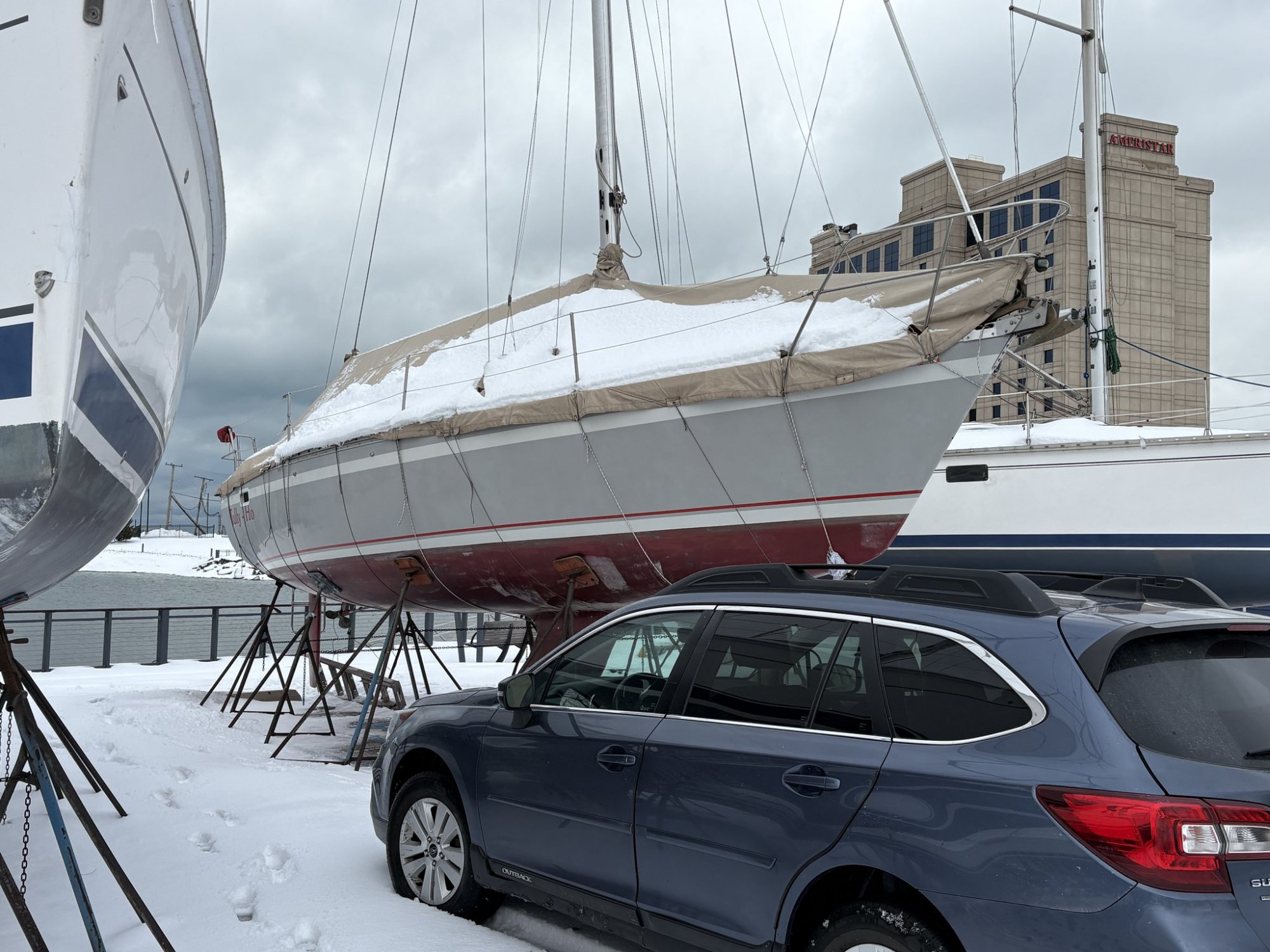

Nothing beats a custom-made canvas cover for keeping the ice and snow off the boat (except maybe a boat shed). Something to consider next year. Expensive to acquire, but I am going on 12 years with mine. It is showing some age and I will have some repairs to make next spring, but it has been doing a good job since I bought it. I see too many tarps on boats in the marina that have ripped, or filled with water or blown off. And no frame required.
The only thing I would do different is to get the sides longer.
View attachment 236016 View attachment 236015

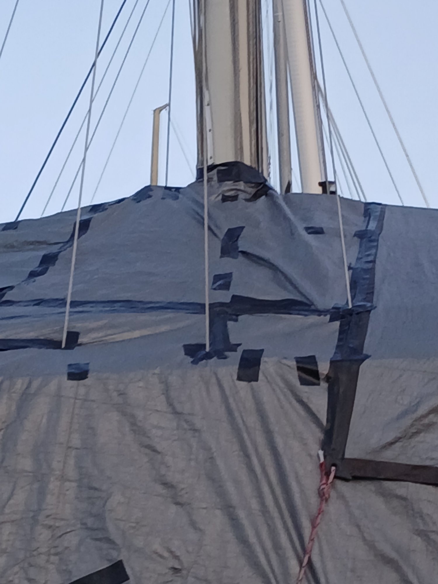

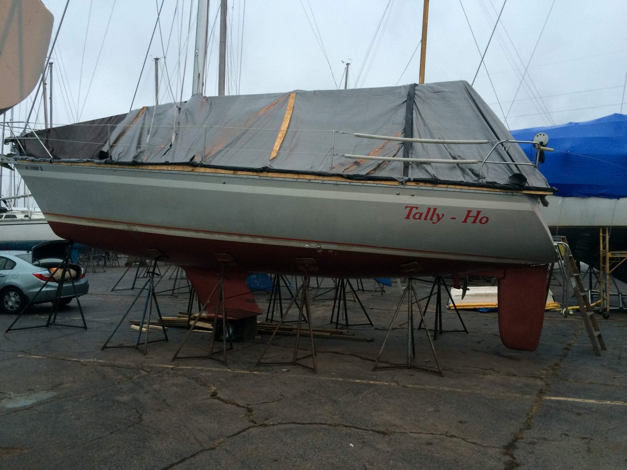

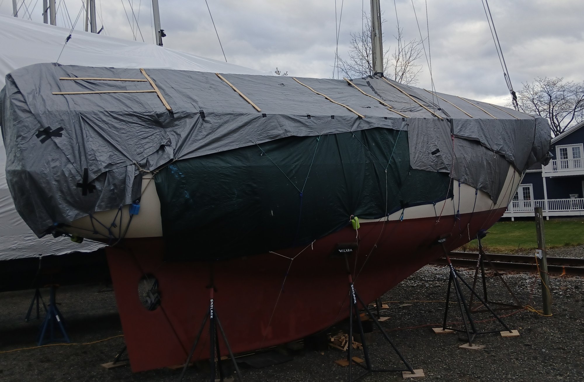

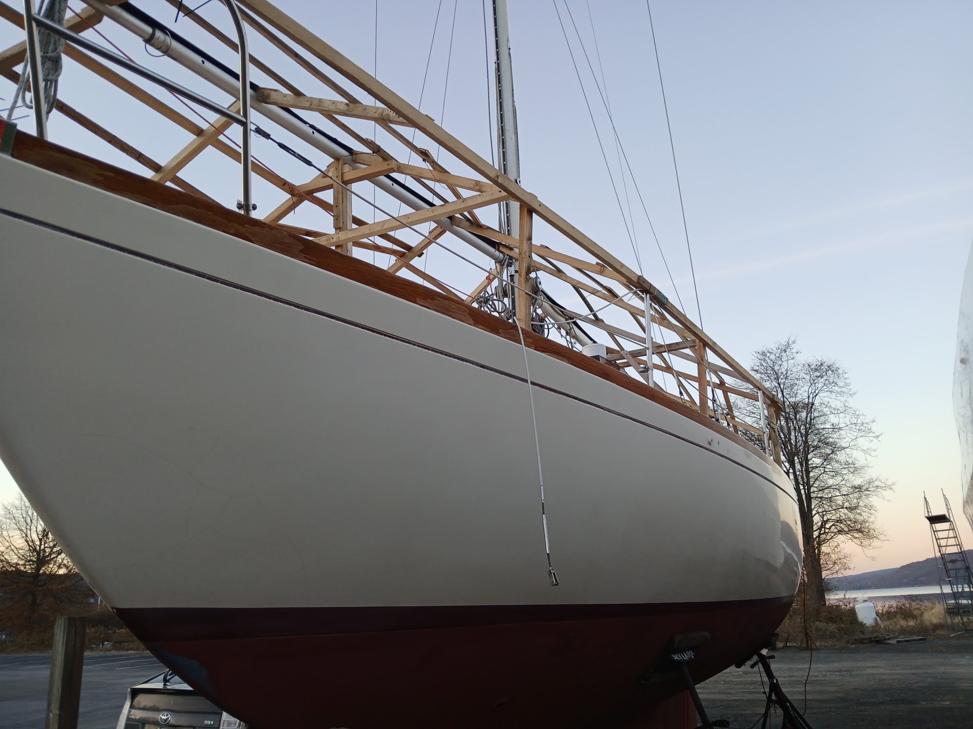

I have been tarping my boats for years. I have found that the tighter-the-better and more than one layer is helpful. In essence, I use older, more worn tarps as sacrificial top layers.
With the mast down and serving as a longitudinal peak the process is more straightforward and requires less customizing albeit with the expense of unstepping added to the mix.
On the other hand I have also gotten comfortable with "tailoring" (cut & tape) to fit around shrouds and stays; I am at a yard that allows us to keep the mast stepped for the winter.
A frame makes tarps more feasible. Some 2x2s, cable ties, GP screws, black gorilla tape (have found white degrades faster) and some thoughtful planning can make a frame that can be disassembled for storage and reuse. The first year it takes a lot of time, but subsequent years it goes a lot faster (photos, diagrams and labeling ease the process).
A few more tips for tarps:
The grommets are failure points and not always well placed (when tarps are stapled and slatted the grommets are less of an issue as the loads on them are significantly less). But when necessary I have used ping pong balls by wrapping the tarp around them and then tieing a hold down line around the tarp trapping the ball within.
Also... the rolling hitch is a helpful knot to use for tie down lines.
Tying together the athwartship frames with longitudinal slats keeps the tarps from sagging, making depressions that trap snow and ice/water) and provides rigidity and strength.
Lastly, I have found (and this is important) that stapling the tarp (pulled taut) to the frame and then laying thin wooden slats (screwed down) over the top keeps wind from doing its destructive dance. The resulting holes are minimal and can be taped over for future use. The attached photos illustrate my efforts and I can say it's doing fine having survived several 30-40kt winds during this winter in upstate NY. It's not pretty looking, but works and is a lot cheaper than a custom cover (which admittedly, I do hope to someday procure, but for now... it's tarps).

View attachment 236017View attachment 236019
Wow! That looks like a lot of work! Do the grommets scratch your gelcoat?

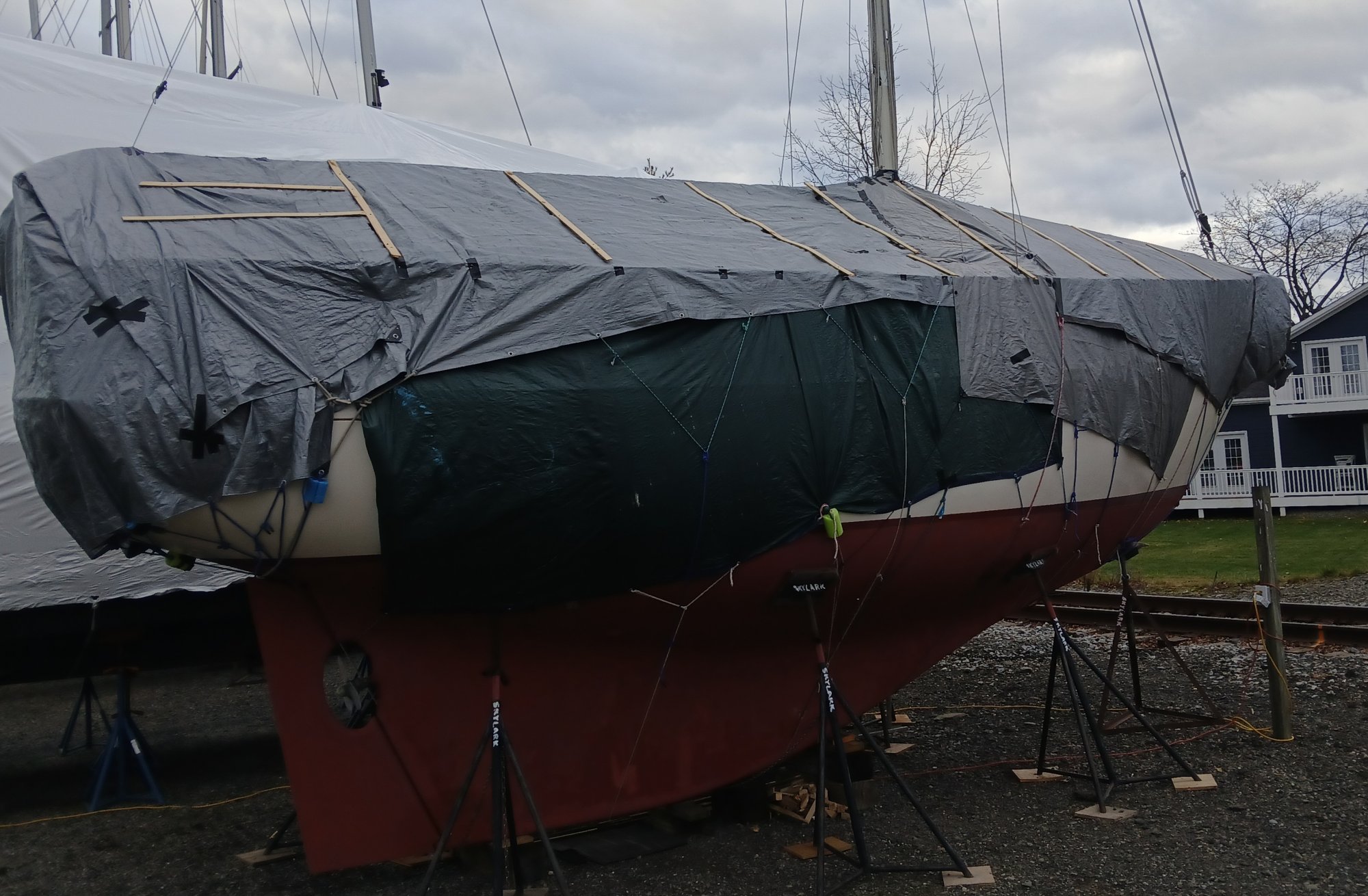

The best tarp job I ever did used the mast as the peak of the framework. I closed off the bow and stern with a 2x4, screws and fender washers. Excess tarp was wrapped around the 2x4, further spreading the load. I was able to pull the boat into a heated building to tarp it. This year was a rush job in the cold. It convinced me to buy heated gloves which I would highly recommend.
I'm thinking about picking up some 1x2 furing strips to roll up in the edge of the tarp so the load isn't just on the grommets. I can then use a screw through the tarp and into the wood to add a single hole D ring.

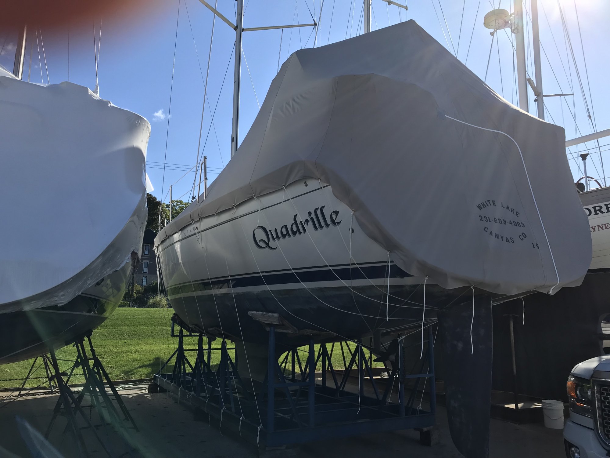

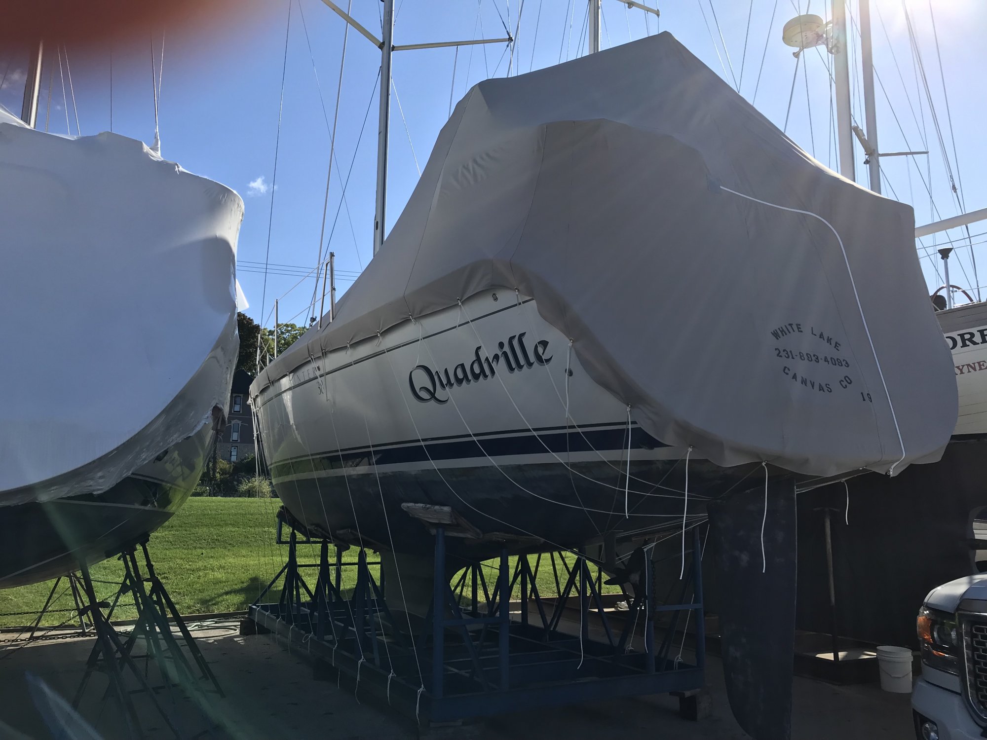

After wrestling with tarps and home built frames, I broke down and bought a custom fitted cover with frame. It went up fairly easily and allowed for access to the boat all winter. In the spring when weather was not cooperative I was able to work inside the boat. It was worth every penny and amortized over the 10 years I owned it, not particularly expensive on an annual basis.
When the custom fitted cover on my current boat reached its EOL, I replaced it with another fitted cover. Then I got older, added solar panels and the time to remove the canvas, frames, and solar panels and reinstall them was excessive, it was 2 or 3 days of work in the fall and spring to cover and uncover the boat. Second Star now winters in a barn. The canvas stays up, the solar panels stay on, and weather is not an issue when working on the boat. It is money well spent.

absolutely agree! I am on my third custom made cover over two different boats. They last at least 10 years with the newest one having a projected life that’s even longer due to newer materials.

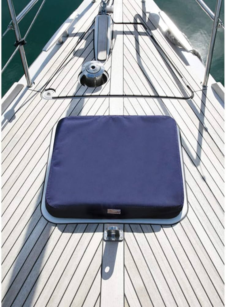

The forward hatch needs a new gasket and it cant be replaced in the cold due to sealants not curing properly.
What about a hatch cover?
Oceansouth-Sailboat-Hatch-Cover-Square
Sep 24, 2018
4,565
Catalina 30 MKIII Chicago

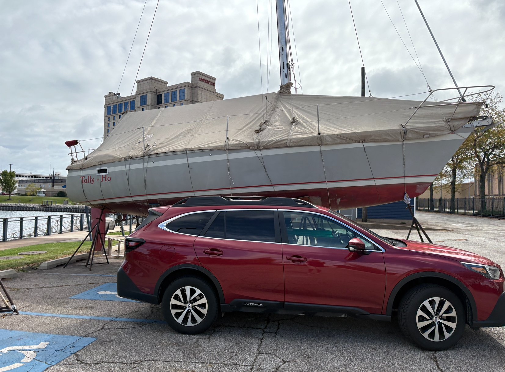

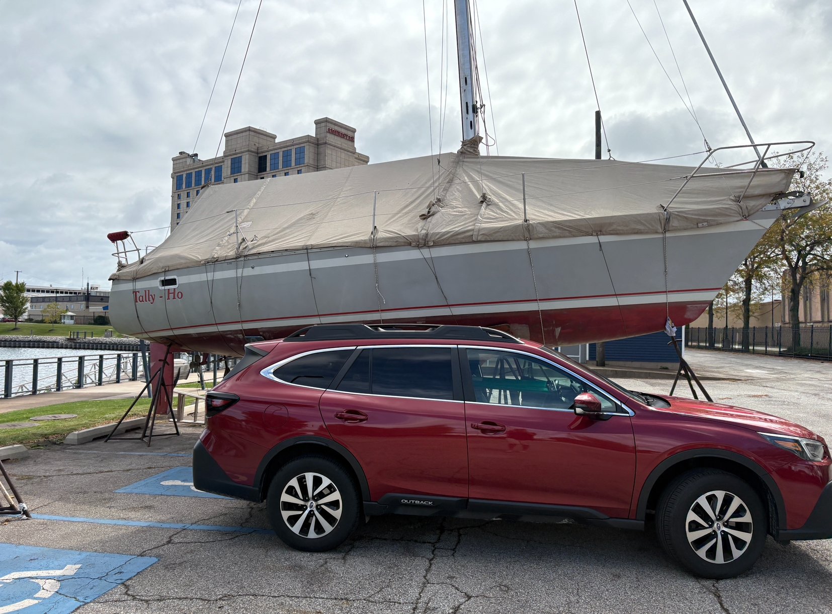

if you do use a tarp you must not use your mast as a central support for the tarp. I made that mistake many years ago and the weight of the snow and ice put a permanent bend in the mast.
The yard put it on the pulpits. Unfortunately it pulled the bow pulpit out of one of the bases (see saw effect) so I'll have to bug them for the sawhorse that I was promised to begin with. They were bought out and are struggling in their first year under new management
Good idea. One hole down, 99 to go though
