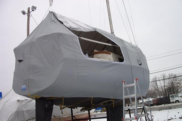

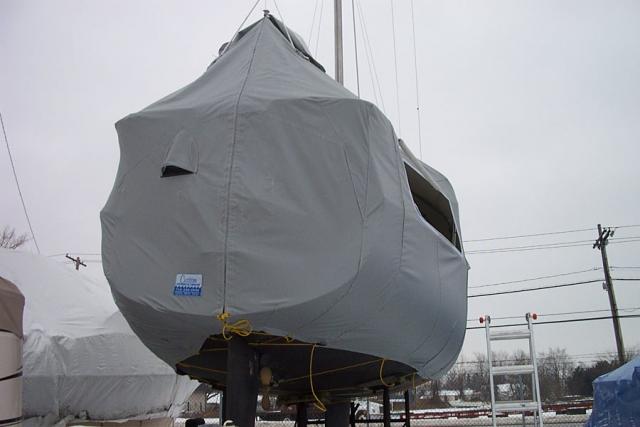

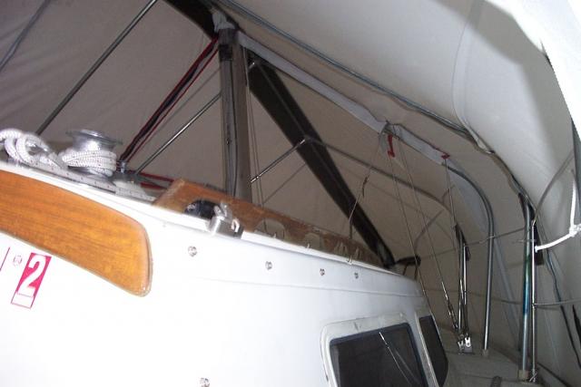

I have a custom made cover for my Newport 30, it was investment well worth the $$. today it was 32F out when I went to the boat, just plugged the electric ceramic heater in and in no time it was warm and toastie, to work on the cabin of the boat.:eek:
Find a local canvas guy to make you a cover, you'll not regret it, also contributes to the resale value of the boat
