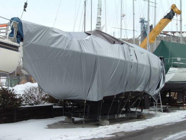

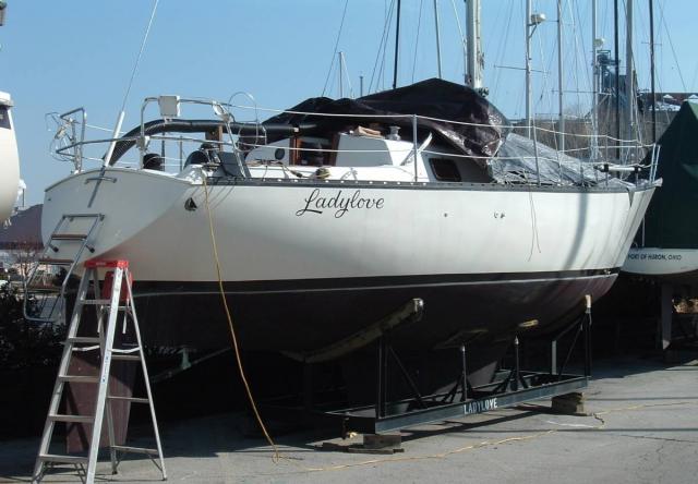

The first picture is interesting where you see part of my cover, a custom cover on the Bene, and a bunch with no covers. Then another where my boat was covered just to the toerail. I use drain pipe as part of the spine. And a third picture where, one winter, I covered over the stanchions.

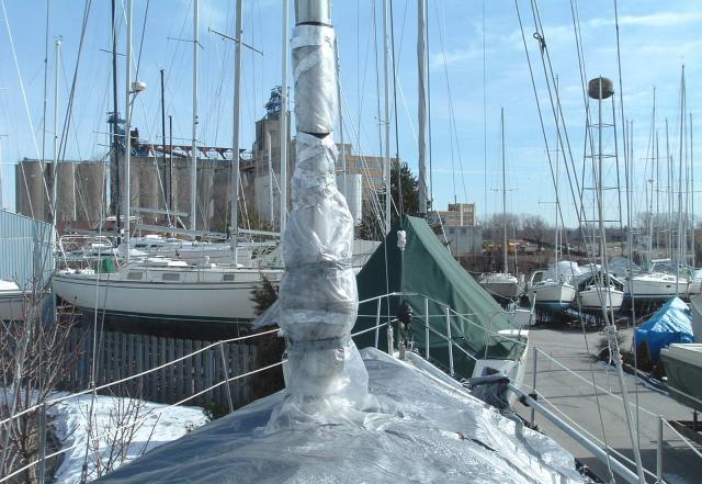

I also wrap the mast ends in contractor bags to protect the roller furler and the exposed halyards(too lazy to take them off and figure out the right running direction in the spring) from the damp/freeze damages.

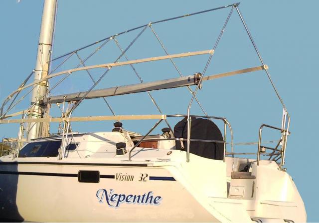

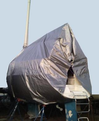

I used a tarp last year with great success ... Upstate NY ... ice and snow and winds ... I guess the key is to have a good enough peak to shed the heavy stuff.
I went to the "custom cover" producer's web site and copied their design for the frame. 3/4 inch emt pipe I bent myself (pretty easy to do ... go to Home depot and pay $30 for a pipe bender)... used connectors from www.framemakerclamps.com (I've no association with these folks). Got the tarp online too ... rubber crutch tips where it hits the deck .. cheap 1x2 wood strapping and nylon reinforced 1" tape ...
Tarp survived well over a rough winter ... probably good for another couple - three years at least ...

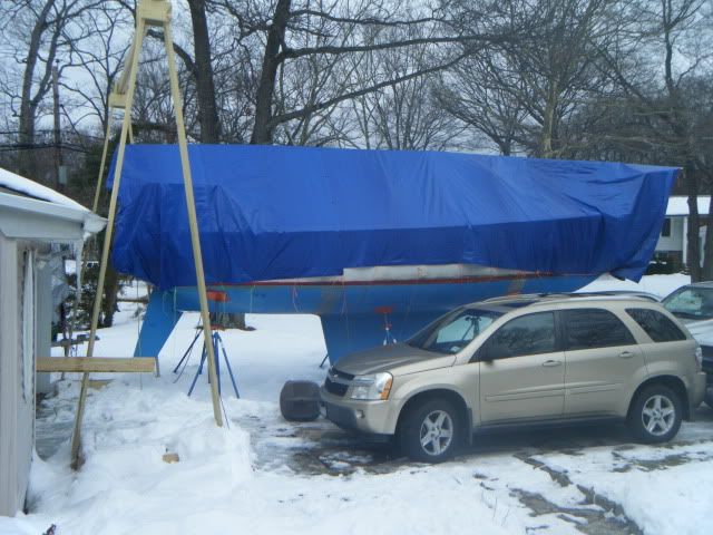

On my old Mirage 27, I used tarps very successfully. I removed the stanchions to increase the pitch and limit chafe.
I built a very simple frame. I bought saw horse kits and built one to go on the foredeck and over the main cabin. I would remove the boom. I Built a third support that sat on the cockpit floor, basically a high saw horse. I placed the saw horses so they were aligned to the middle of the boat. I put together 1 x 4s as a ridge pole. I taped the ridge pole to the forestay, the mast, the backstay and the saw horses. I covered the corners with old carpet. I used 2 tarps, and connected them around the mast with tarp connectors I bought from Lowes.
It worked very well.
