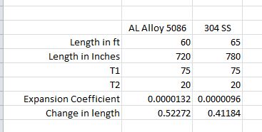

This comes up every winter.
Your rigger is correct. Aluminum (the mast) contracts more than steel (the rigging) so it loosens naturally.

While Don is correct about the contraction of Aluminum the amount may not be enough to relieve the compression on the boat hull. Loosing the rigging will not be bad. It relieves the strain the rig puts on the deck and hull. The hull take enough of a beating being on the hard partially supported. I always loose my back stay to loosen the rig when not being sailed.

I believe the rigger. My thinking is 5 turns + differential contraction the rig is loose enough to move side to side or fore and aft and the sudden deceleration is much worse than static tension.
