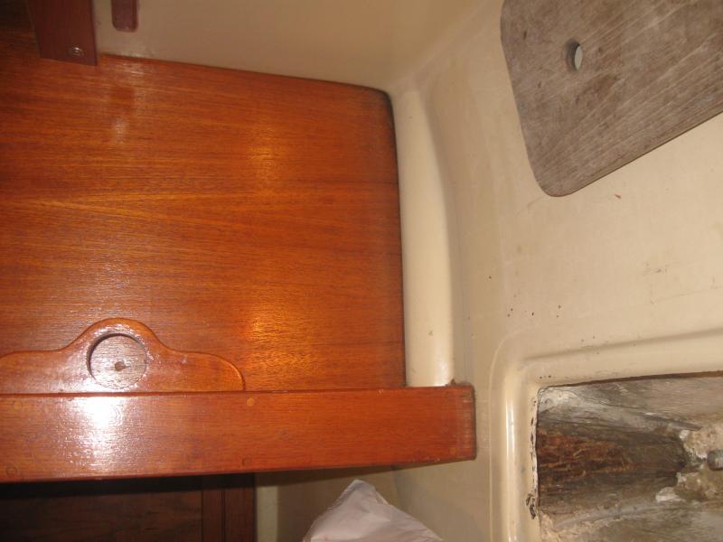

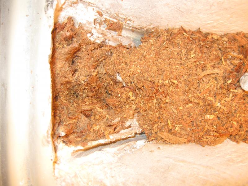

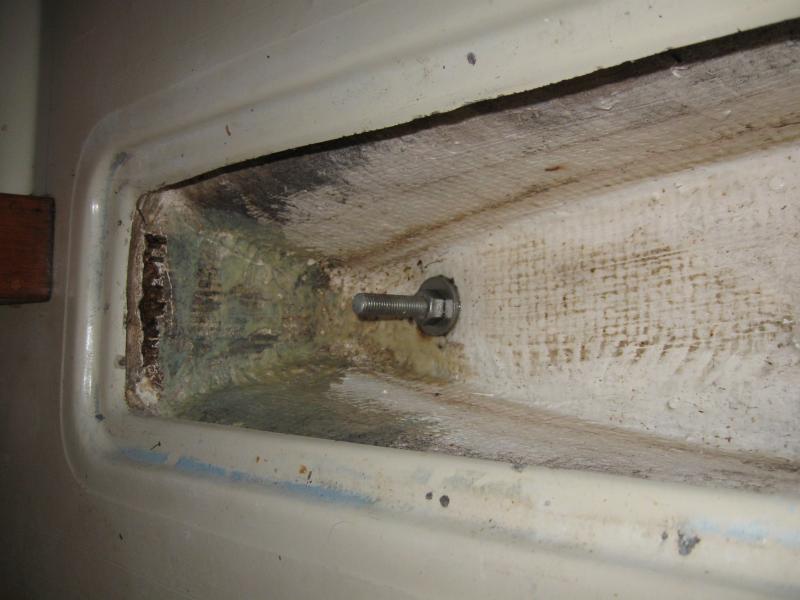

Started today on the compression post base and found a soft not rotted out post in the keel ahead of the bilge area fiberglass. The wood block was wet but not soggy, As I was into it I decided to did it out and used a drill and chisel with a shop vac to clean up the chips and I was glad to be on the hard and not doing this project in the water as a test hole or two did go a bit far in! no big deal on land to re glass it in spring. It took my about 2 hours to work the wood out and clean up and now will look for a water resistant block to replace in the area. Some guys have used a steel adjustable threaded block, some fiber glass , some concrete. I am looking for something rot resistant and some flexibility as wood would of given.
