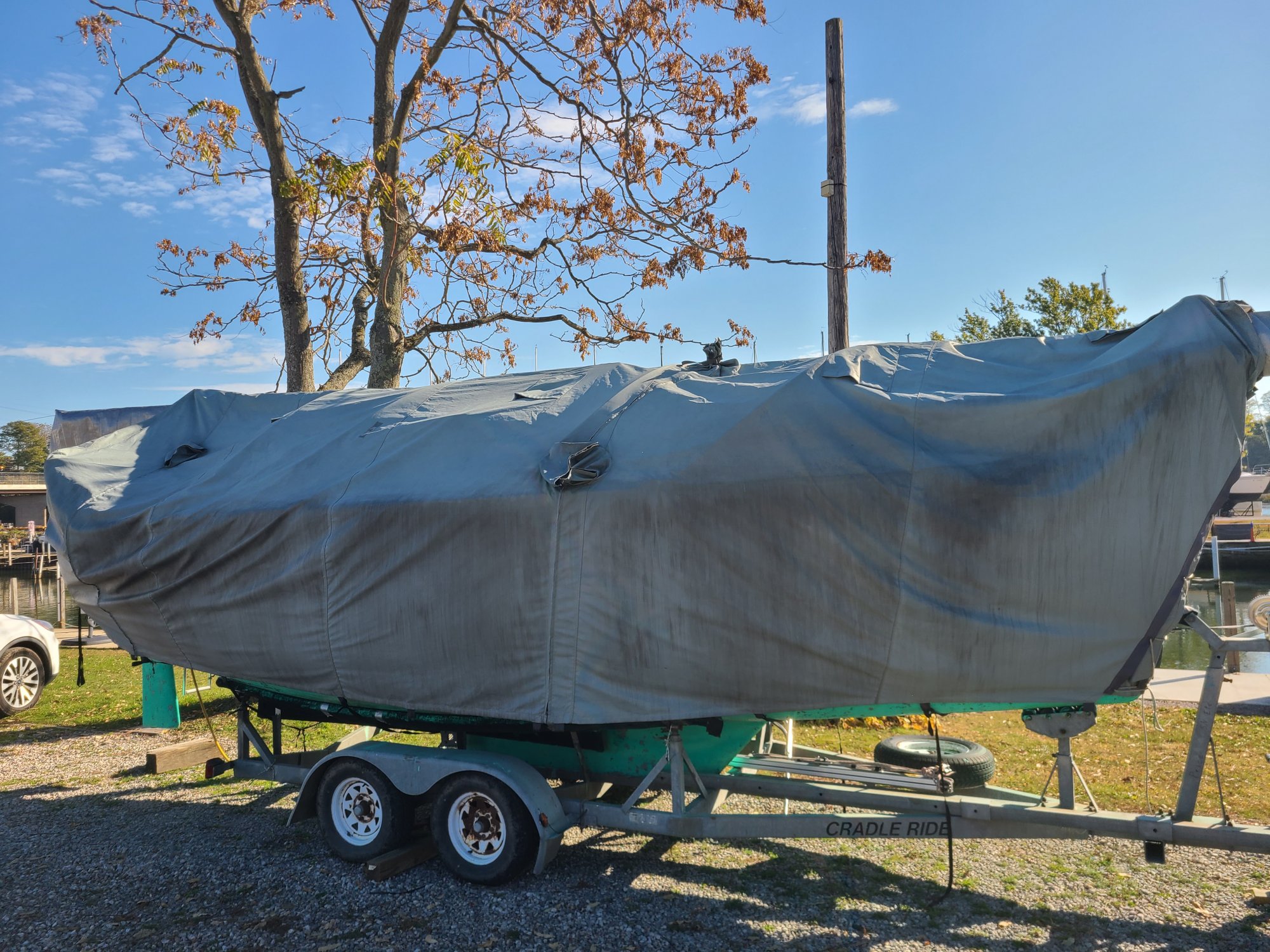

Hello all, now that my inaugural season is done and Applause is on the hard, I’m planning the preseason work for 2027. Some of the items I’m seeing and would like some feedback on are:

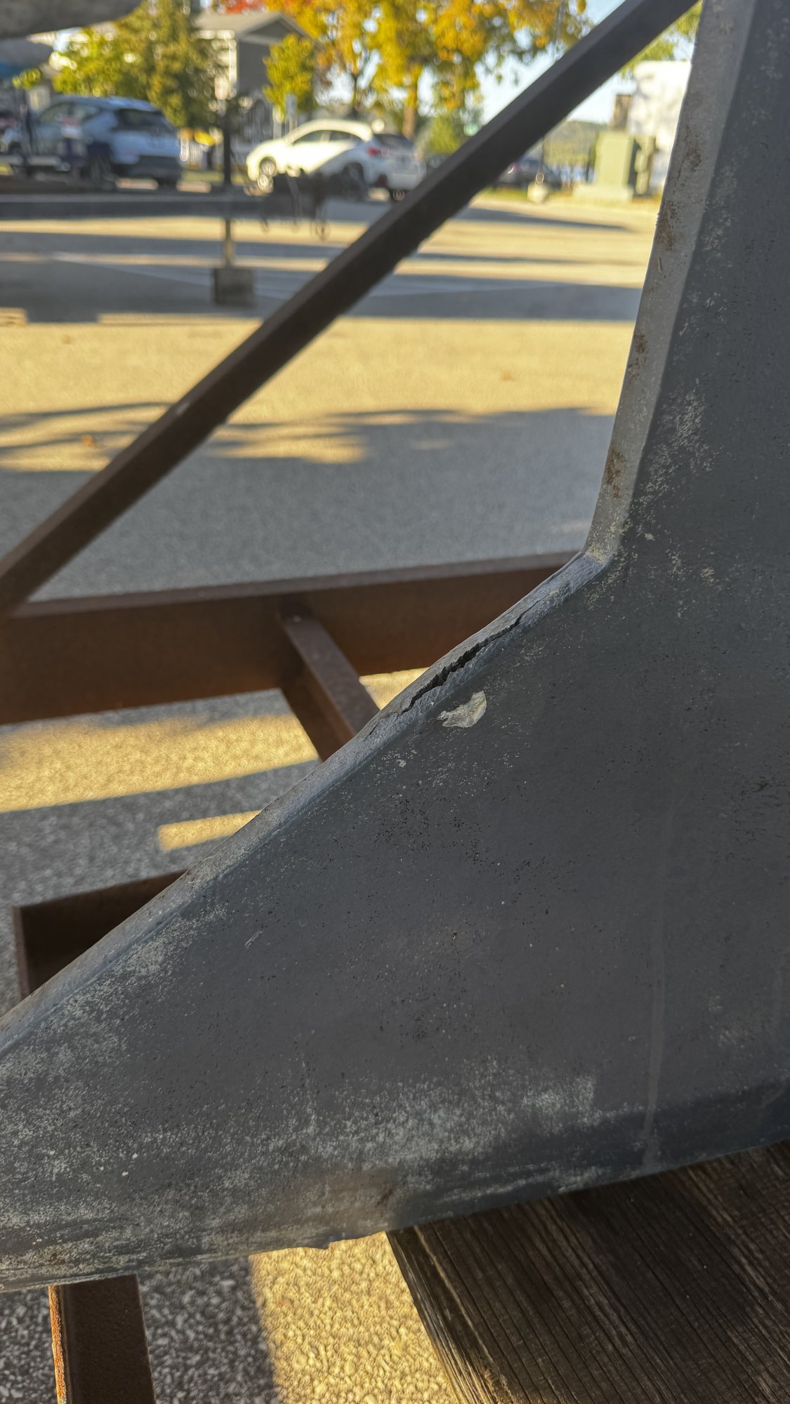

A. Keel crack, it didn’t show on the survey and not in the place you’d expect, as we assume a crack on the keel comes from an impact and is at the top of the keel by the hull. This isn’t that. As seen in the picture, on the top of the angled edge of the shoal keel, there is a crack and some separation. What would you suggest?
B. Gauge goofiness. My fuel gauge has shown full all season, though it moves when under way. I was able to add 5 gallons during winterizing so I know it’s lying. Is this just a wire issue or is this a full replacement of the sensor? Next is the rpm gauge, it will read at 3500 when I push it as hard as I dare, but will then go down after a few minutes even if I don’t adjust the throttle. The engine speed sounds the same as well. The sensor is at the back of the engine so I suspect I need to inspect and clean it, anything else I should look for? Bonus question, what speed over ground should I expect at 3500 rpm and no headwind? If there is significant headwind, does the 310 struggle going upwind under power?
C. Cockpit lighting, only the rpm gauge lights up, not the compass, not the side panel with fuel gauge, not the floor light. Assuming I need a bunch of tiny bulbs, does anyone have a list of sizes?
That’s all for now.

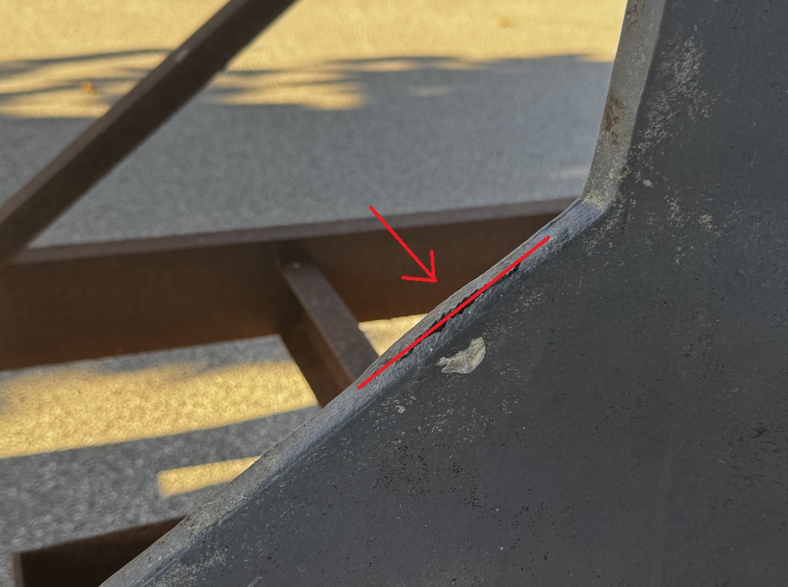

Not being there, that certainly doesn't seem like a crack in the lead keel. Lead in its elemental state is just too soft to crack. My guess is that if you get a chisel or anything else sharp and give it a couple of really good bashes, you'll find it's something other than lead, maybe bottom paint. Remove it and forget it after you smooth out the cavity.
You'll need to remove all the paint around the lead to see what's there. Keels are not finely finished castings. Before fairing and painting they are quite ugly. It could be fairing compound or it could be some debris that fell into the casting while the lead was still liquid. My keel had a pocket of casting sand trapped in it. Eventually a little water seeped in and caused it to bulge. Opening up the bulge there was a pocket of casting sand. Cleaned it up and filled it with thickened epoxy. It's been good for 10 years and counting.

The keel crack isn't in a place where I'd suspect an impact or structural issue. Do a little surgery and I'm betting you'll find it's some imperfection in the fairing or gelcoat that just needs a basic repair.

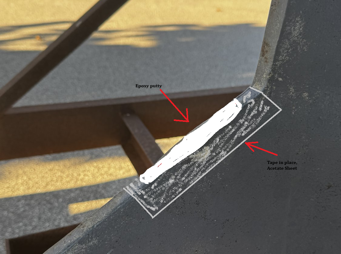

  • Open the crack.
    Using a grinder, carefully open the crack along the red line shown in the photo. Remove any loose or damaged material until you reach solid material
  • Feather the edges.
    Feather the surface about 1/2 inch above and below the crack, extending the repair area all the way to the edge of the keel athwartship. The goal is to provide a clean, tapered surface for the epoxy repair.
  • Fill the void.
    Pack the void firmly with thickened marine epoxy. A marine epoxy repair putty should also work well. Press the epoxy thoroughly into the opening so that the void is completely filled.
  • Shape the repair.
    Cover the wet epoxy with a piece of overhead-projector acetate or similar flexible plastic sheet. Press and smooth the sheet to approximate the original contour of the keel, then tape the edges in place while the epoxy cures. This will minimize the amount of sanding required afterward
  • Sand to final shape.
    After the epoxy has fully cured, remove the plastic sheet and sand the repair to match the surrounding keel surface.
  • Seal and finish.
    Apply two coats of epoxy barrier coat over the repaired area. After the barrier coat has cured according to the manufacturer's instructions, finish with the appropriate bottom paint.
