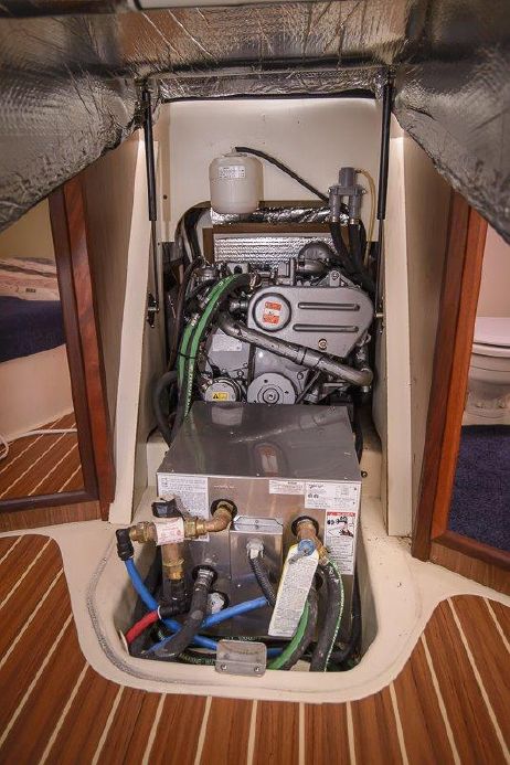

Second question is winterizing the fresh water, I have one of the safety mixing valves on the hot water tank. Normally I would drain the tank and connect the in and out hoses to bypass it for winterizing, I know have three hoses, two cold in, one hot out. The previous owner had the tank full of pink antifreeze with all lines still connected. No big deal, I can do that again but wondered if there was a better way?

The hot water tank is plumbed completely different than anything I have experience with. We would normally drain it and do a bypass by connecting the cold in and hot out, then winterize the fresh water system leaving the tank pretty much empty. This tank has a large brass mixer on the front, there is a cold water into the tank, a hot out that is hard plumbed into the mixer where there is a second cold water into the mixer which supposedly keeps people from getting scalded. It isn't possible to bypass the tank like I have done on our other boats because there are three water lines going to it. In addition, these lines use slip fittings like PEX connectors, not hose barbs and clamps. I didn't understand why the tank was full of antifreeze when we bought the boat, that would normally be a total waste, however, after looking at the way the tank is set up, there may not be a way around that.

The mixing unit on the hot water tank is going away. I worked on it for another half day Friday and left frustrated. There is a small screen about the size of a nickel that catches everything and clogs after less than 30 seconds of the pump running. One of my dock neighbors suspects that the PO used the fizzy chlorinating tabs which leaves a residue in the tank.
In any event, I have ordered the pieces parts needed to pull the mixer off the front of the tank and go back to the old ways with a single cold water in and hot water out. I'm going to drain the tank completely this weekend and connect the cold and hot lines to bypass the tank completely for winterizing.....just like I have done to all of our other boats. I just need to remember that hot water is hot, been doing that for a lot of years so we should be good.

Thanks Peggy, long time no talk. The problem is that you can't follow those instructions with the current setup. See the attached photo. There are THREE lines that come in and out of the tank, you can't disconnect and bypass. Two blue, one red out.
My solution is to remove the mixer...one cold in, one hot out......bypass.
