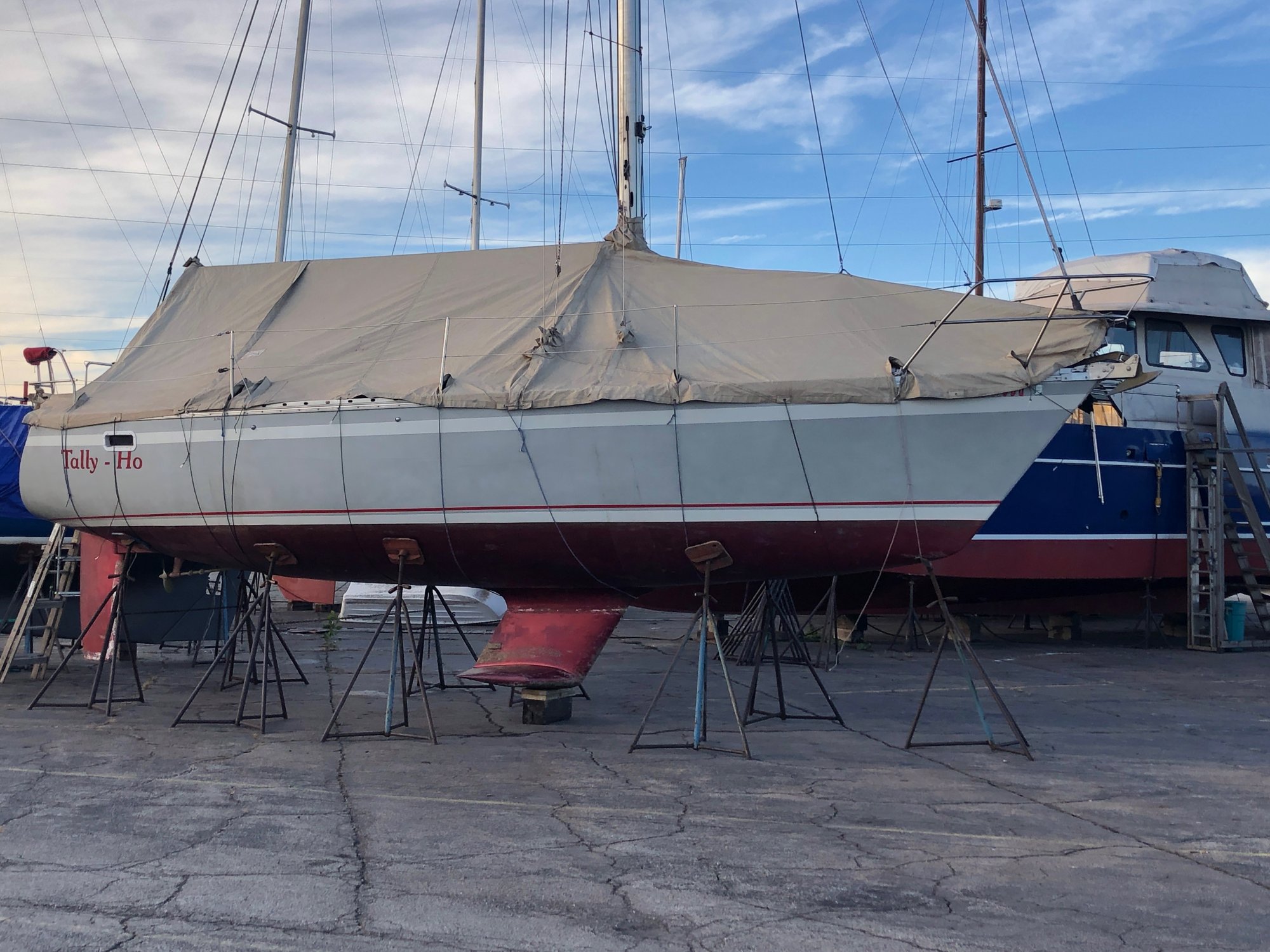

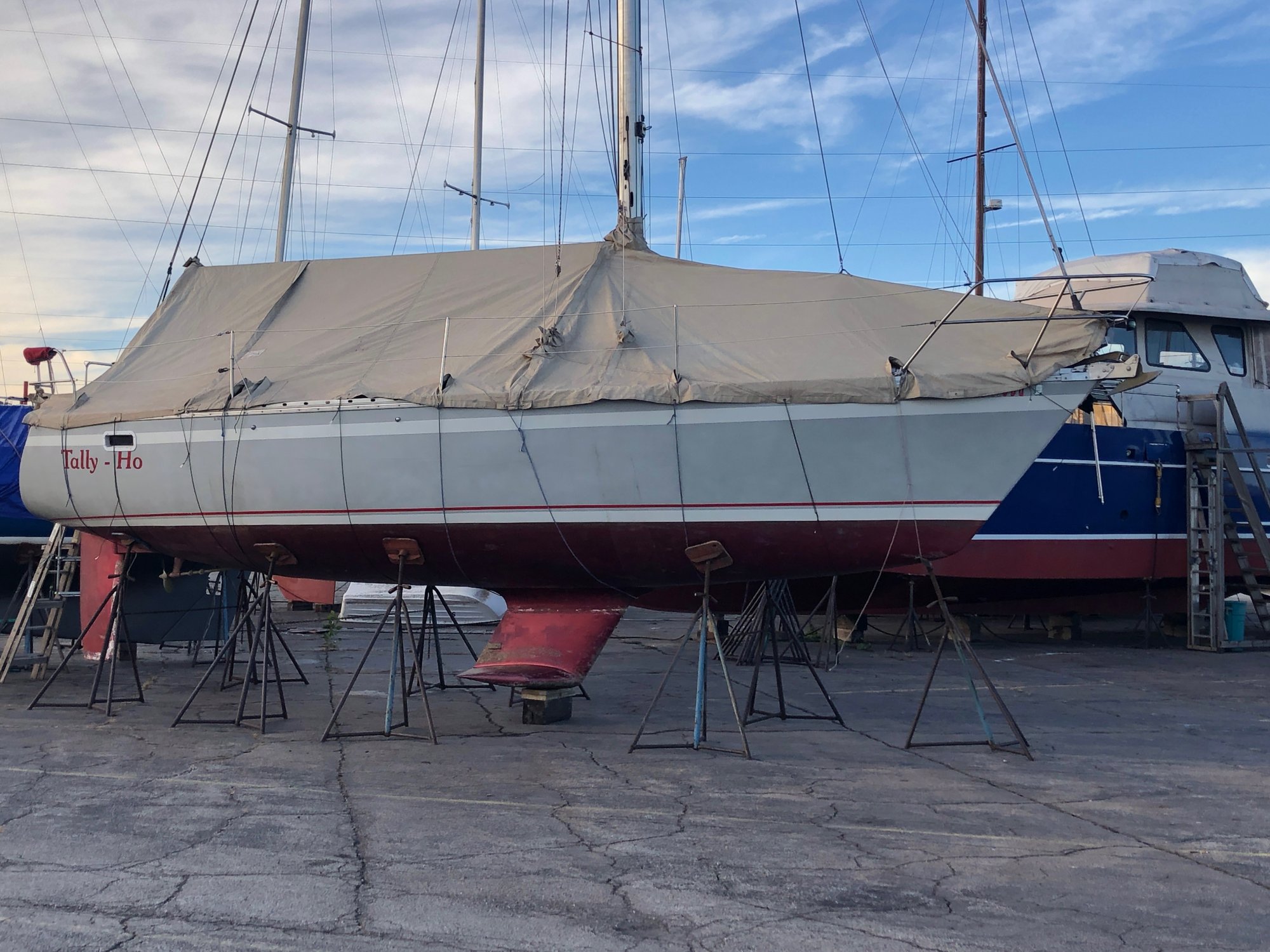

Here's a picture of a stand under the skeg/engine. (just behind the pallet, zoom in)
This isn't a racer with a 1/4" thick glass hull. So it does depend boat to boat where you put stands or cribbing.

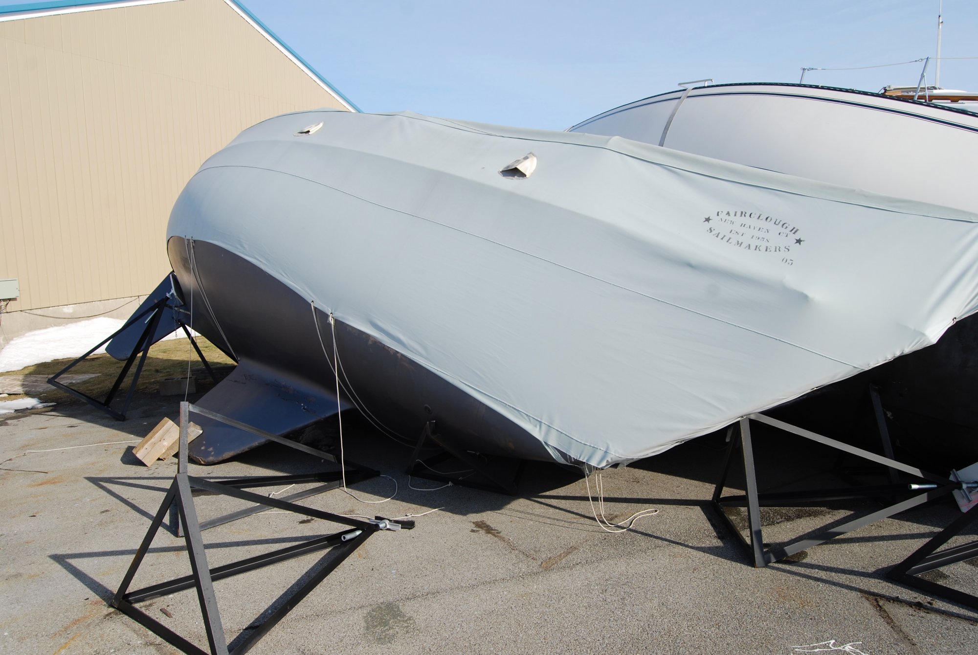

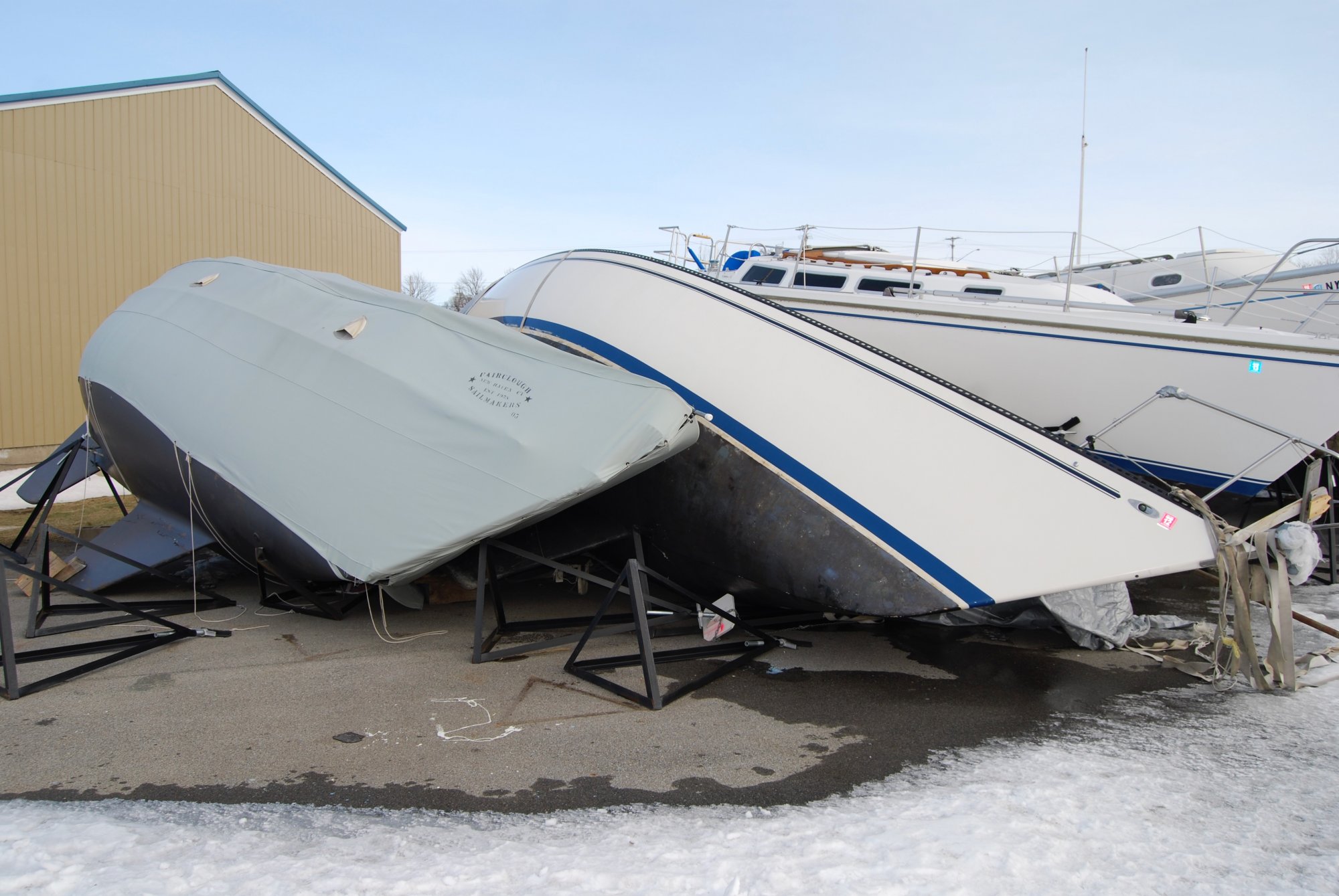

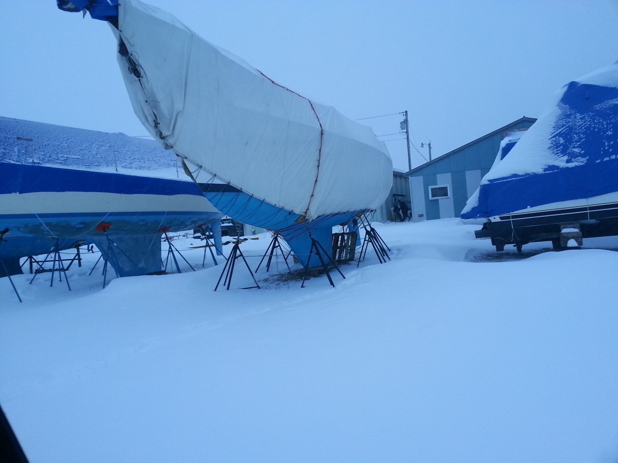

That depends. There are 2 places to chain the jack stands, at the top beneath the pad and in the middle. Hostar stands place them at the top, a poor place. Brownell stands in the middle.
Securing the stands at the top will allow the stands to walk and dance. Eventually one stand works loose and the rest is ugly. In the case below the keel was improperly blocked, wind caused the boat to rock back and forth, a jack stand danced away and....

All the boat's weight should be on the keel. The fore and aft stands simply prevent rocking or tipping fore and aft.

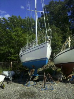

:plus:Being based in Massachusetts, I naturally have always used Brownell stands, and they are the best. The yard I store my boat in is gravel, and is frequently under water, but the Brownells keep the boat upright.1314390619680.jpg

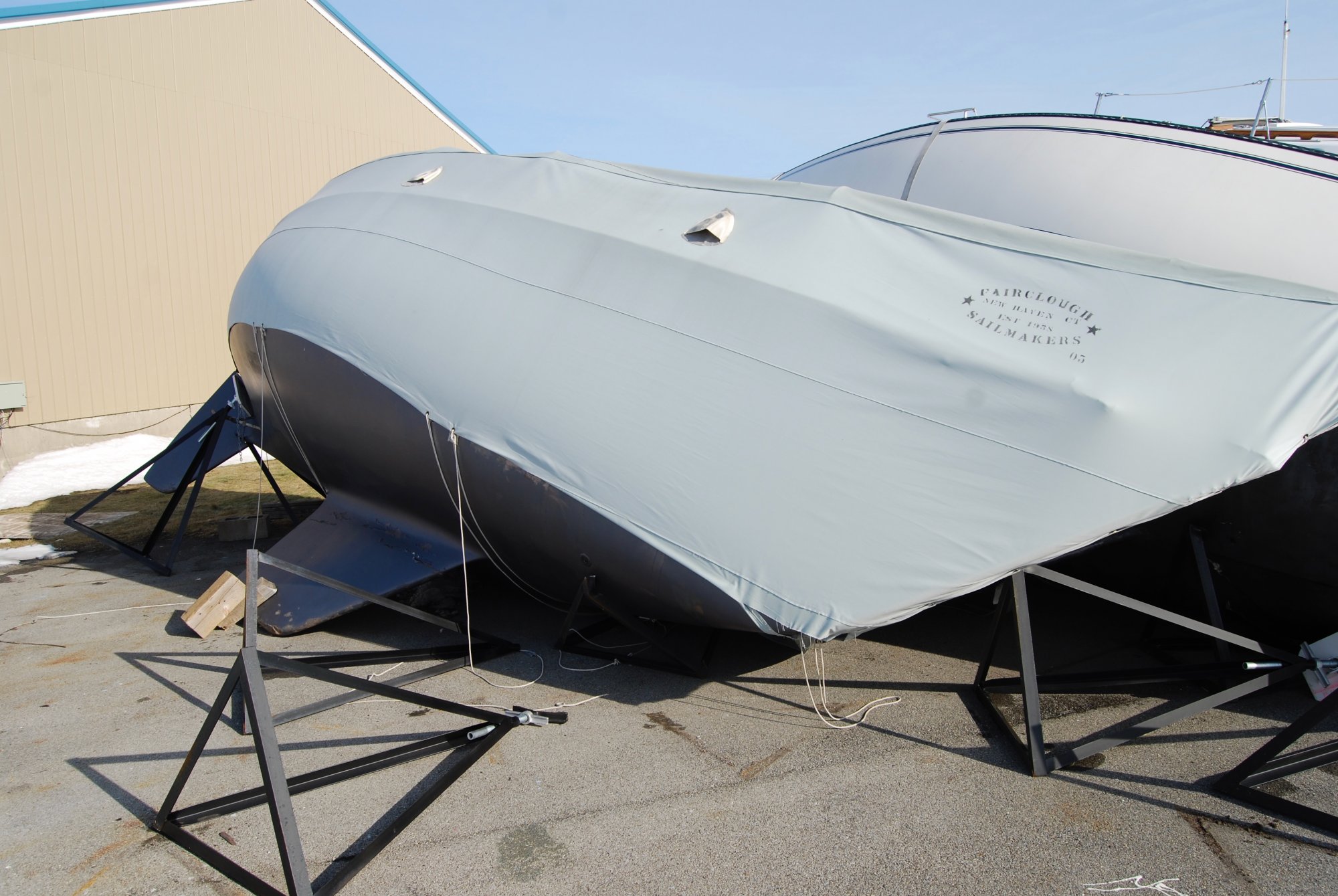

All the boat's weight should be on the keel. The fore and aft stands simply prevent rocking or tipping fore and aft.View attachment 200243
The stands in this picture appear to be home made and don't appear to have any angular cant to them, they also don't appear to have any place to secure a tie chain. The angle iron base is flat which would offer very little resistance to sliding, boat has a nice cover though....
14,177
The stands were made by Hostar and were in their second year of service. They were in good shape before the boat fell on them.
In this case, the boat was not blocked properly, note there is only one set of blocks near the keel. A pretty significant wind storm came in off Lake Ontario, winds were in the 30-40 knot range. The boat was being buffeted by the wind and started rocking fore and aft in doing so the jack stands started to shift. Because the stands were chained at the top, the bases could move, which they did. Eventually one collapsed and the boat toppled over, knocking the next boat to the ground which hit the third boat.
