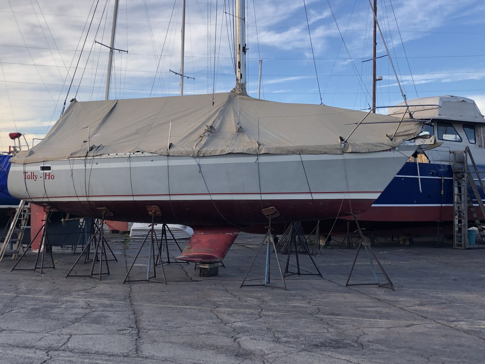

Finding it far too difficult to clean the boat regularly, I ordered a custom made deck tent cover from www.shipshapecanvas.com. I consider this cover the best marine purchase made in my fifty years of boat ownership. Once you cut the tie down lines to length, it would take only 2-3 hours to install or remove the cover. By its third season of use, it had paid for itself, and was still looking like new.
If you are going to keep your boat three of more seasons, its a simple answer.

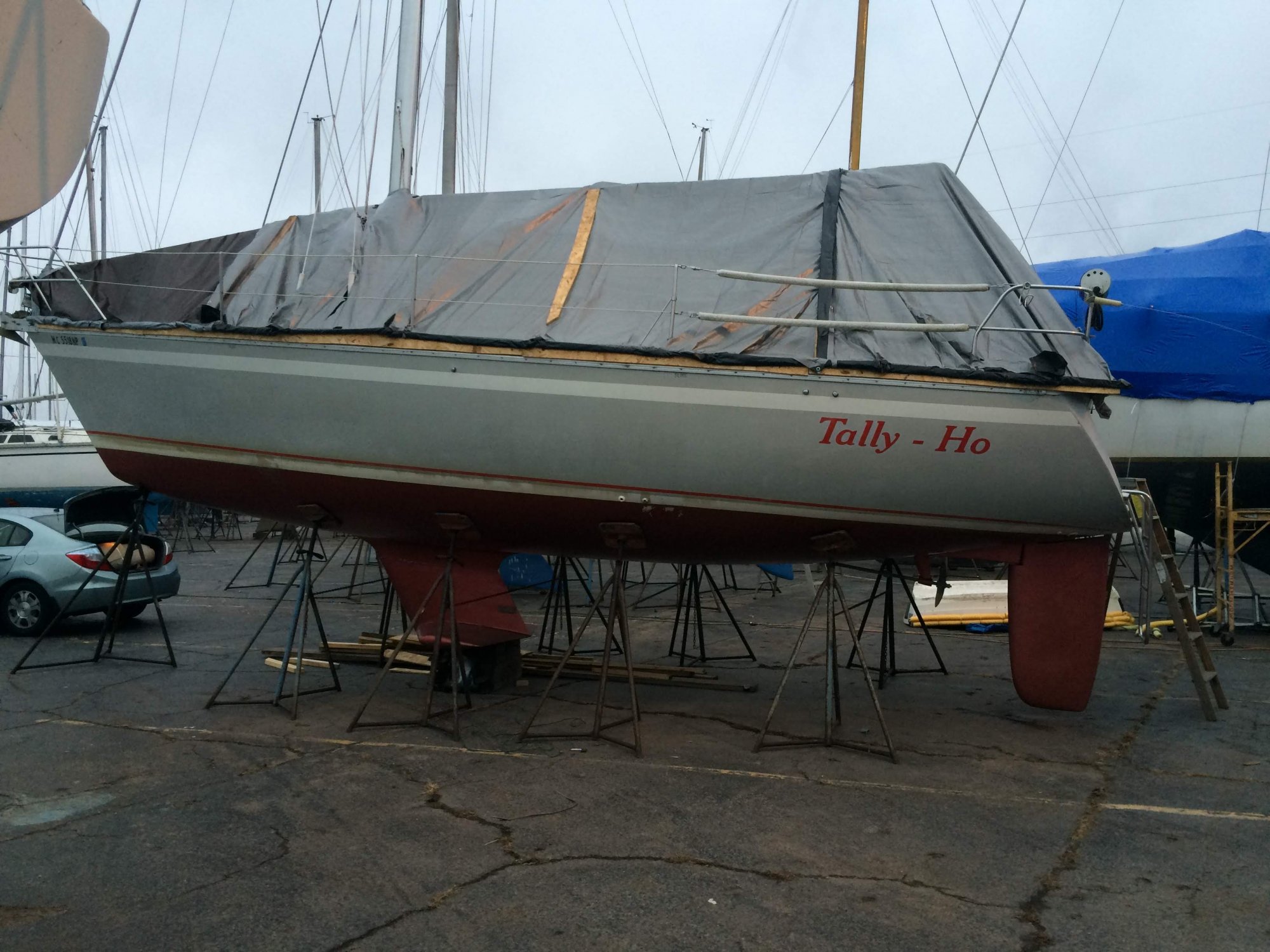

Back in 1993 I did the blue tarp thing on our Catalina 34. Was a nightmare and took most of a day to get it on. Within a month or so it was coming loose. In 1994 due to a medical emergency I was unable to do the boat covering so I started calling for solutions.
I found that shrink wrap was at that time around $800 and was a throw away in the spring. A custom made canvas cover was $1200 and had a 10 to 12 year life. I could working alone put in on in about an hour. The cost math alone was reason to do the custom cover and the ease of installation was a bonus.

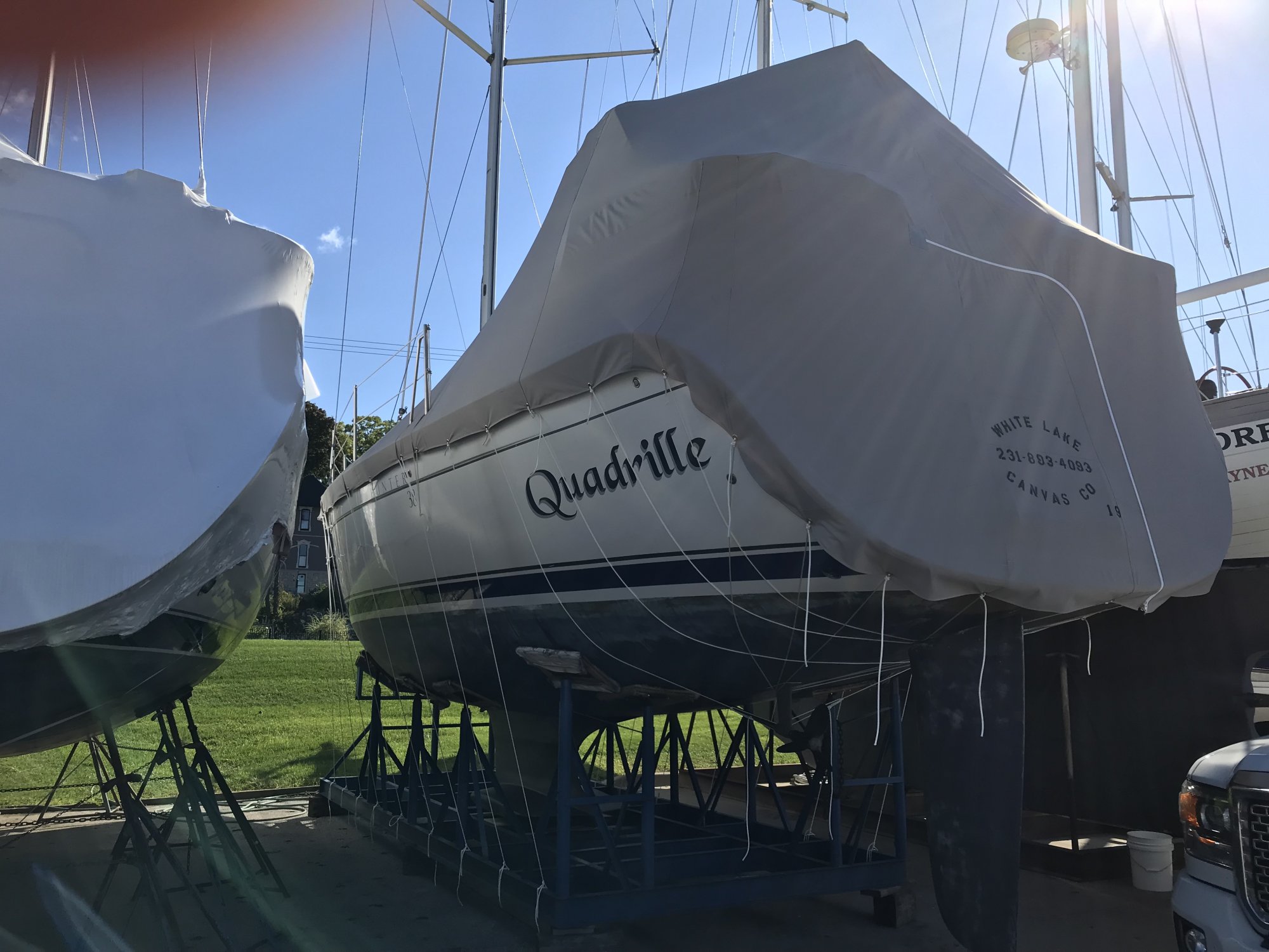

When we purchased our new Hunter 38 in 2009 one of the first things we did was order a custom winter cover. Wouldn't go any other way. There are newer materials that have a somewhat longer life. Now we have a great service too in that the company that makes the cover provides a service where for a modest fee they put cover on in the fall and in the spring they take it off, dry it, inspect and repair if needed then store it for the summer.

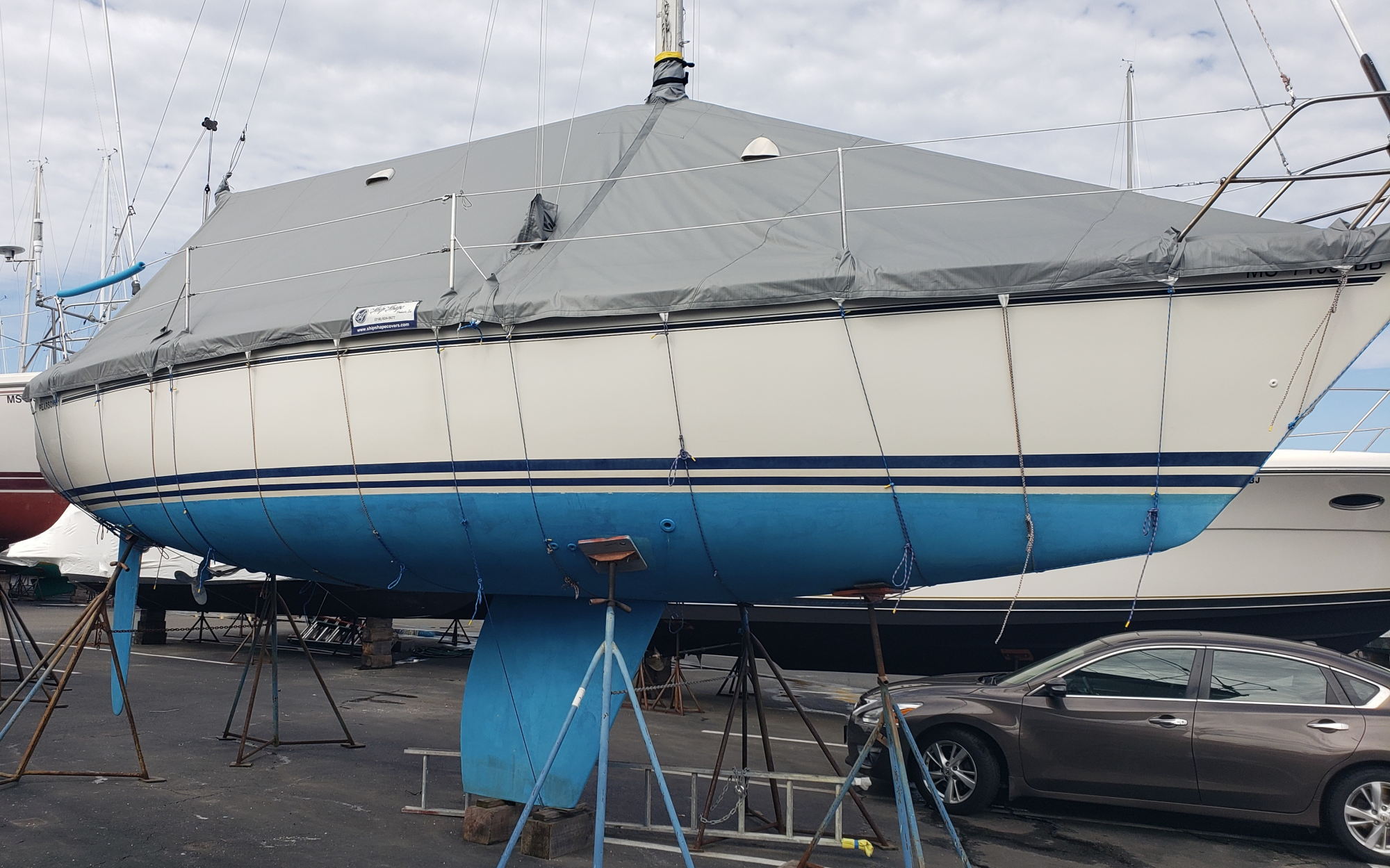

My outside cold storage was a Shipshape custom cover, like @Sailfanatic shows. His is the "deluxe" version with the vertical ties to the shrouds to keep water out (the little tents). I could not afford the $900 shrink-wrap fee annually, and the cover paid for itself in two years. The Shipshape cover only requires a 2 x 6 on the foredeck between bow and mast to provide a peak for the roof. After the first year, assembly takes a single person about 2 hours, mainly tying those hold-downs, and the heaviest part is the 2 x 6 that was about 13 feet long. The first year of any new cover takes about double the time of subsequent years as you need to get everything to fit and cut to size. Other products require you to assemble a frame and then cover it, and that was always a long process for my yard-mates. BTW: Shipshape is a small Minnesota shop, so it may be too late for them to produce a cover for this winter as they are really popular in the Midwest. Lots of advice here on winter storage, and Mainesail has a huge post on winterizing plumbing. My point that most people forget is to push a cut portion of a dish scrunchy in all of your through-hulls to prevent wasps building homes up there.

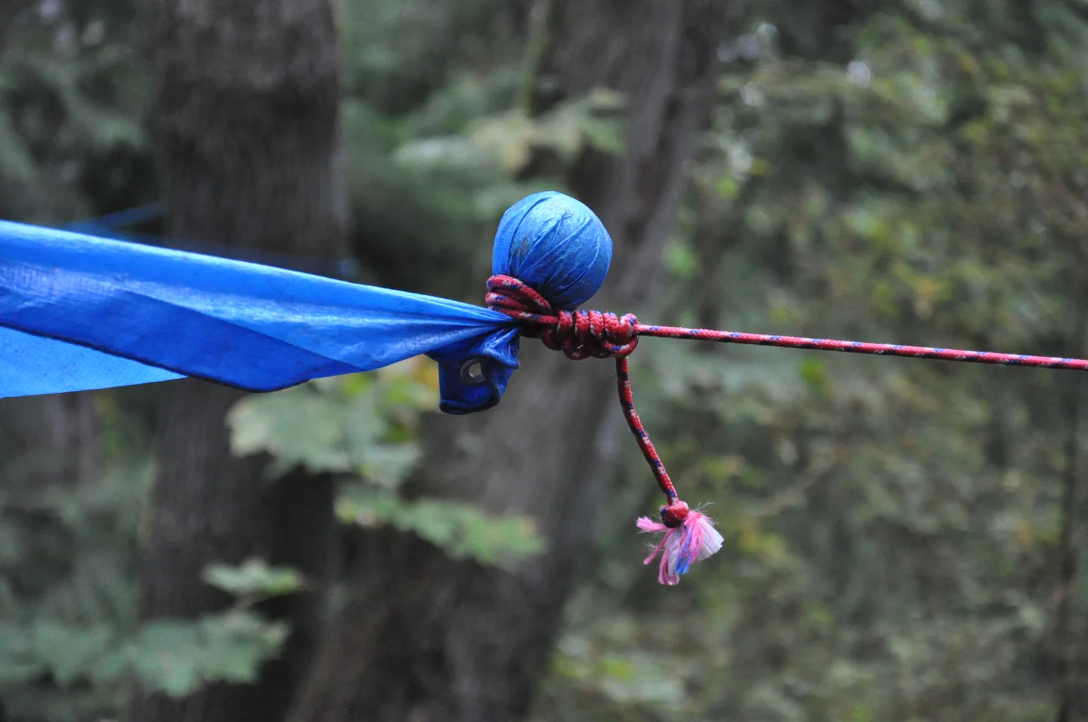

found this a good way to prevent tarp grommets from tearing out......and if you have a dog, a much nicer spring ritual. Bonus, it is also much softer than gallon jugs of ice bouncing against the hull.
