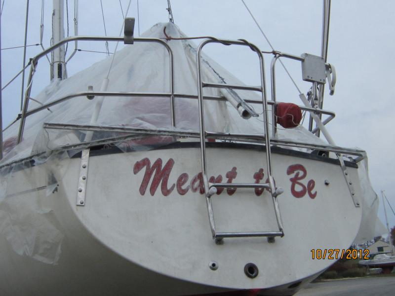

However what caught my attention was the split aft stay attachment method by strapping to the transom. Moves the split stays a bit more aft than I have on my 1980 H36 which instead uses the toe rail about a foot forward of where your transom strapped aft stay is attached. Was this the Hunter original arrangement for the 30? Or a mod by you or a PO?

From looking at several H30's, I have seen both. The split backstays on the transom fastened to a chain plate (as is here on Ian's 79) and one next to me in the yard ( 80 I think ) where it is on the sides, near the rear cleat using something like a U bolt to fasten to.
The reason I have looking is that I am thinking of going from my single backstay to a split and want to know how to do it.

split stay came with the boat when I purchased in 2000
I purchased the Meant to Be in the summer of 2000 and the split stay was on the boat. I believe I am the third or fourth owner. I believe the original owner had the boat set-up to race due to the Kenyon instruments which no longer work and are on my list to remove.

Thanks replies about the split backstay attach method. Always interesting to see the variations that happen on what would normally expected to be identical boats.
