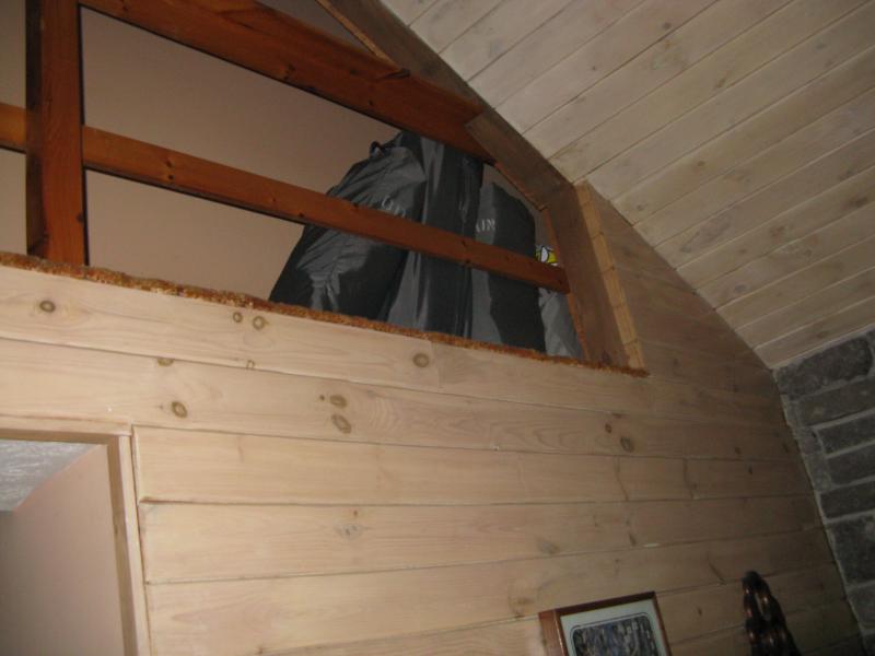

Aug 20, 2010
1,399
Oday 27 Oak Orchard
I wipe any soil with a damp rag, dry, fold, put in bags and store on the sail loft. What the heck, you folks didn't build one into your homes. The cars are on their own, we don't need no stinking garage. :D
