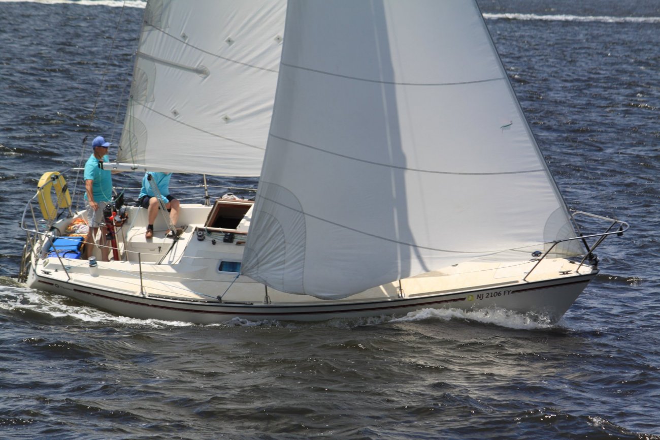

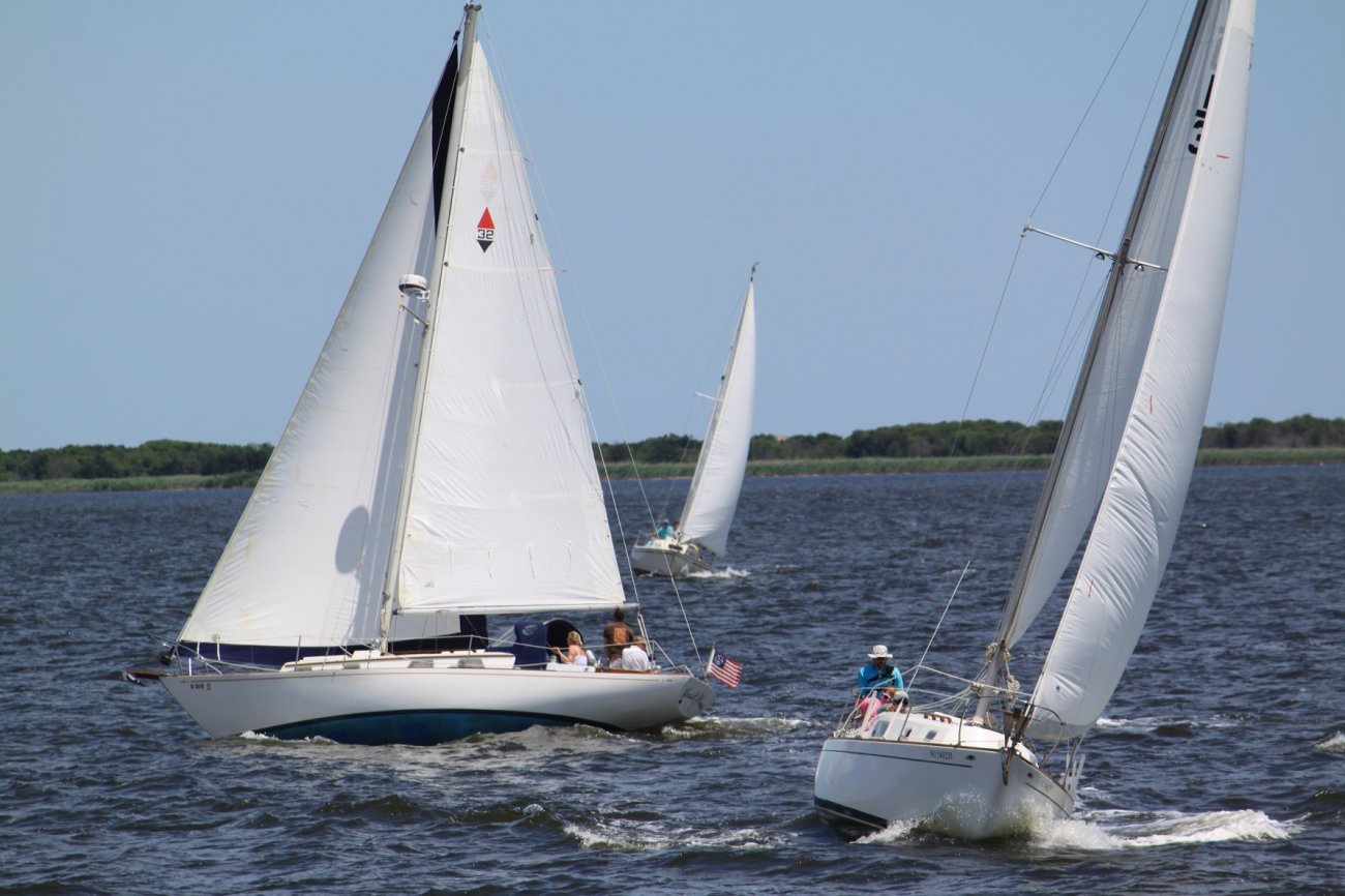

Here's the 3 Amigos … we seem to follow each other around the course. The Morgan is in the lead, the Bristol is crossing under the Morgan and over T-Bird bringing up the rear. This was our race with the poor sail shape, except our genoa was out in these photos.
Here we are looking better!
