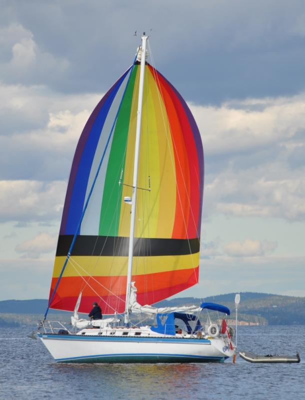

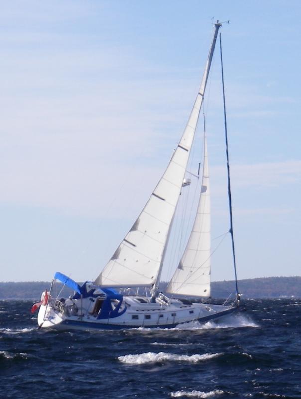

I went through my photos and came up with a couple of the boat sailing under wind vane self steering. As you can see, its not a very intrusive installation. When I'm not using it, I just take the 'sail' and the servo oar off, leaving only a slender stainless steel post on the stern, not unlike what folks use for a radar mount, etc. The tillerpilot resides in the stern locker, whether in use or not. Unfortunately you will still have to wait until spring before I can get detailed shots of the installation.
(I'm solo sailing in both pictures BTW. Its great to be able to go below and make a cup of tea or venture up on the foredeck with the boat tending herself...)

Ah yes, shoulda' known that the TP was connected to the vane. Gettin' old. Cape Horn is a favorite, so simple to attach. Great pictures, really rompin' under staysail.
