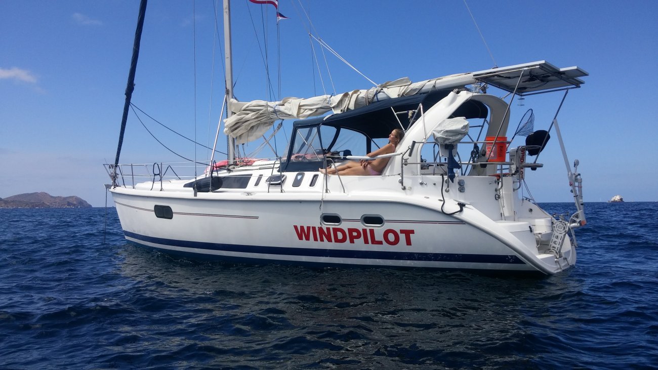

As you can see, if you zoom in, I have a Windpilot Pacific model on my 410. Works great, as any well made servo pendulum should. I worked for the German manufacturer in the late 90's, always liked the name for my boats in case you wondered.
Mounted with 4 bolts on the swimstep, my ladder works and stows just fine.
From my recollection the navik was considered somewhat fragile limiting it to lighter boats to not much over 30ft.
But, that doesn't mean it wouldn't work fine in most conditions, especially if you know the unit & what would stress it. Some self steering is better than none and if I didn't have the extra 1000's to move up I'd make it work.
I guess you'd just need to build a base to mount it then.
