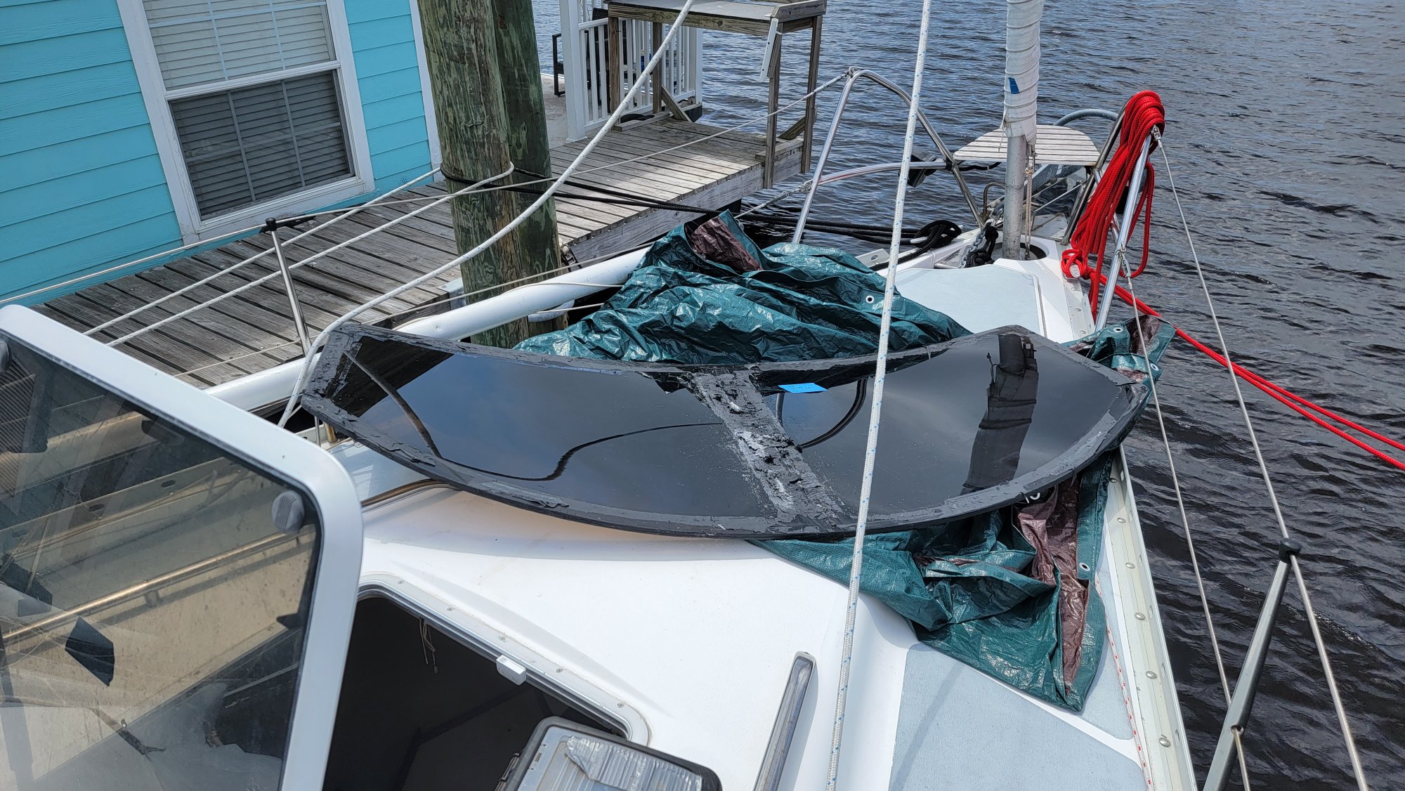

Ralph, managed to remove the windshield without damage. If anyone out there has already gone this route, please share the vendor info.
May 9, 2023
28
Hunter 42 Passage CC CARRABELLE

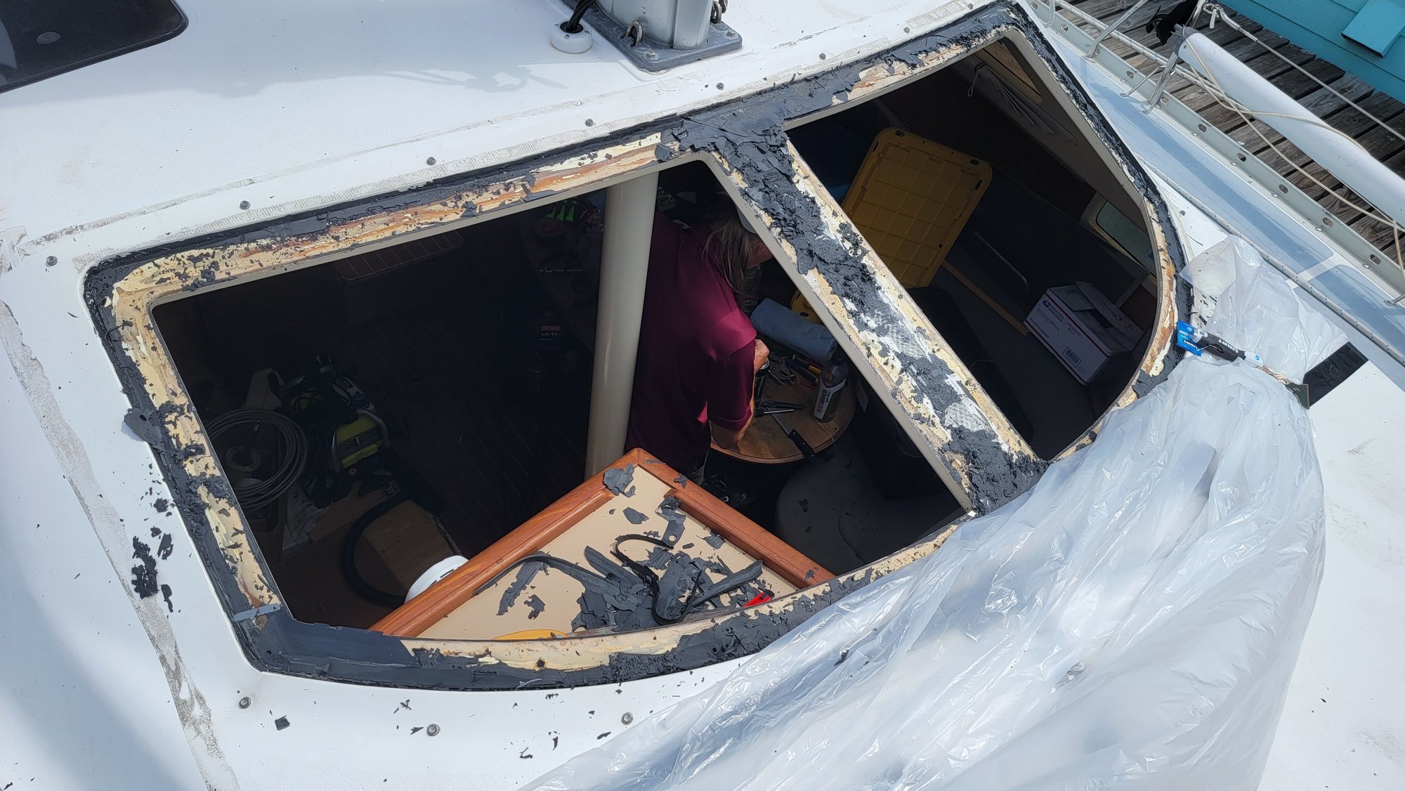

I put a bunch of photos in an album, but don't know how to link it from here.
So here are two photos.
The leak was happening just to port of the top centerline.
Seems a strange place (structurally) to put such a large opening, given proximity of the mast.

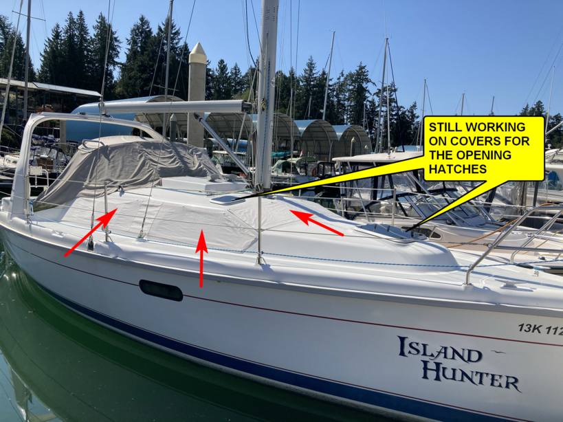

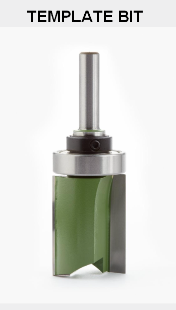

I notice you're tearing right into this and obviously experienced in this kind of work. Any chance you have a hobby woodworking shop ? If so, acrylic is a breeze to work with and using a template bit on removed glass will give you a +/- 0.001" fit as fast as you can run the router and at a fraction of supplied lenses. Well, maybe a little slower. I've already renewed three opening hatch lenses (they were almost opaque) and still making preparations to replace two portlights. Amazingly, the front portlight which you're replacing, still looks like brand new after 24 years. No idea how.
When you're finished, do this and they'll last forever. Wish I'd thought of this when I bought the boat new :

Yes, I am told that a router is my friend in this stuff. However I am not certain it will help with the upper lip of the windshield where it mates to the window frame. There's a 15-20 degree slope here, which extends about 40mm. So I'm trying to find a plastic fabricator who can do the job.

I should have mentioned before if you can pick up a used router, you'll save a fortune if you cut all your windows from stock material rather that going to a fabricator.
All except that front hatchlight. It's just got to be heat formed in order to fit the curvature of the cabin. Maybe even if you could cut it to size and only get it heat formed by a fabricator might save some $$$.
PM me if you need tips on cutting new acrylic windows from an existing pattern of an old window.

Since then I have removed and rebedded the windshield a couple of times. It looks to me from your photos that the windshield is still intact and not broken. You might want to just rebed it and put it at the bottom of your to-do list.
For rebedding the thing what you want is the black Dow Corning 795 sealant. It is now called Dowsil 795, and is the same stuff. You'll need about a case (12 cartridges) to do the whole windshield. It cures with moisture, and takes about a week to fully cure. HOWEVER, if you apply it in sunlight it will go off on you and skin over very rapidly (30 minutes or less), and not give you enough time to work it onto the windshield (or as I do it, work it onto the fiberglass of the boat). So be very careful about doing it on a cool day and out of the direct sunlight. That way you get between 40-50 minutes to work it and set the windshield in place before it skins over too heavily.
