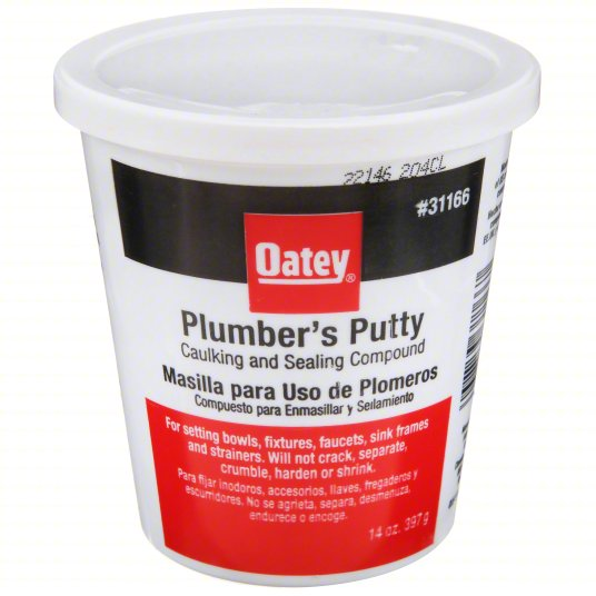

In my 30s, 40s, and early 50s, I would find old and neglected sailboats, fix them up, and flip them. Over the years, I completed numerous small projects and seven major restorations.
One of those boats was an old McGregor 22. I stripped it down to the bare hull, removing all deck hardware, ports, everything...then sanded, repainted it with a two-part finish, and rebuilt it.
To my surprise, when I removed the ports, the “caulk” looked like plumber’s putty and was still pliable after 20+ years. So when I reinstalled the ports, that’s what I used. I sailed that boat for two years up and down the North Carolina Outer Banks without a single drop of water getting inside.
Plumber's putty is an amalgum of ground clay and natural oils. It stays malleable but does not have any adhesive binding properties. Caulk will bind. Caulk will eventually dry and typically needs to be replaced every five-ish years. I have also used butyl tape and I would consider butyl tape to be a step up from plumber's putty and is probably going to last longer than putty. If I were ranking the three...
1) Butyl
2) Putty
3) Caulk
That was probably Dolphinite, a bedding compound that has been around forever.
All plumber's putty I've ever used does dry and go hard. In fact, I have a small tub of the exact one you show that is hard now.
Mark
Mark
Thanks for that info. I had to look up Dolfinite's chemical make up. It is low molecular weight oil and rosin. Rosin is a hardened resin made from the sap of pine trees. Dolfinite is conceptually similar to plumber's putty where the ground clay is replaced with rosin and the fish oil is replaced with petroleum oil. I can see why (chemically) dolfinite would provide a longer shelf life.
