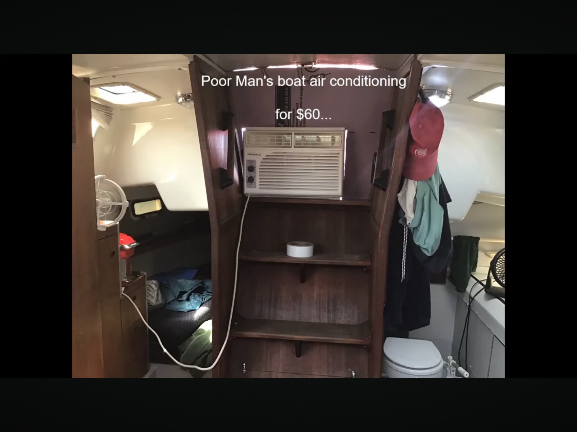

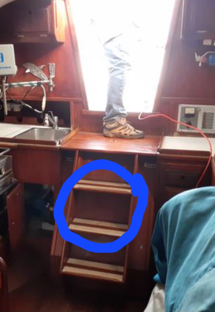

I am completely new at owning a sailboat,, i have a 1977 Columbia 9.6 and looking for some advise. I am wanting to install a window unit in the engine compartment over the engine in the compainionway ladder. I am worried about air flow through the coils, but not sure if the vents for the compartment will be sufficient to allow enough air circulation?>

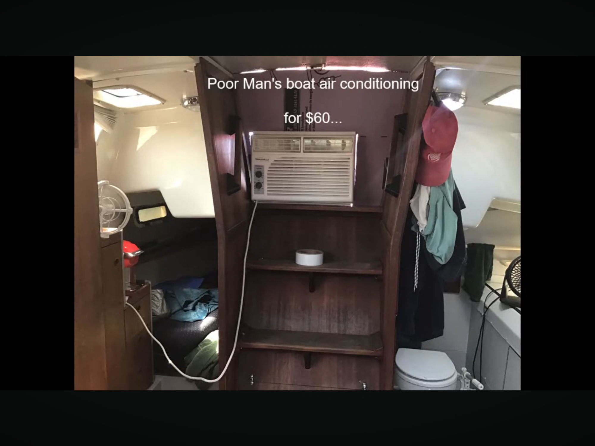

You really need the get the heat out of the boat…so it must exhaust outside.
i put my window AC in the companionway, and blocked off the area around the unit. It is not convenient for getting in and out of the cabin, and iI had to remove it when I wanted to go sailing.
A free-standing AC could work (these use hoses to exhaust the hot air out of the boat). They are not very efficient, but it would offer a little cooling. the unit takes up a lot of space though and needs to be secured when sailing.
A marine AC is the most efficient way to cool a boat, but they are expensive and require a thruhull, water pump, ducting, etc. I struggle to find a good spot to install a marine AC on my 32’ boat.

Yes, this is what I have done so far is. Just put in regular AC in the companionway. But I am trying to find a place to mount on this 32. It just really does not have room to mount anything. And that was going to be really the only option that I had. I know that the engine compartment is vented and with a small fan that I can hook up on the exhaust side to make it pull air out even better. This is what I was thinking but I was not sure and I really don't want to keep in a companion way.Move it every time I take it out to sail

Even if one could provide good exhaust venting, the thought of having an ac unit at the top of the engine compartment all the time would be a show stopper for me. It would make an already tight space nearly impossible to do routine engine maintenance. You might consider one of the RV type ac units over one of your hatches.

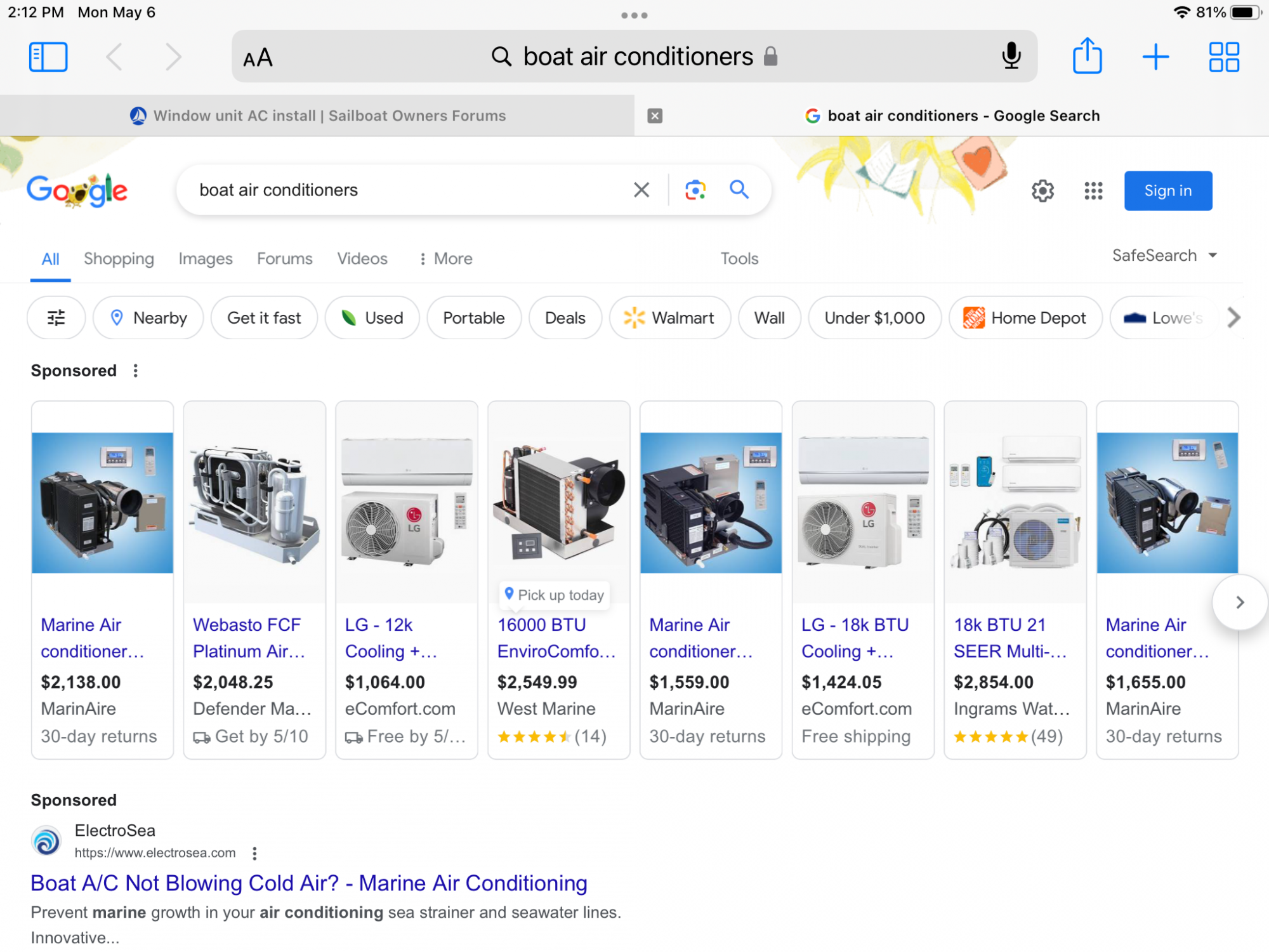

Nobody wants to spend $$$ on a real A/C sysytem for a boat but they do because it’s worth it.

I installed a 10k btu Webasto FCF unit in my C30. Put it in a hanging closet with minimal need for duct work to blow cool or warm air into the cabin. I prepped for it while the boat was out of the water by installing an above water discharge thru hull and a 3/4" intake thru hull/ valve and strainer for the cooling water. It's been in use for 3 seasons.
