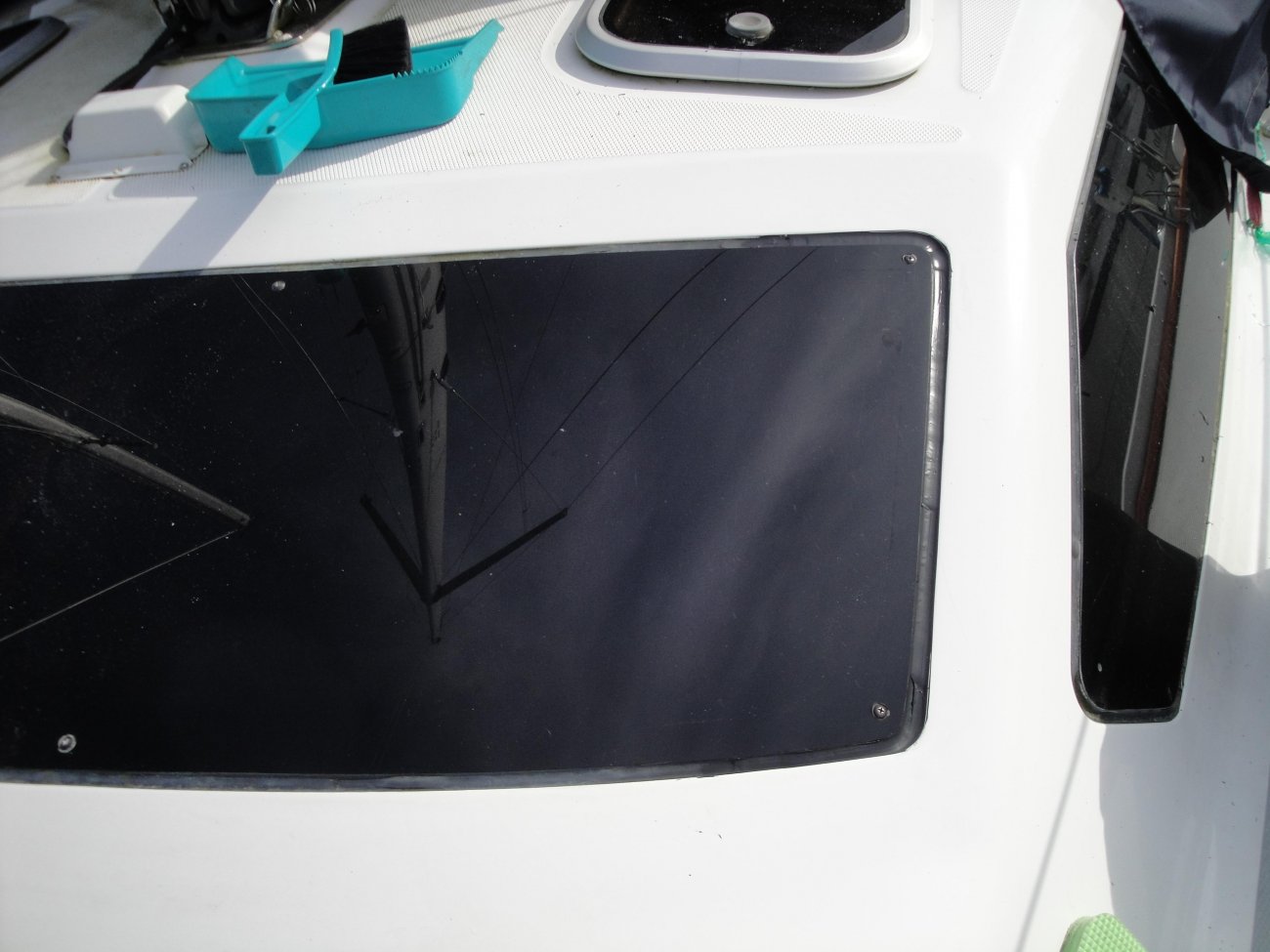

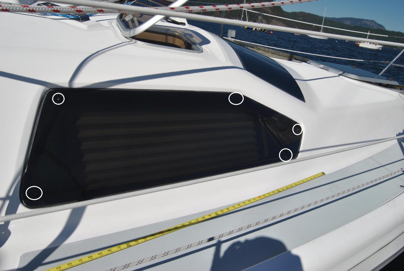

Use @dziedzicmj's idea of the VHB tape or use temporary screws as used in Marlow Hunter production fixed port windows from the factory. After the sealant has set for about a month, the screws are removed and filled with black 795, which is almost invisible. When you look at the width the 795 has to set through, you see why a month is required.
If there is a greater amount of curvature, use permanent black SS screws and they are not noticeable from more than a few feet away. Allow for differential thermal expansion in the holes if the screws are to be permanent.

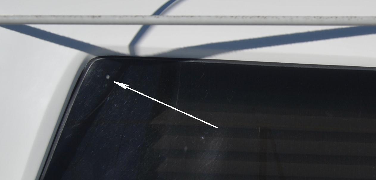

Jan 4, 2006
7,806
Also there is no way I will ever put screws in those windows.
Aw, c'mon :wahwah:!
Even if the holes are nearly invisible after the screws are removed and the small holes filled with black 795 :( ?
Even when it looks this good with your nose pressed up against the glass:(:(:( ?

I replaced all four of ours a number of years ago, and our design does use ss pan head screws around the perimeter. Further, the screw holes are also slightly over-drilled.
