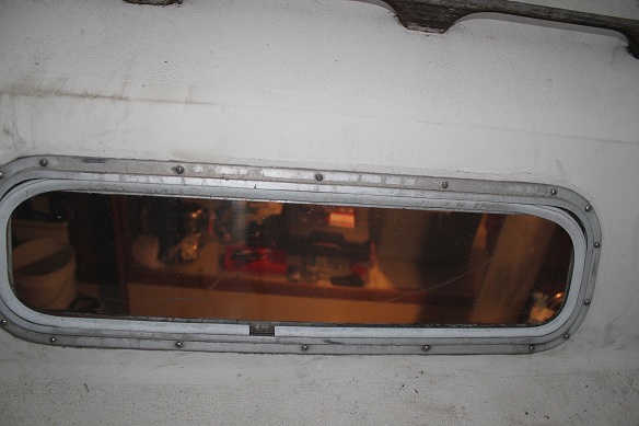

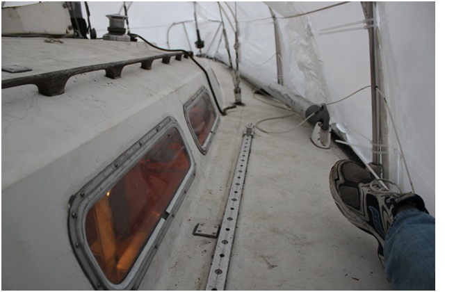

Hello, my 1979 C&C 34 is in need of a window replacement (see pic) and I am considering making some modifications while Im at it. Here are my initial thoughts, I'd appreciate any feedback or insight on this vague plan.
I really like the look of the C&C 34+ windows (see pic), they extend a forward and have a very pleasing style about them. I want to incorporate the same style into my window upgrade, but dont want to change the current structure of the window openings. I was thinking about somehow replacing the factory windows with a standard clear acrylic material (keeping it as low profile as possible) and then overlaying the windows with a darker tinted acrylic that resembles the extended profile and shape of the C&C 34+ windows. This top layer would overlay some of the fiberglass deck and I was considering painting the underside of these areas with a dark paint to prevent seeing white deck.

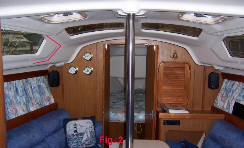

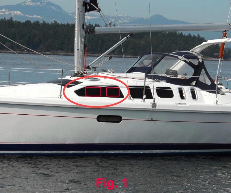

What you describe is exactly what Hunter does with with their window arrangement. Long and sleek looking windows on the outside but rather boxy and broken up on the inside which actually fits the interior cabin shape better. It's also necessary for structural support of the cabin roof.
Fig. 1 shows the exterior of the forward window which is a medium bronze in colour and actually covers two windows. During the daytime, the acrylic looks black from the outside and it's impossible to see the solid divide between the two windows or the fact that the windows are smaller than the acrylic..
Fig. 2 shows the interior of the cabin. Note the bulging outline where the acrylic is sunk into the exterior wall of the cabin. Unfortunately this photo only shows one of the two forward windows which are both covered by the one sheet of acrylic as seen on the outside.
If you are into woodworking to any degree, acrylic is beautiful to work with using table saws, routers, sanders, etc. That way you can cut the acrylic to the exact dimensions you want without trying to make a template first and then have the shop finish it for you. I have been replacing one hatch lens at a time for the last few years and it makes for pleasant winter project.
