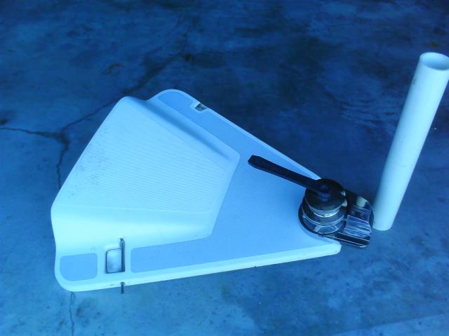

I think this will work, cutting the front of the anchor locker lid off about 8-9" & moving the existing hinge further aft, so the back part of the lid will still operate as usuall, notching the lid & side panels of the locker for a 2"x8" PT
lumber mounting the winch to that along with fiberglass work to make the forward part solid, thu bolting the 2"x8" into the deck in 4 places, glassing it in place also.The existing anchor locker will be for my extra anchor, chain & rode, the winch ( Dolphin 1000) will feed the line down thu a 4" PVC pipe into
the bottom of the hull, forward of the "V" berth & below, the existing hatch under the berth will let me install a 12v battery, bilge pump & heavy screen mat to catch the rode & chain, any water will be pumped overboard, the PVC will protact the fresh water hoses, letting the rode accumalate below, both floor switchs & cockpit switch will control the winch, a limit switch on the anchor roller will stop the "UP" action when the anchor gets up automatic.

The more research I do regarding installation of an anchor windless on my Legend 35.5 the more I conclude that it just may not work properly, despite the fact that others have made this addition. This is due to 1) the size/shape of the anchor locker - a vertical windless requires a fall of about 18", and 2) the off center (to stbd) path of the chain/rode off the bow roller - A horizontal windless requires a centered alignment. I would appreciate any information and suggestions regarding installation as well as recommendations about specific brands and models.
