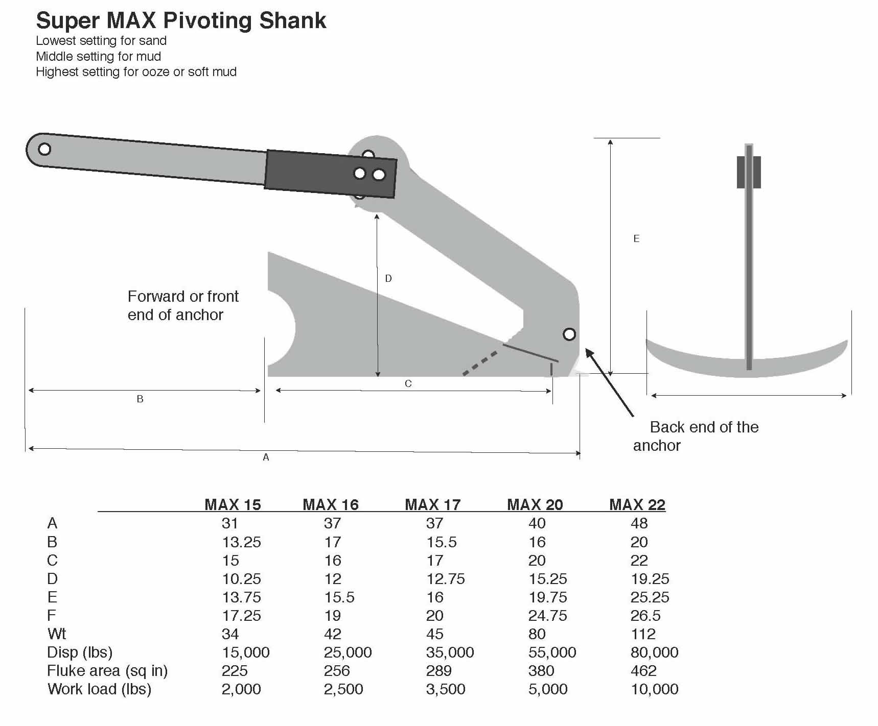

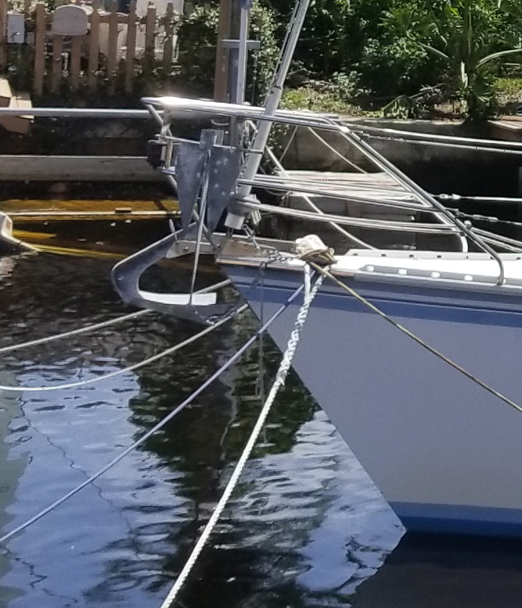

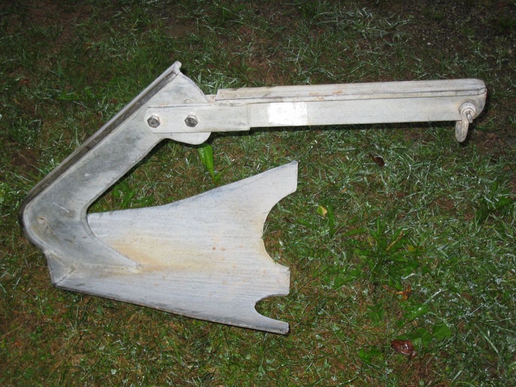

I was using my Danforth backup anchor (See pictures below) exclusively at that time as I felt the primary Supermax Anchor ,that I had never used would be harder to retrieve. After this incident I have returned to past anchorages, and anchored with the Supermax. Not only does it hold much better in our local bottoms (sand or muck), it is also much easier to retrieve.
Anchors.jpg Super-Max.jpg Super-MAX-Pivoting-Shank-Anchor-Specifications.jpg
The Danforth is only for emergencies now..
