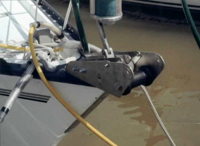

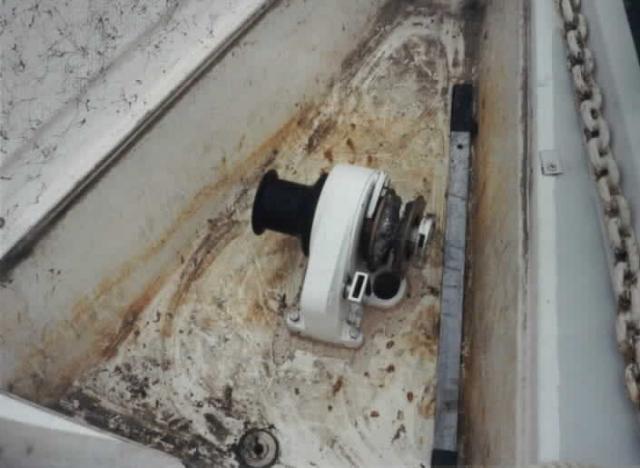

[FONT=Arial, sans-serif]I'm much younger than you Bill, just 69. But my manual windlass has never been a problem with my CQR35. I also have an FX37 that I had to buy for the hurricane holes while down south. I think the solution is more about where the windlass is mounted, where the rode leads, and the bow roller. Pictured are all of my very inexpensive components. The windlass sits on a glassed in piece of 3/8" plywood so water doesn't run down the hawse pipe. I made the bow roller just long enough to get the CQR shackle right next to the sampson post. Then another picture from I cannot remember who.[/FONT]

If memory serves and that's a big IF what Ed has pictures of is a two speed "Tiger" Tigress? In low gear it will take a long time but you can pull the foundation out from under a house.

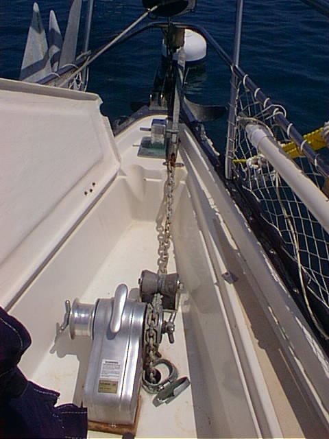

I have a Simpson Lawrence 1500 mounted in the anchor locker with 175' of 3/8 bbb chain rode. I have the original bow rollers and carry a 45 lb plow on the starboard one. The chain feeds over the base of the sampson post and onto the windlass gypsy. I have never had a problem with the chain jumping out, but you might consider a roller to give your chain a better lead, as this owner did: http://hunter.sailboatowners.com/in...&cat_id=38&aid=7004&page=article&mn=37-cutter
I wouldn't consider cruising without my electric anchor windlass and all chain rode - it makes anchoring a pleasure!

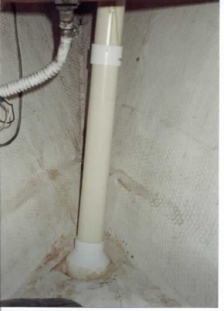

Thanks Jim, I may try something similar to that, but my anchor locker has been modified by a PO to be apparently both deeper and longer. Question, does the chain in in the bilge cause a bad odor? The sea weed? the sand?
Jun 2, 2004
5,802
My 100' chain plus 100' of rope rode has been in the bilge for six or seven years I guess. It has never gone down there dirty. Maybe not real clean either! It is only the last ten or twenty feet that needs cleaned. I use a long handled brush to scrub it as it comes up. I can do about five feet at a time reaching over the pulpit. There was the time when the mud was so thick that I just dragged it on deck to scrub the last ten feet. Not a problem with the 35# but 45# might be a different matter. Anyway never any odors.
