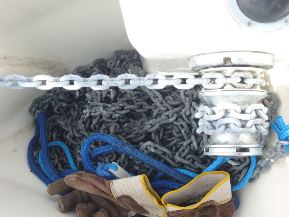

This is what I have with my 200’ of chain...Is this not what most 310’s came equipped?
Standard equipment was the rotating capstan with no gypsy. We use that by wrapping the chain twice around the capstan and pulling up. It helps a little and gives a better angle for chain so you don't whack the furler.
Does this actually work for you? I have heard a number of issues with jumping the chain out of the gypsy with this setup?

I was always taught that the proper technique was to pay out the chain rode to prevent castling and chain jamming when using the windlass for the anchor haul up. I even have a metal rod inside the anchor locker to help. Failure to use the technique definitely leads to a pileup and inevitable jam (which I can attest to trying once, out of curiosity). Certainly easier than relocating the unit.
Perhaps I don't know better but yes the system works for me. Note that the drop is done manually with the gloves. Funny that the windlass doesn't run in both directions...or did I miss something?
I have never had the chain jump out of the gypsy as the weight of the rode naturally falls into the gypsy as per the photo. I suppose it could happen if one didn't give due attention to the chain castling.
If you are manually deploying the anchor you shouldn't have the issue. It is from deploying the anchor with the windlass.
