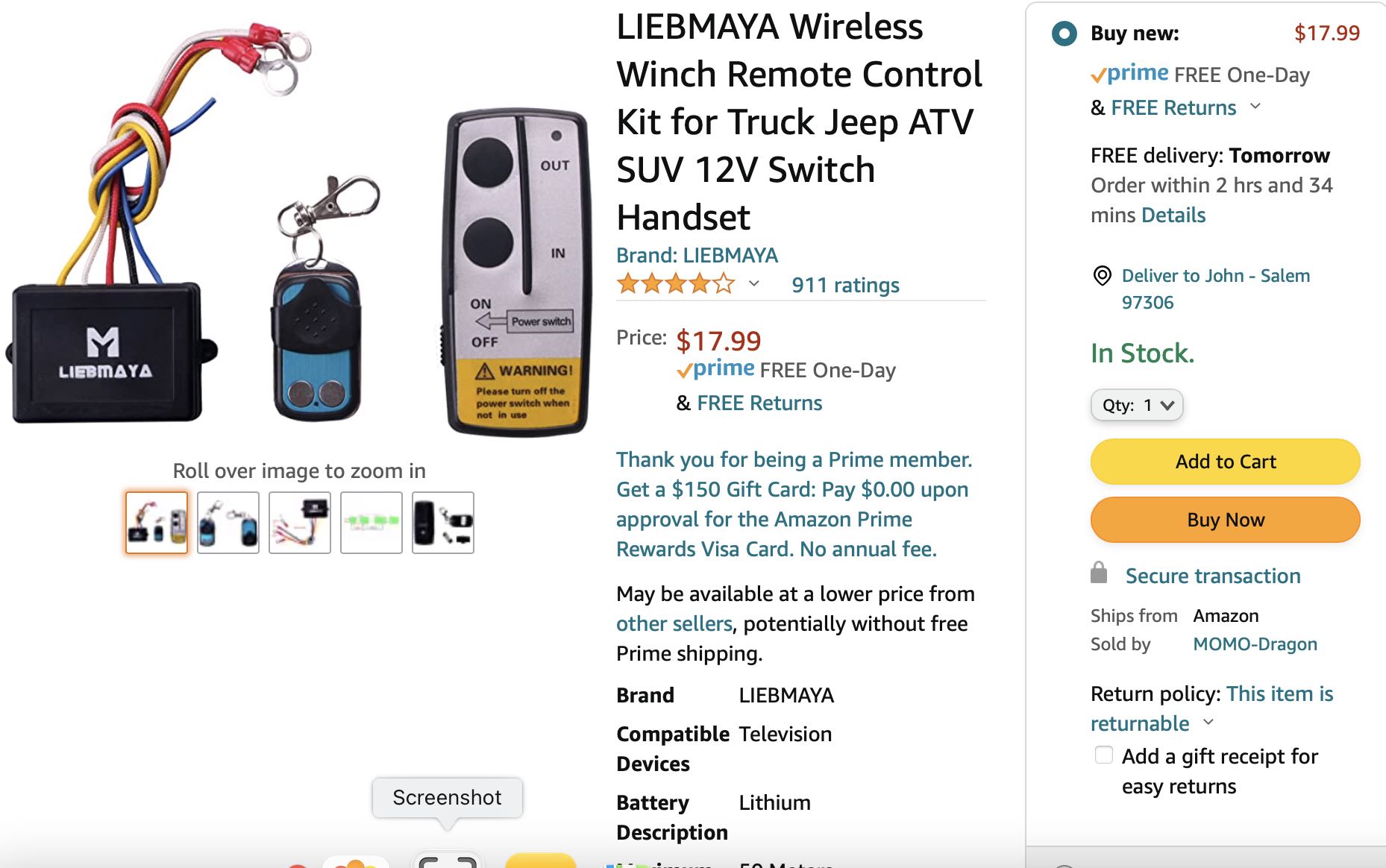

I have used the winch remote for years. They cost about $17. You can now buy them on Amazon. Easy to wire in. Only problem I have found you have to replace them every couple of years. I also installed one on my power winch.

I bought this Remote control and attached it to the controller of my windlass. Has worked fine since 2018.
I am sure there are more out there that work the same.
If the buttons work wrong, just reverse the leads to get up when you push the up button.
When it eventually rusts out, I 'll just scrap this one and purchase another

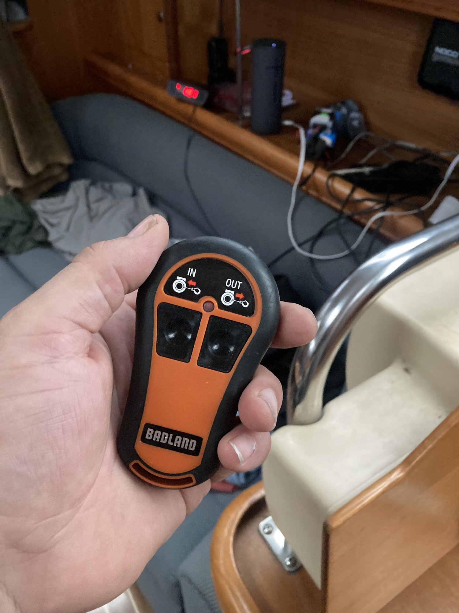

Finally got around to it. Used this cheapo from Harbor Freight. If anyone uses this on a H41DS/Lewmar windlass, just remember the blue & brown are reversed. So put the remote brown to Lewmar blue etc. Black goes to Lewmar’s yellow ground. Line voltage is yellow/grn.
